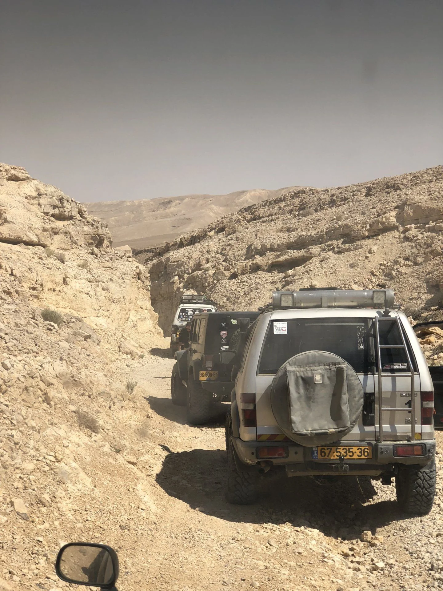

I arrived to the meeting point
my frends went to a natural pool filed by flash floods we had this year
i waited near the rigs and 2 new Israeli made Storm 4 jeeps arrived

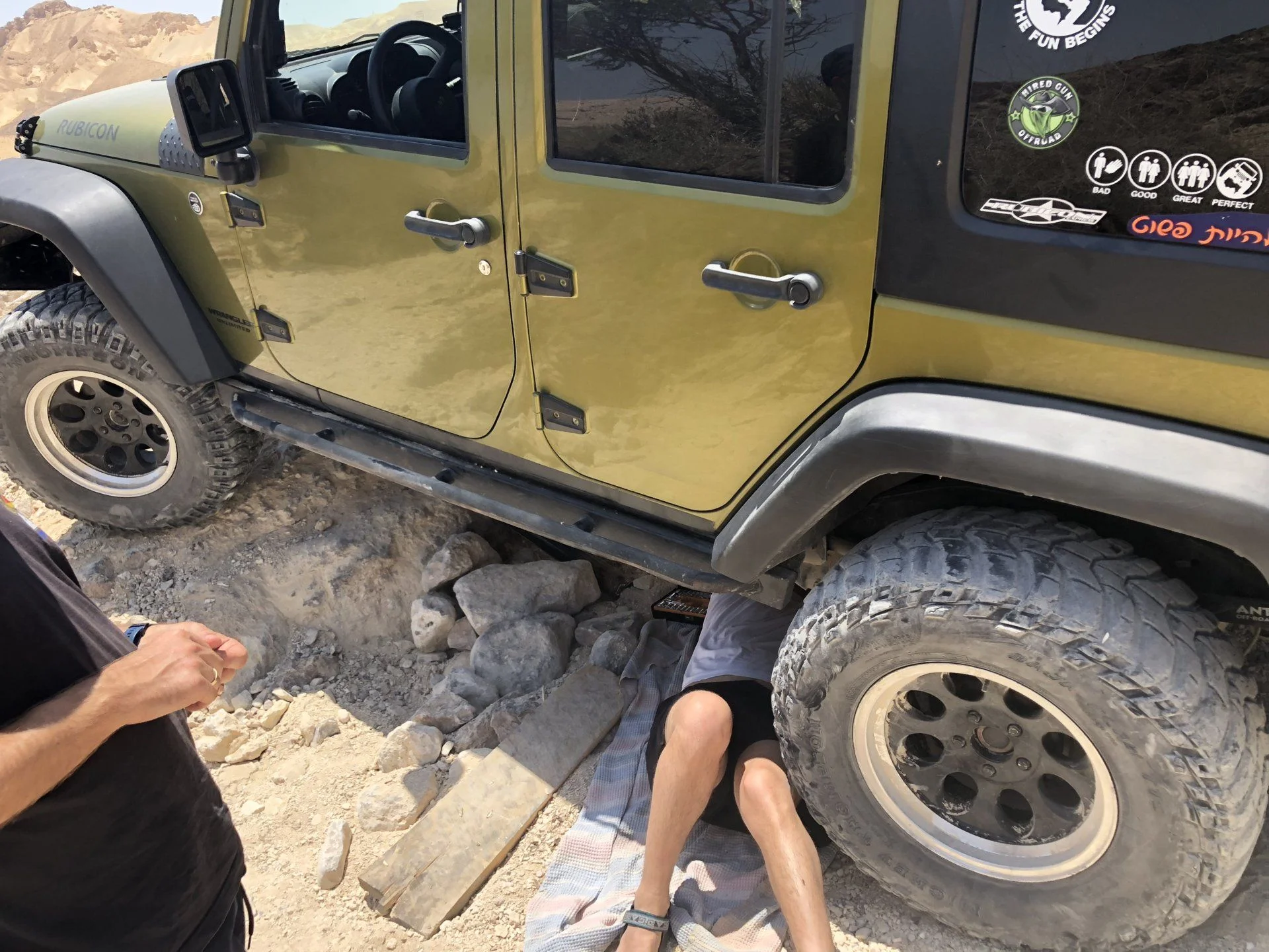

as we drove into the desert one Rubicon split rear drive shaft
we removed it and he drove lame duch 2FX4

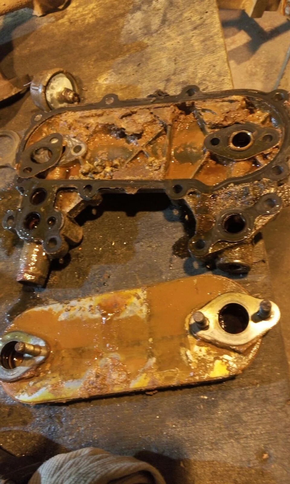

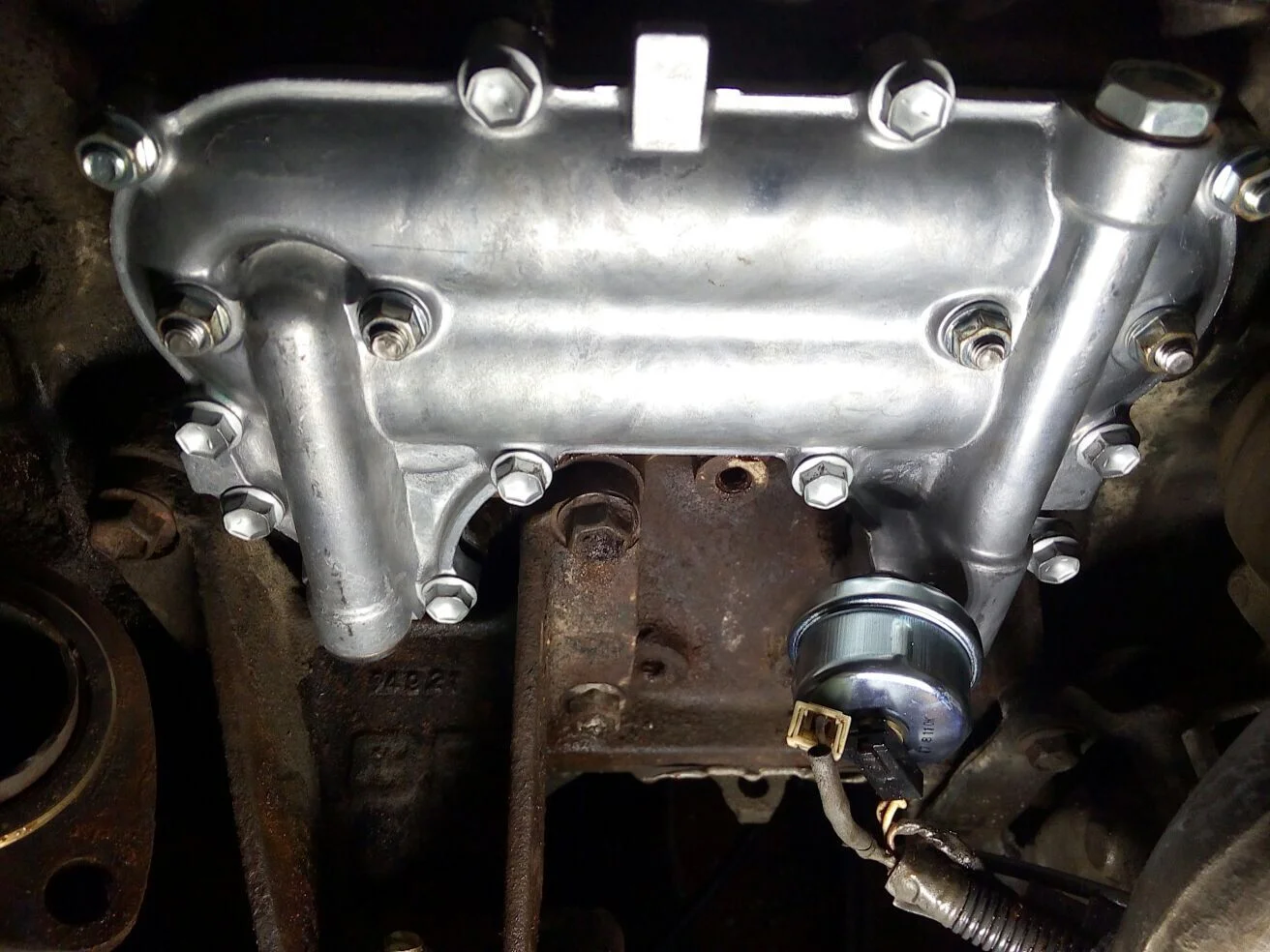

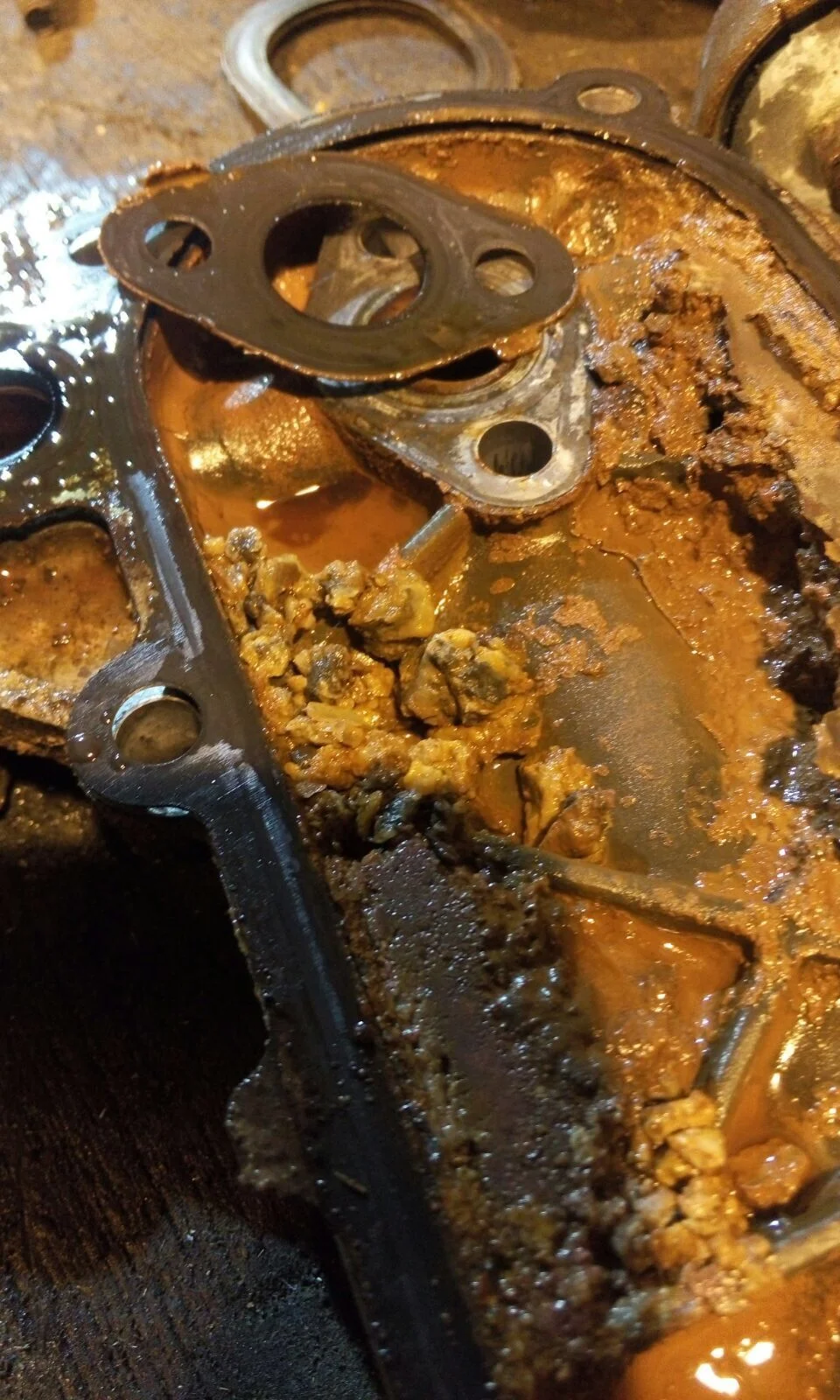

The last issue is PO used tap water on top of that he had a PHH problem so he add tap water every day, after that he stopped using the rig and did not drive it for 3 years. Until I bought it, it was a miracle it started and worked perfectly all it needed was a new battery. When I opened the oil cooler I found a disgusting disaster see pics
Should I flash the engine?
I use the services of one of the best off-road shops in Israel and they are against this...
