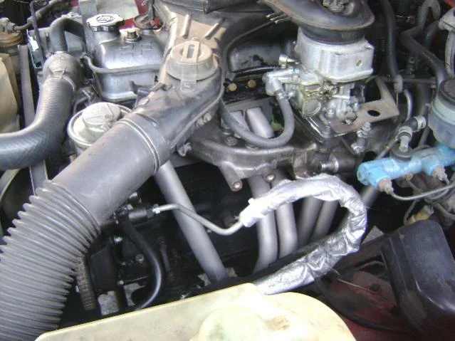

heres an ealier set up with the two pc adpters and oem cleaner....with the oem spacer.
and the current setup with one pc adpter and parts house ten inch cleaner.
Is the pc (what is pc?) adapter used to put a 10" on the oem aisin carb?
pc = piece
I don't know of any adapters that you can buy to put an open element on the AISIN carburetor, I bet you could make one though.
The two piece adapter is used between the Weber and the stock insulator along with the weber to OE air cleaner adapter to get the right height.
