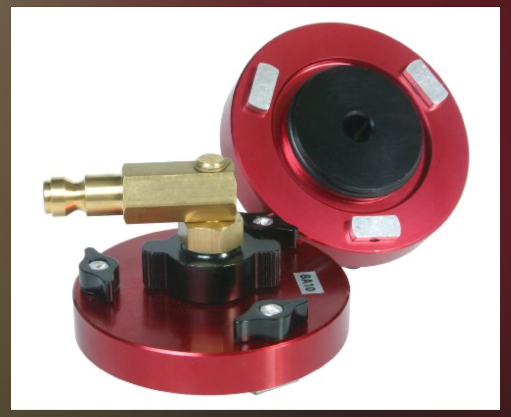

I used to a Motiv power bleeder/flush on mine. Simple one person flush job
Expensive cap but it works.. I paid around $46 for it back in 2019.
Did you need to add much fluid, or just bleeding and replacing spent fluid worked?
