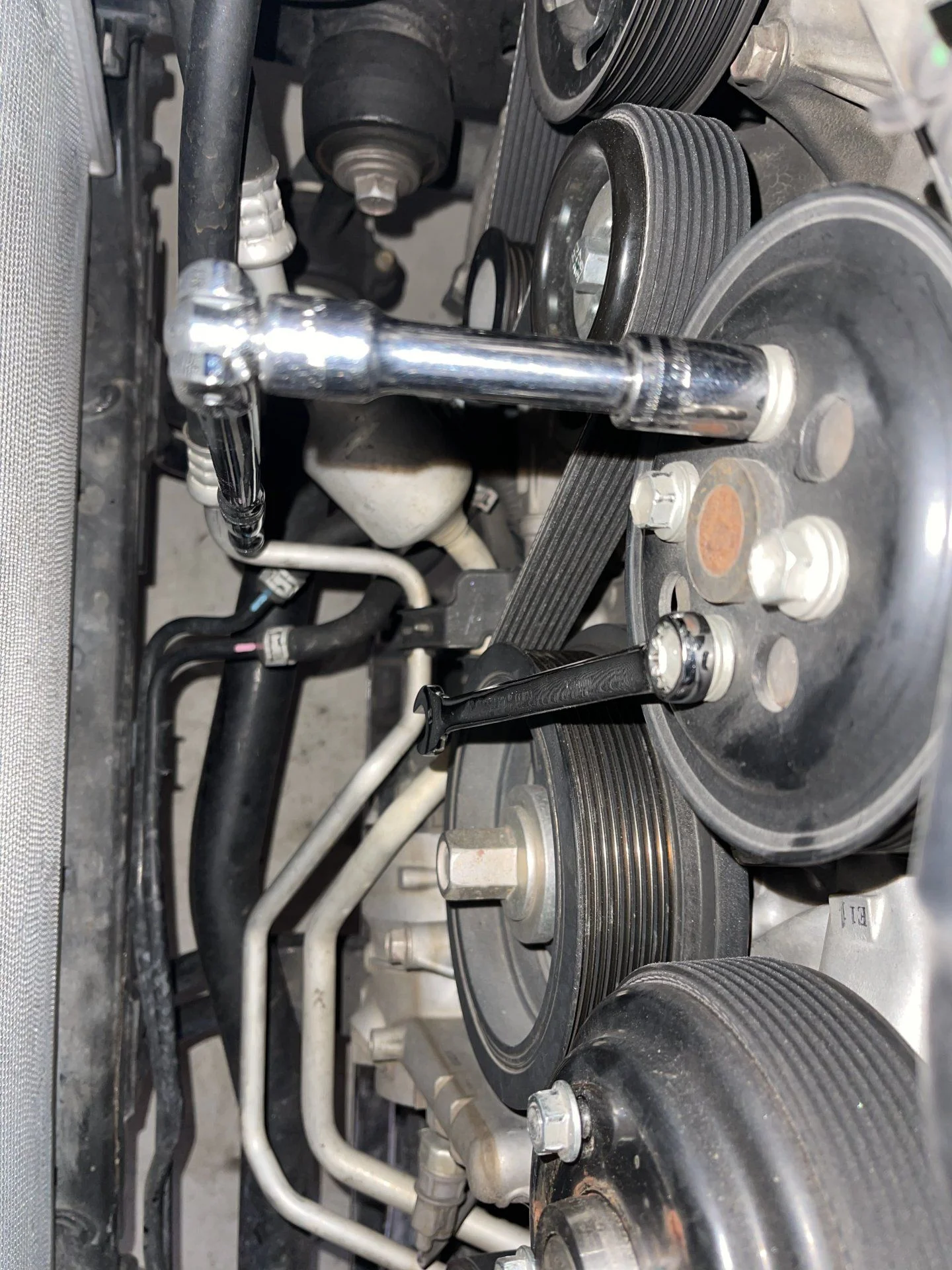

1. Unscrew fan from its pulley -> I Wedged a screw driver as shown in the video to keep the pulley from spinning and removed the fan
2. Remove the fan shroud, its going to be tight, but it can be done without removing the top and bottom radiator hoses.
3. Remove Waterpump Pulley, I used a wrench to keep the pulley from moving, and a ratchet to remove the screw

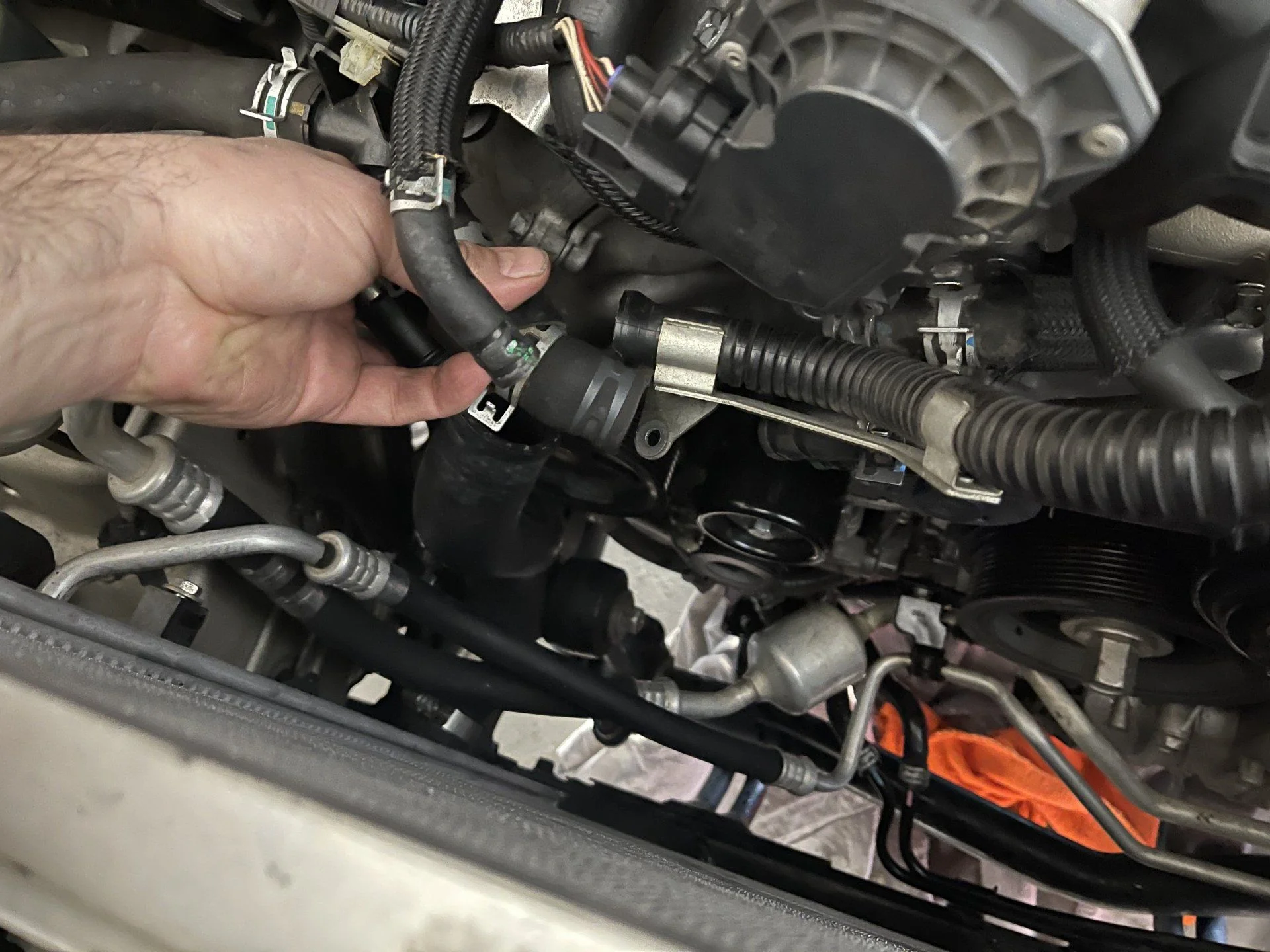

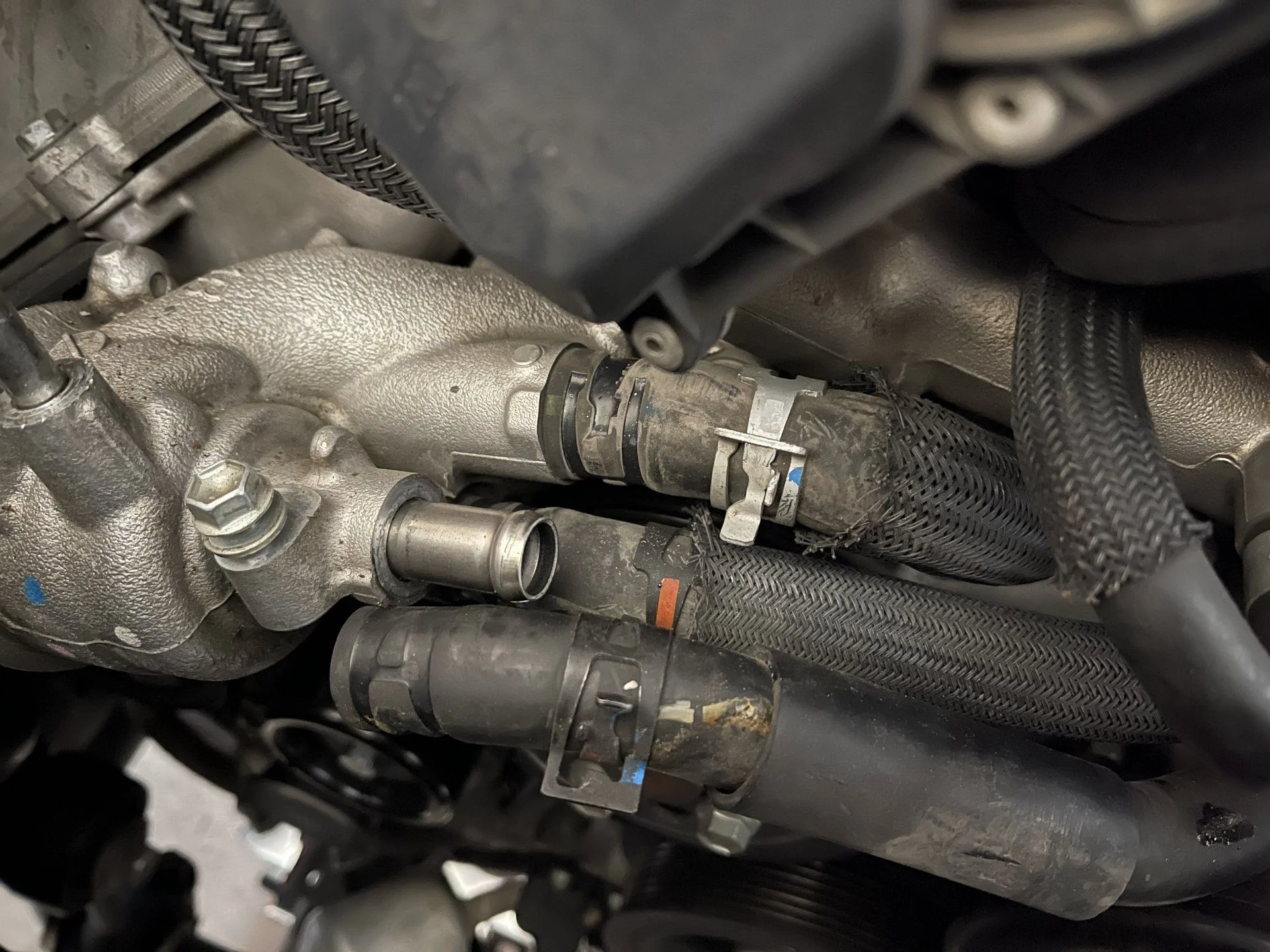

8. Remove the 3 coolant lines on the thermostat manifold (mine had marks on the clamps, 2 blue, 1 red)

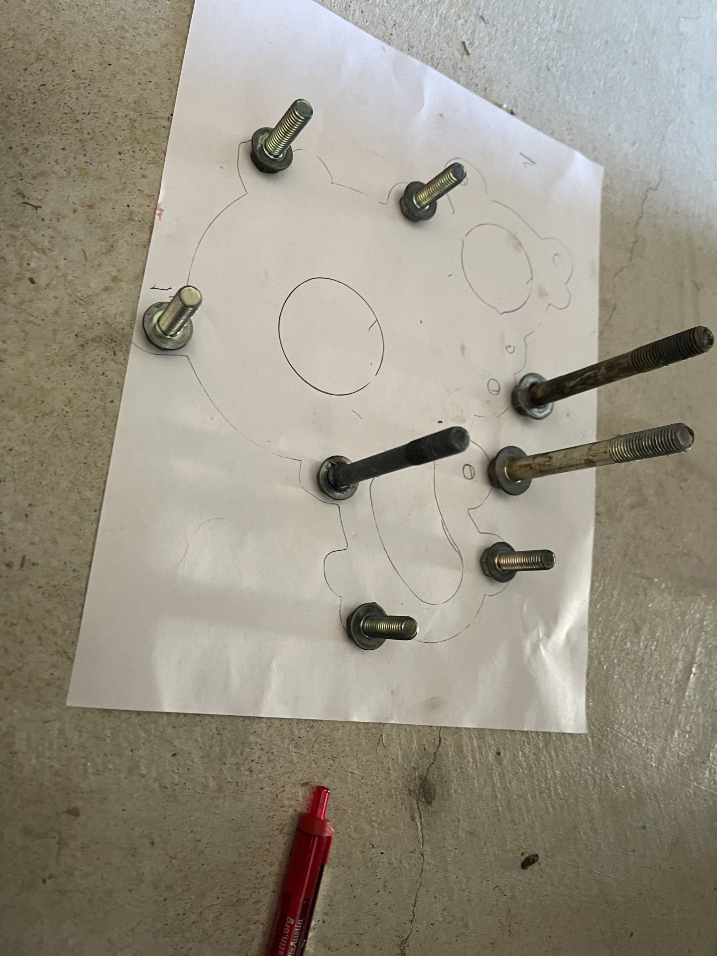

10. Remove the waterpump as shown, there screws are of different lengths / sizes etc. I used the gasket of the new manifold to draw out all the screw holes, and placed the screws on them as they were removed.

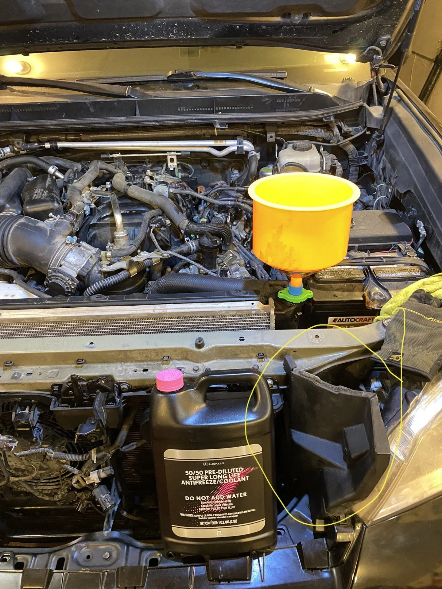

16. Coolant refill & Air bleed -> Use special funnel mentioned above, attach it to the inlet of the thermostat and fill. Once the radiator is full, leave funnel attached with extra coolant (vehicle off) and you will see air bubbles purging from the system. I let this process occur for about 30minutes. After 30 minutes, I left the funnel attached with coolant in there and turned on the car, let it idle for about 30 minutes and kept adding coolant as needed. **CAUTION** Wait until vehicle is COOL to remove funnel / re-install radiator cap.

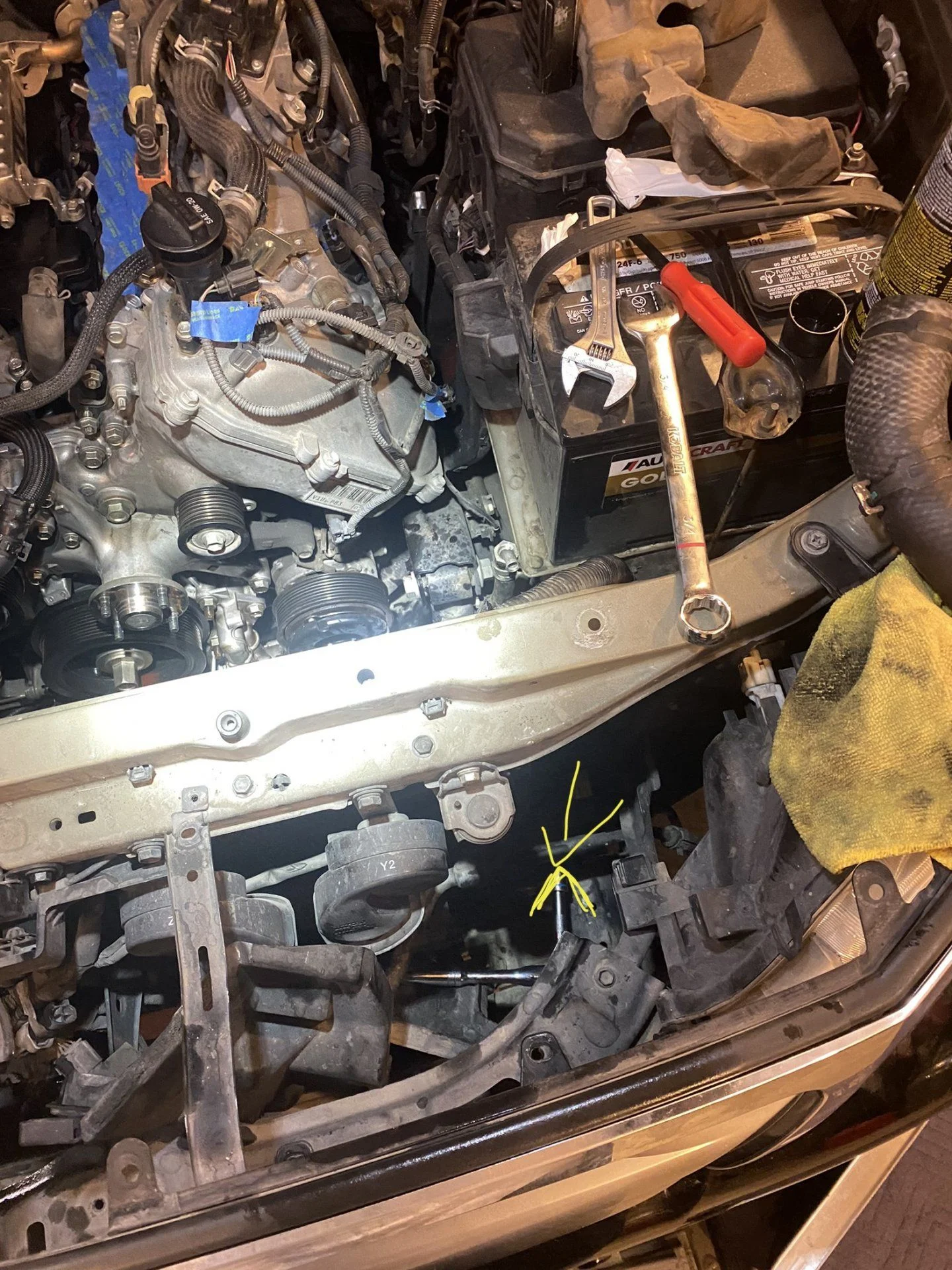

Fan Removal Technique:
Waterpump Pulley Removal Technique:
Water Pump Screws and their order as removed:
Coolant Lines behind the Water Inlet Manifold

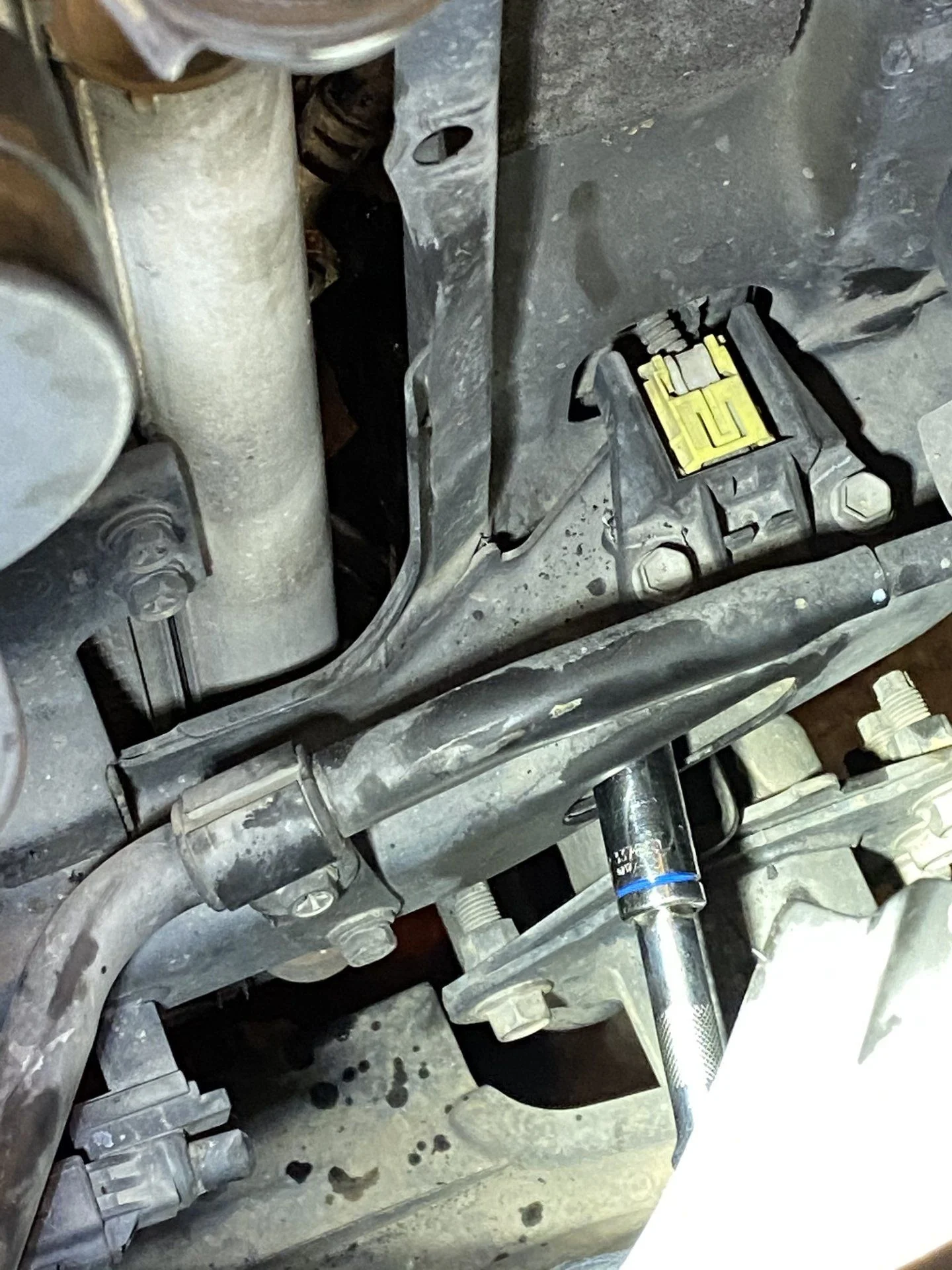

If you eventually need to do the radiator replacement, just know it can be done without removing the bumper. It’s tight and there’s some air damn pieces that’ll make your life suck, but it’s not horrible overall.
You have to remove these air directing pieces and they’re so damn shoved in there it’s a frustrating task.
This is the bolt they want you to remove the bumper to get to, which happens to live behind where those air director pieces slide into.

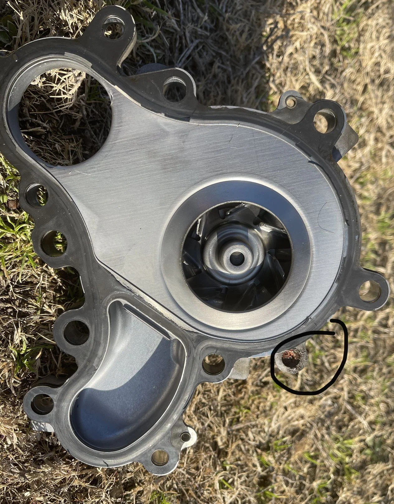

So I think I might have found my coolant leak, upon inspecting the old pump I found there is coolant in the circled hole:
is this the world famous weeping hole ?
Ok so after driving the car for about 800 Miles I can confirm that the coolant level has not moved. So in this case I'm going to assume the water-pump was leaking from that hole, very slowly, perhaps only while under pressure, by such a minute amount, that I was not seeing any stains. The pump itself had about 150k on it (original one) so it was definitely due for a change. While doing this job, you should also consider doing the belt / tensioner since the need to be removed in order to replace the wp.
So for now - Mystery Solved :)
