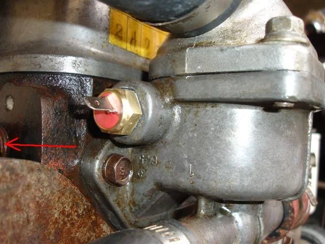

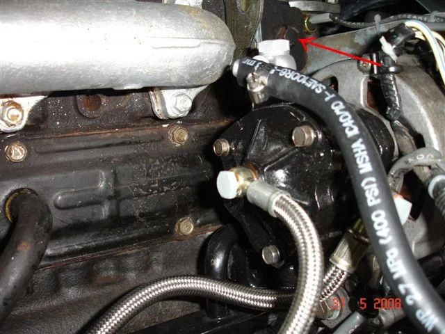

Into which port are you guys installing an aftermarket water temp sensor on your 3B's??? ...
This unused plug here looks ideal to me:
:beer:
PS. These photos are of 1B engines but I believe your 3B should be the same in this regard. (And the sender in the 1st pic is the one for the combination-meter temperature gauge.0
