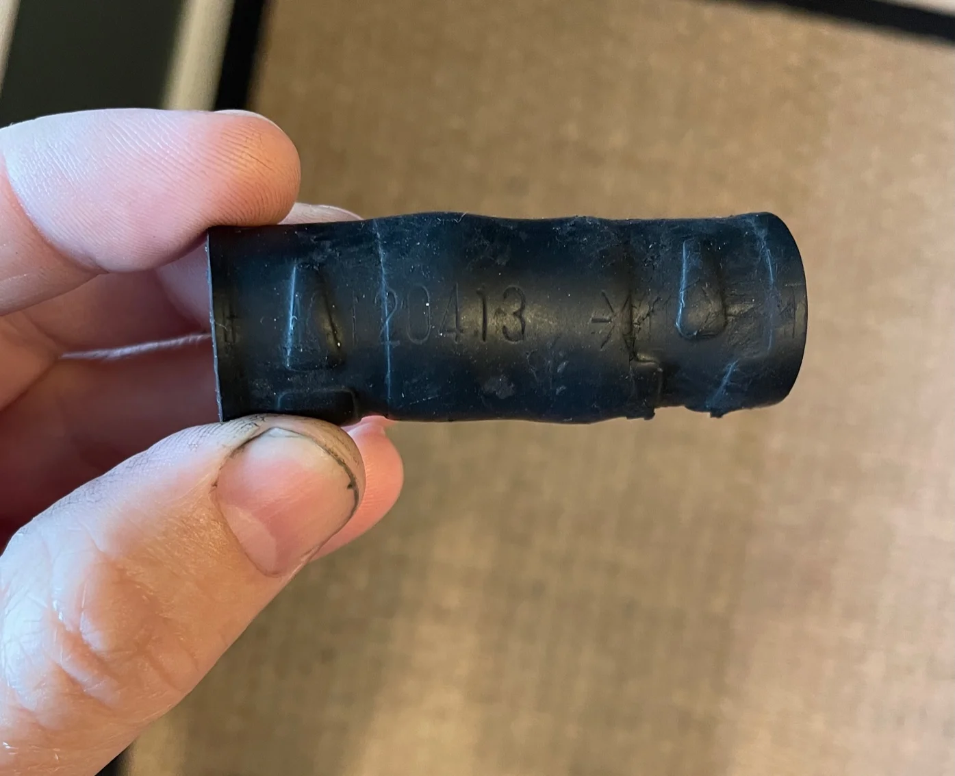

Good thread guys. Does anyone know the part number for the small hose that connects to the thermostat housing? It's stamped K120413 but I can't find anything online. It's the hose he references at 4:20 in this very informative video: Youtube Video . It was a tight space and I tried removing it before watching the video and tore the dang thing.

Well, think I found it. Looks like Toyota 99556-20200 heater hose. I suppose I just have to cut it to length.
That is the part number I show in my diagrams.
