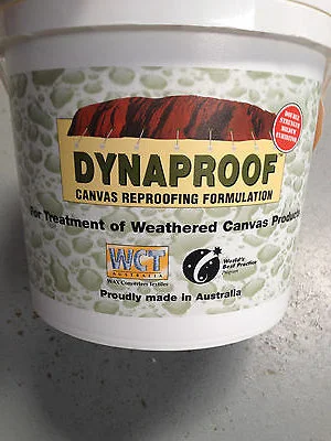

I have a Hannibal RTT that is in need of re-"dynaproofing". It is only available in Australia and New Zealand as far as I can gather and I CANNOT find any company that will ship some to the US which seems odd bc it's non-flammable and water based.

Are you sure it's water based? I just re-waterproofed my canvas tent, and after some researching it seemed there were only 2 different type of canvas treatments, silicone and fluorocarbon. As long as you kept to the same type as the factory coating, I don't think the exact brand mattered. At least for the silicone treatments, all brands were pretty much the same thing with different labels
Directly from the website
DYNAPROOF/Waterproofing
DESCRIPTION
Dynaproof is a superior water based formulation which does not have an offensive vapour odour as present in the alternative brands currently available. Dynaproof will help to increase the life of canvas by restoring weather proofness and resistance to mildew. The DynaproofedTM finishing formulation utilises the world’s highest quality chemicals and incorporates Rot-Proofing, Mildew resistance, UV Resistance, Pigment Colours, Water-Proofing agents and 2 Acrylic binders in the processing formulation. The 2 acrylic binders offer maximum UV resistance and colour stability in terms of light fastness (maximum of 7), and also combine to resist both air-born and wet- soil bacterial and fungicidal activity.
Application
The Dynaproof formulation is designed to penetrate into the interstices of the canvas to be restored rather than sit on the surface. By doing so, on sound cloth, it restores the waterproof factor back to its original specification.
Dynaproof can be applied to any Cotton or blended Cotton Canvas product commonly used in tents and on Caravan awning roofing.
Dynaproof is not recommended for application on Acrylic or 100% synthetic Canvas.
The fabric should be thoroughly dry and brushed free of dust and dirt. Once this has been conducted, the fabric should be laid flat on the ground and then the reproof formulation applied.
This may be applied by any one of the following methods: Sponge, Roller, Brush or Spray Gun.
The fact that it says it’s water based freaks me out to add anything else to the mix. If I absolutely can’t get ahold of this stuff, I think I’d be safe with silicone, but I’m trying to exhaust all my options before I go with another option
