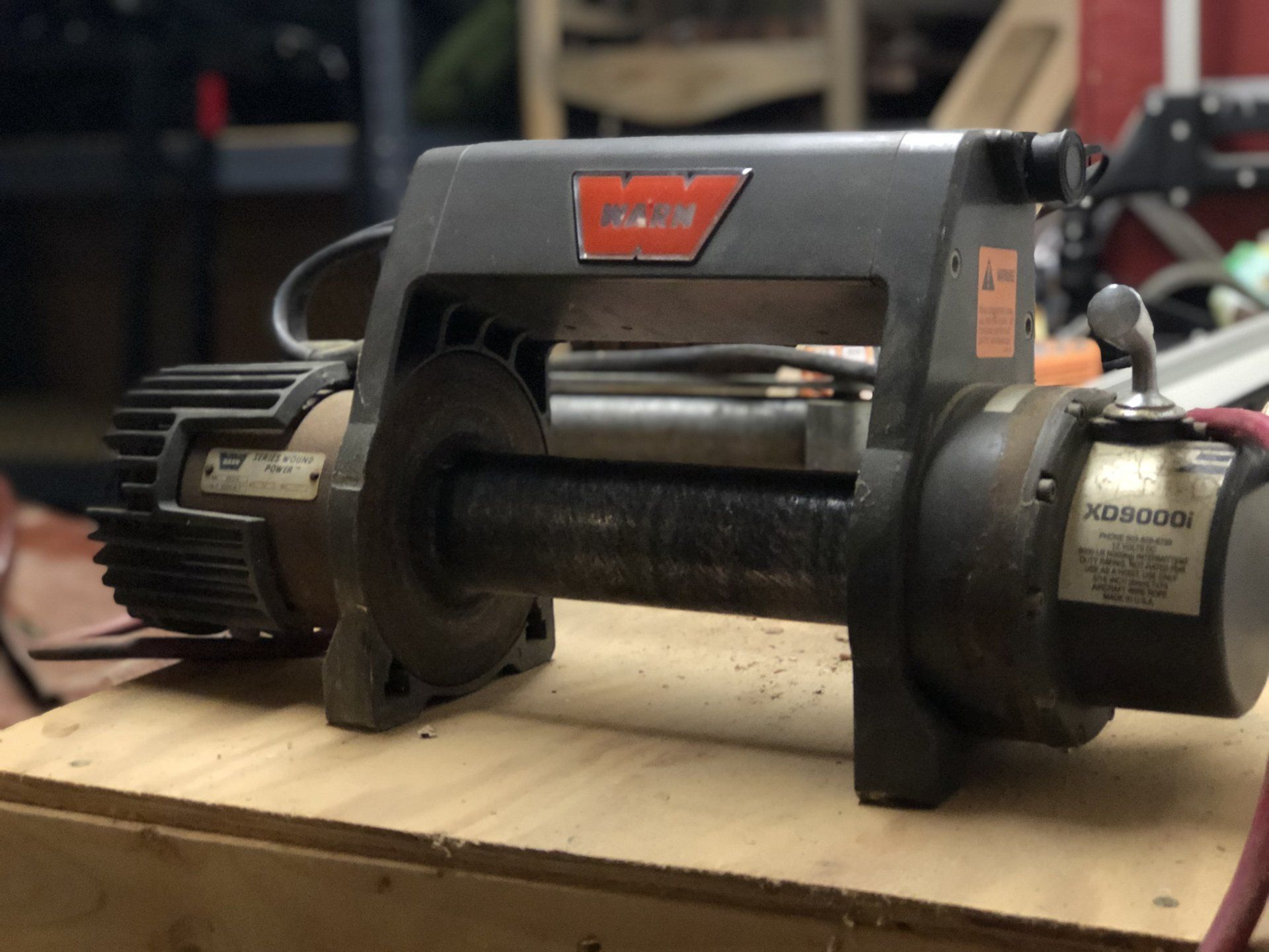

Greetings all, I just started a rebuild on a sweet Xd9000i. Tearing it down and evaluating now. Can’t wait to see where this takes me.. Anyone else running this winch??

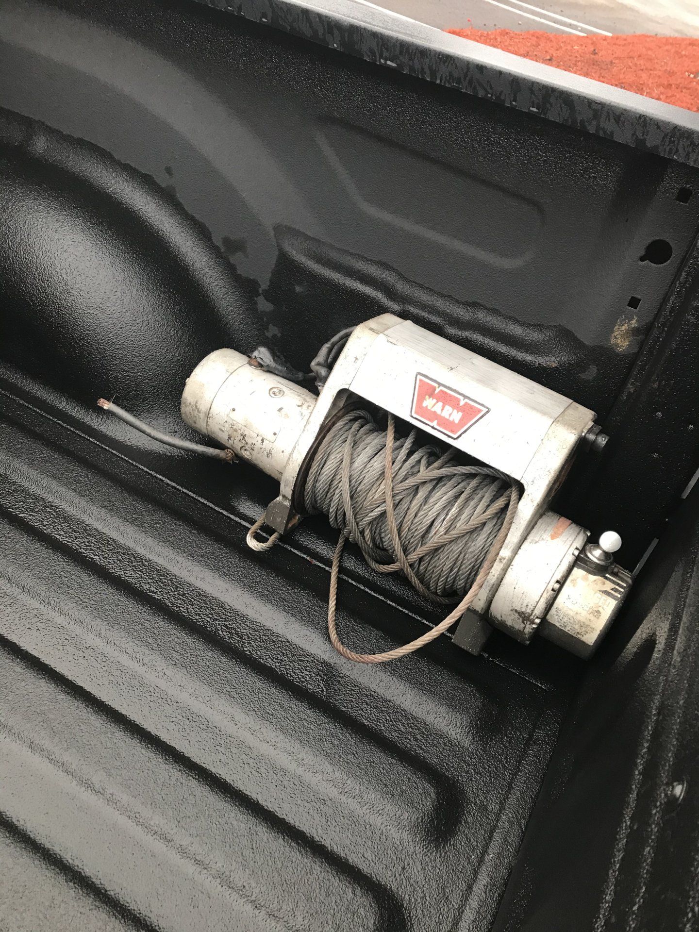

I have two XD9000I that I have had for over 20 years. Great winches and even after hard use at times they have never let me down. I have rebuilt the one on my 40 and the one on my Z71 I haven't rebuilt it yet. I bought it new in 1993 and it is still going strong. :hillbilly:

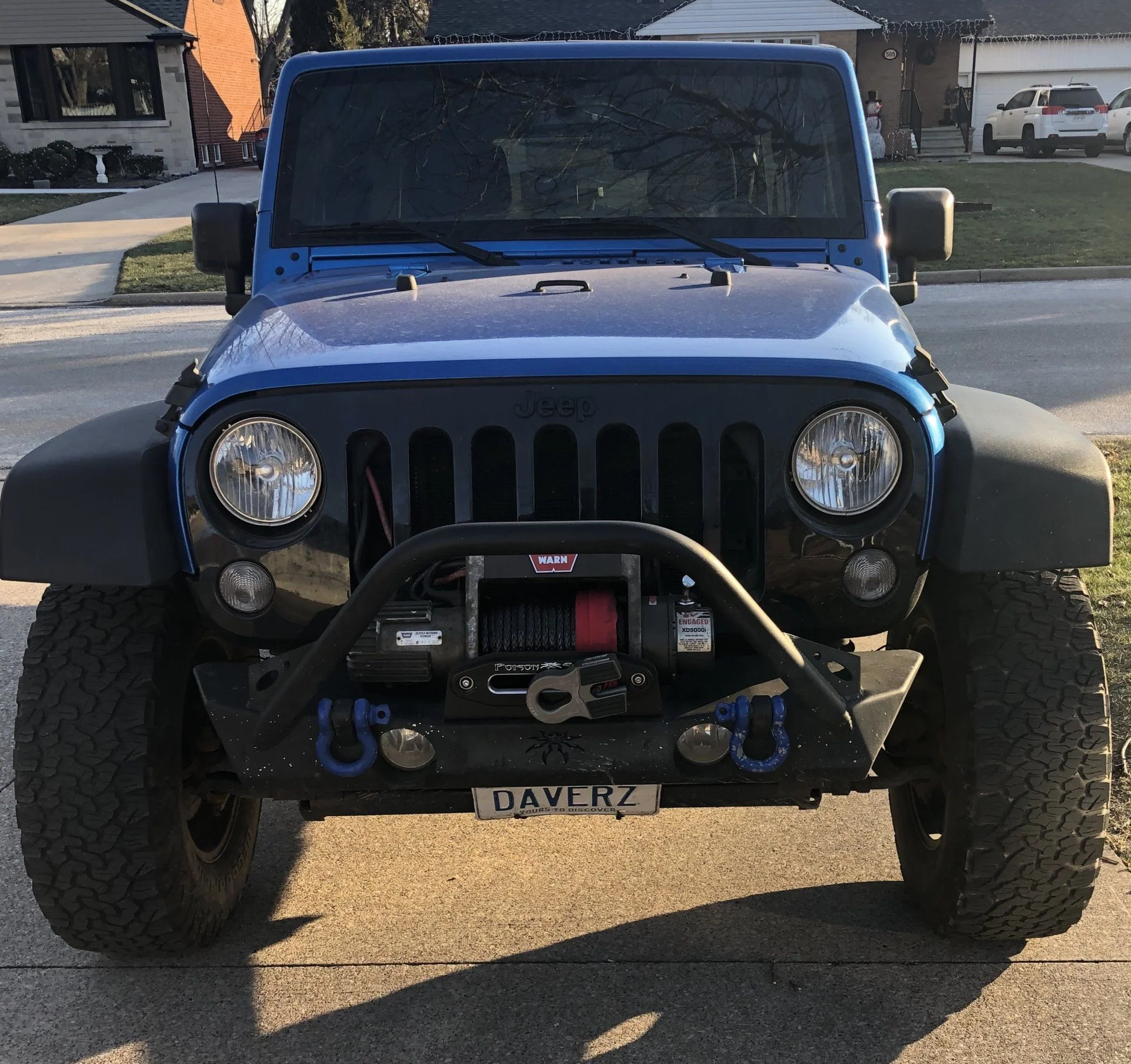

I picked up a used xd9000i a while ago and it's on the front end of my Jeep JKU. When I first picked it up I ripped it apart and cleaned it up. I learned the hard way not to remove the brake from the drum without securing it so that it wouldn't unwind. Recently ripped it all apart again, replaced the brake, gaskets and re-greased it. I learned a lot about it. I found the service manual online and a couple of other online resources and videos. The service manual really helped out. The first time I didn't use ep moly grease so it made it too sticky to easily free spool. This time I cleaned all parts really well, used Klondike EP#2 Moly grease on all parts and as the service manual says, don't use grease on the outer side of the sliding gear, use a light machine oil otherwise free spooling can be a bear.

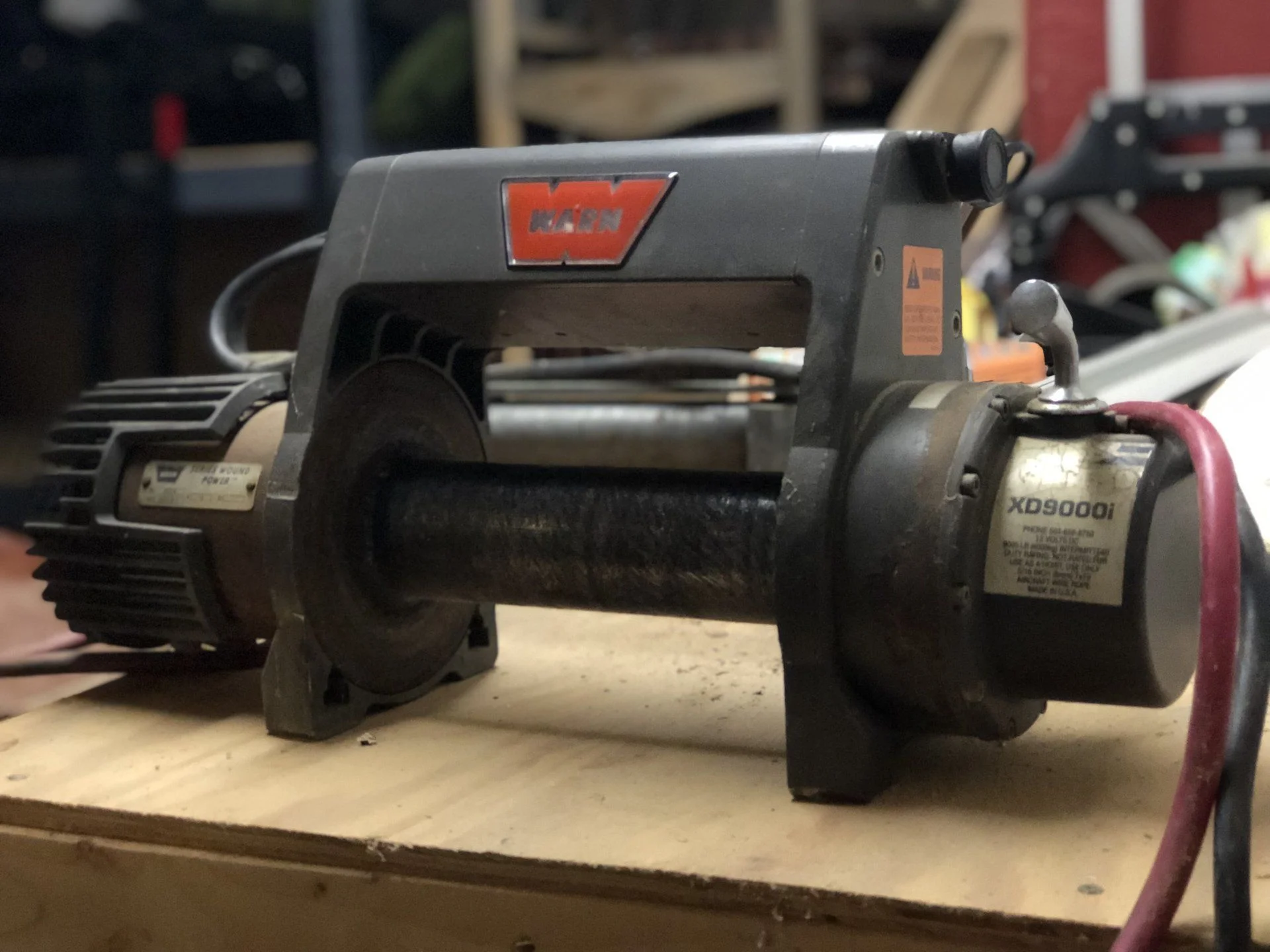

Thanks so much! I got the winch and it’s in better shape than I was expecting. Free spool worked good. Waiting on new batt cables and controller to try out the function.

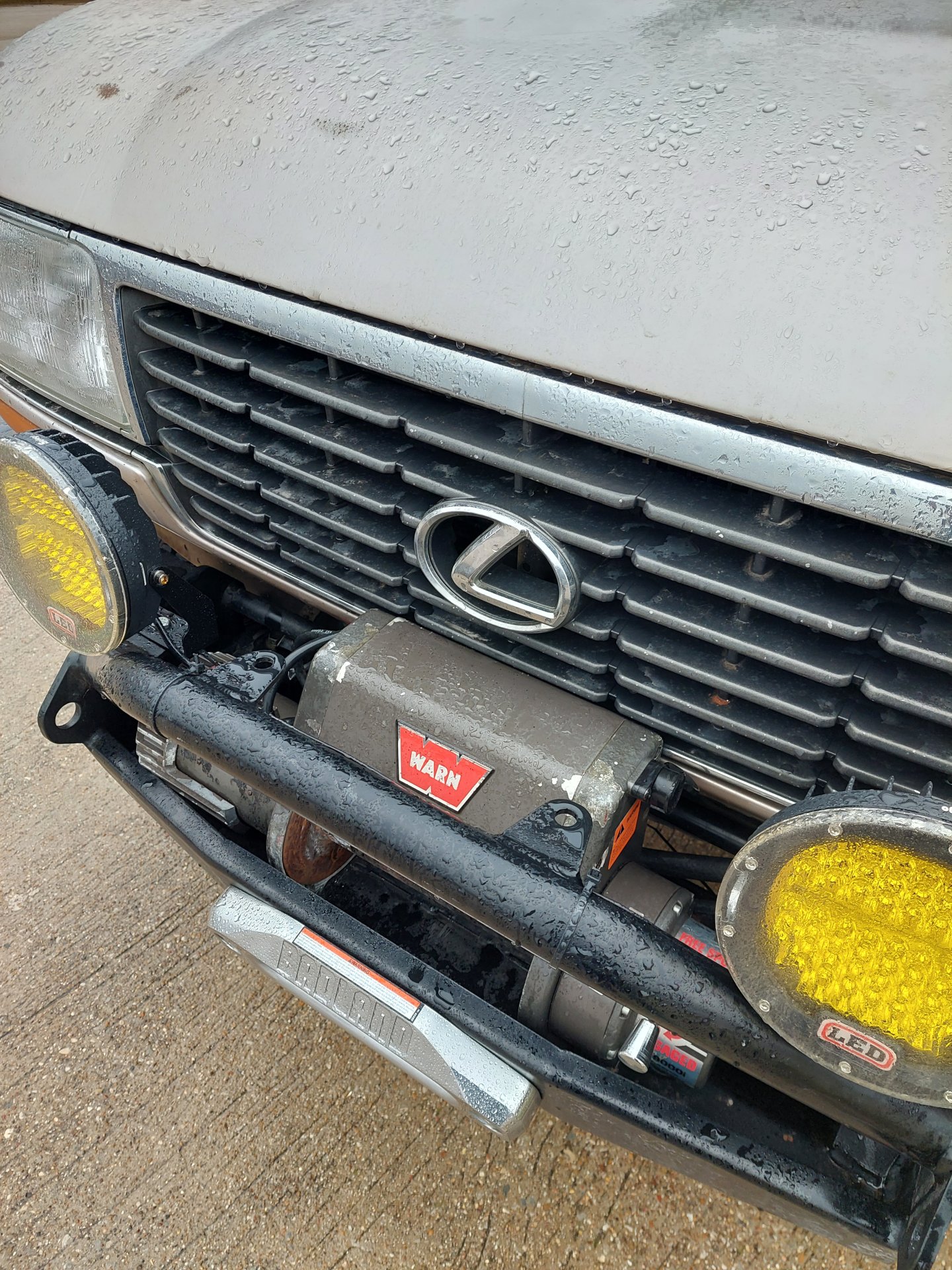

Got it with my 80. It’s laying down in the bumper, tjm don’t know to much about it yet. I hooked it up and it works!
