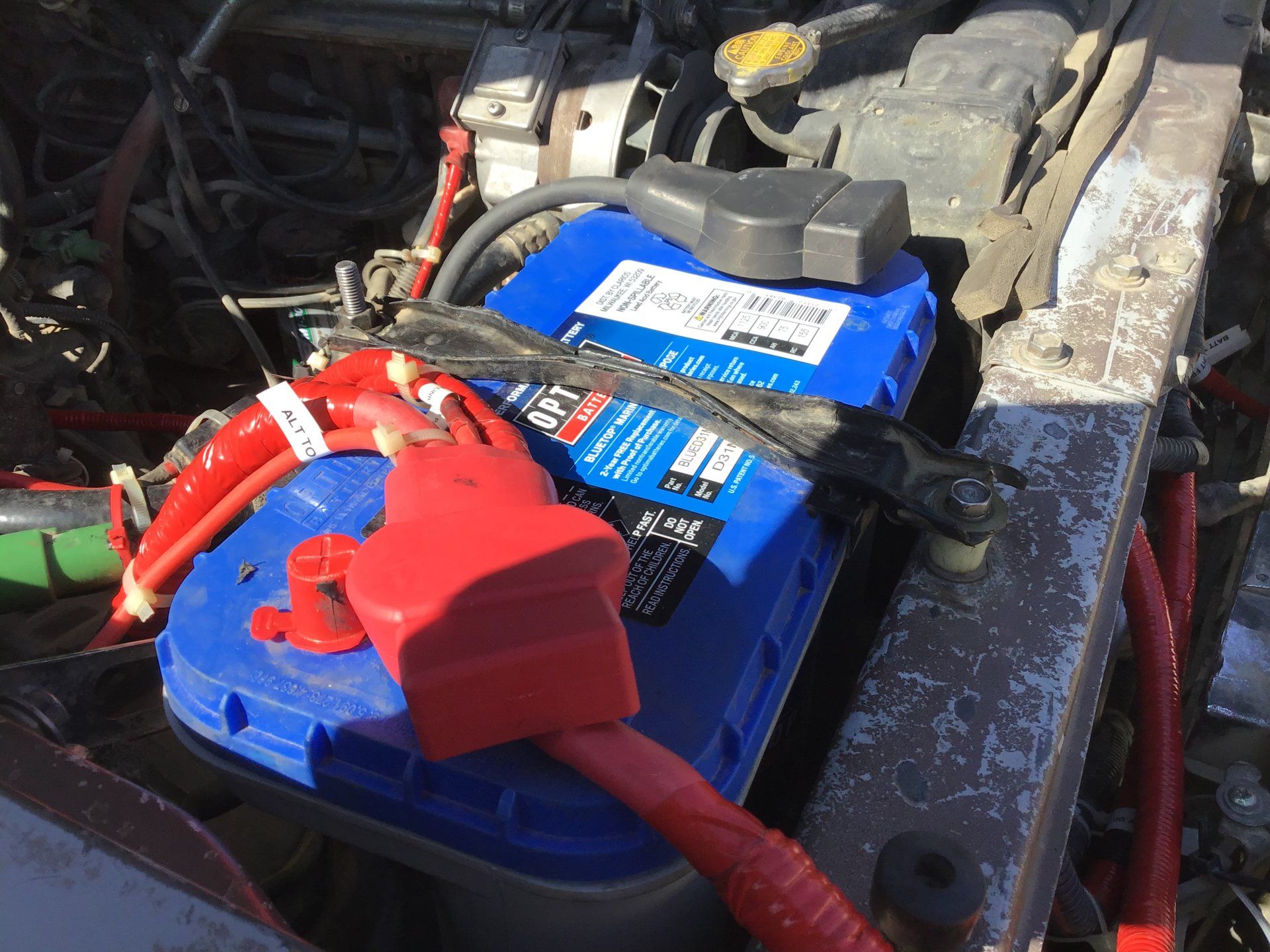

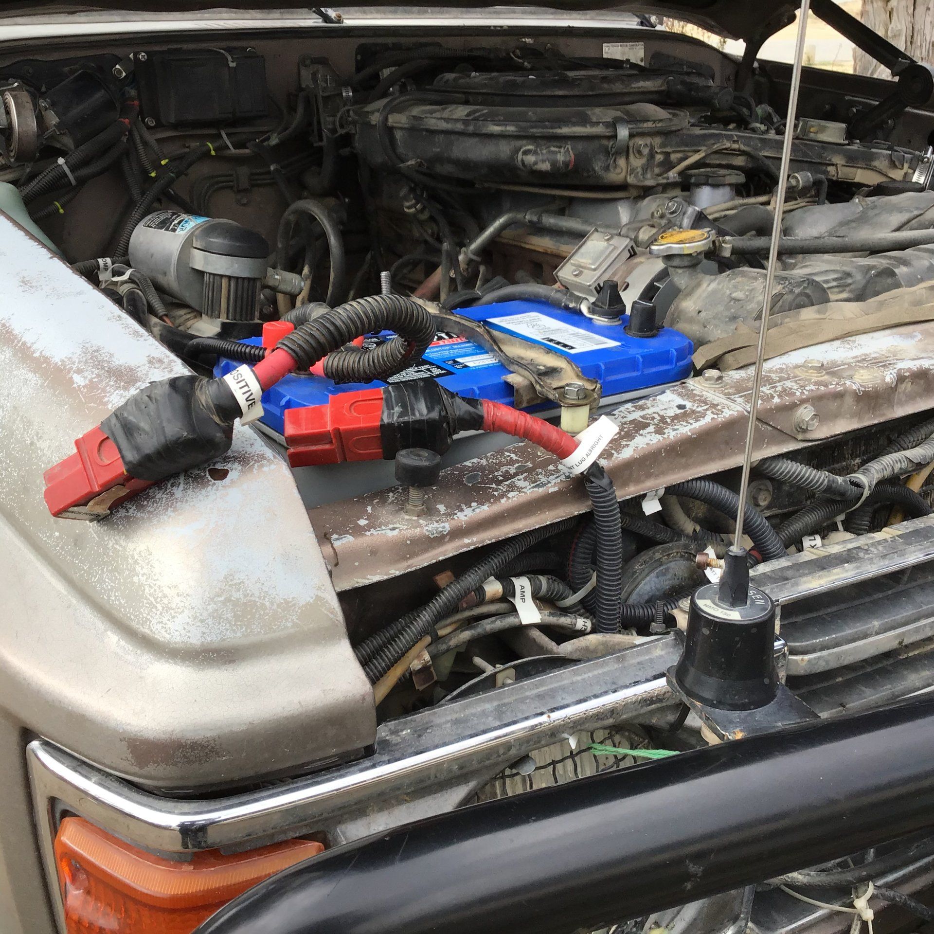

Ha-thanks for the mention. That's exactly what I do. Winch is dead in normal life. Only when I go off road do I connect the Anderson SB connector. Dead simple, safe, works. I connect when airing down tires.
Yep, me too. Not connected until I’m out wheeling. Very safe.

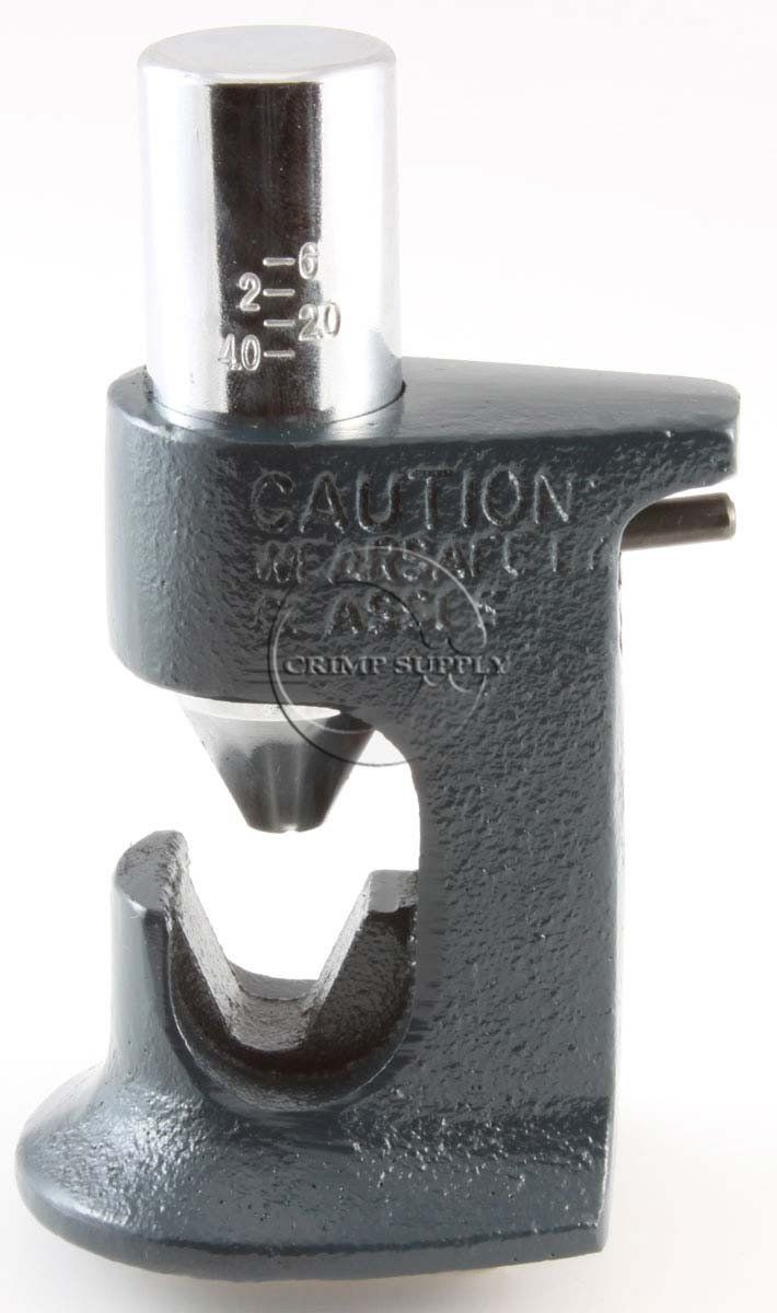

Still haven't found a place to buy those Anderson Power Poles North of the border which is closed. I can get them online, but shipping has been very slow and adds to the cost. I'm not sure how I can crimp them correctly without a very solid crimping tool, which a sales place might have. Did you John McVicker or Cuiserdrew crimp these things at home?
Got some Anderson 180 power poles this week. 2 red and 2 black. Not completely sure yet on where I will run the cables. Any reason not to run both positive and negative through the same whole in the front clip? And maybe mount the Anderson Plugs right beside each other? Just a bit short of space now with two batteries under the hood. @Cruiserdrew got a photo of yours?
