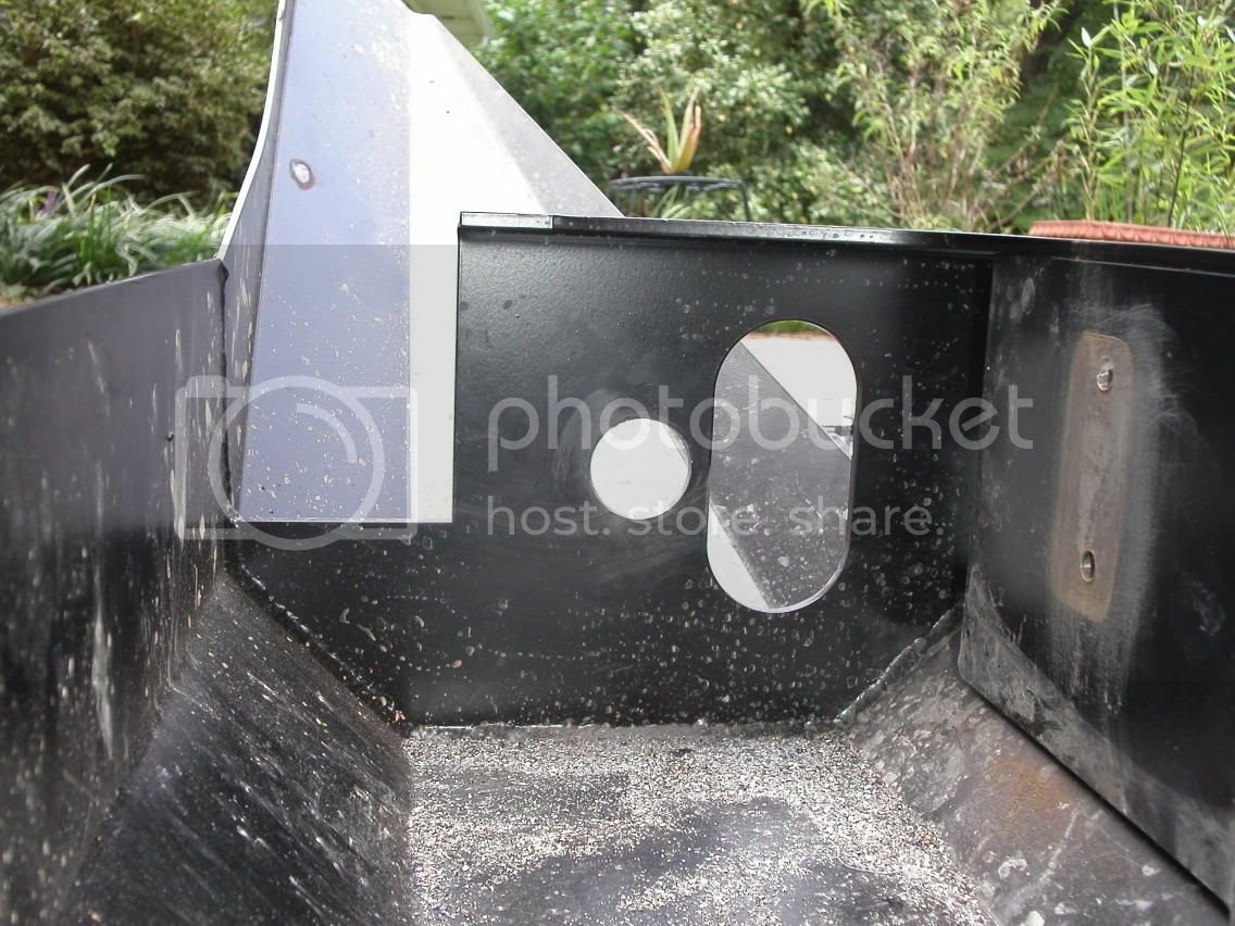

Because we didn't want to alter the control box and the socket is in the wrong place for this bumper, we drilled an additional hole near the access in the bumper. Here is the hole we drilled:

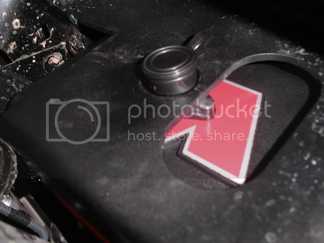

Here is a pic of the new socket hole once the control box was installed.:
