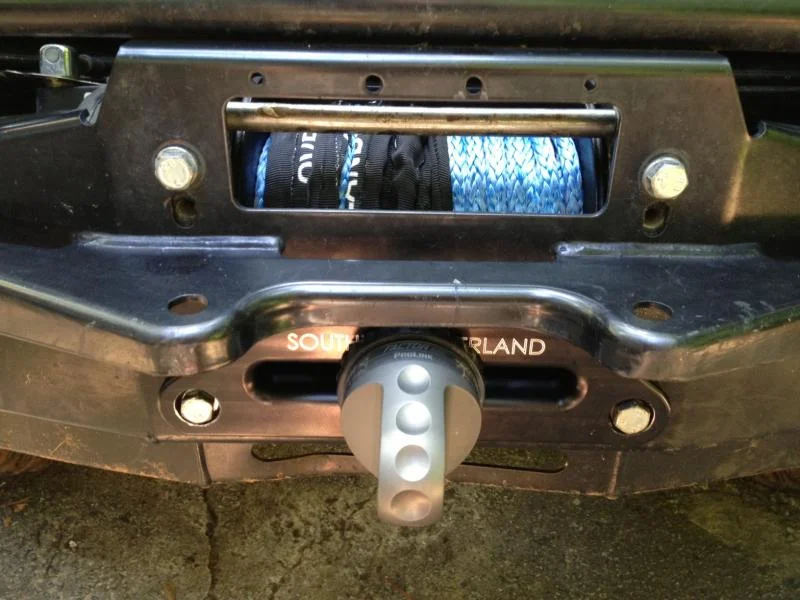

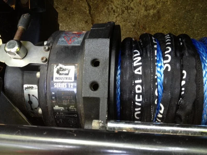

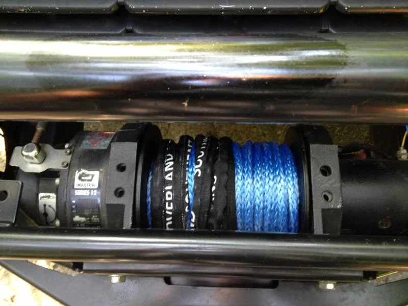

Here are some pictures of the end result (see below for the entire re-build process):

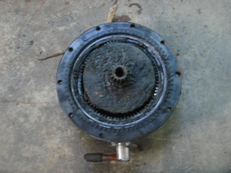

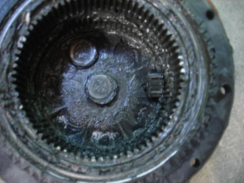

The first thing that I did was start tearing the winch down. I was very eager to see what was on the inside. Would I find bad grease, no grease, muddy grease, only mud? I was thrilled to find that the inside of the winch was flawless and the grease was that right amount and there was no indication of any water damage, rust, etc. I pulled all of the gears any started cleaning everything. My goal was to get everything down to the bare metal and then re-grease with the CAT (Catipillar) grease. Once cleaned to the core, I was very happy with what I saw.

Here are some before pics of what I found when I pulled the winch apart:

I also picked up a hawsers fairlead for steel cable and mounted up the winch to my ARB one afternoon by my self with the help of a floor jack and ratchet straps. I get it mounted and use the motor while spooling the cable...everything is finally done.
