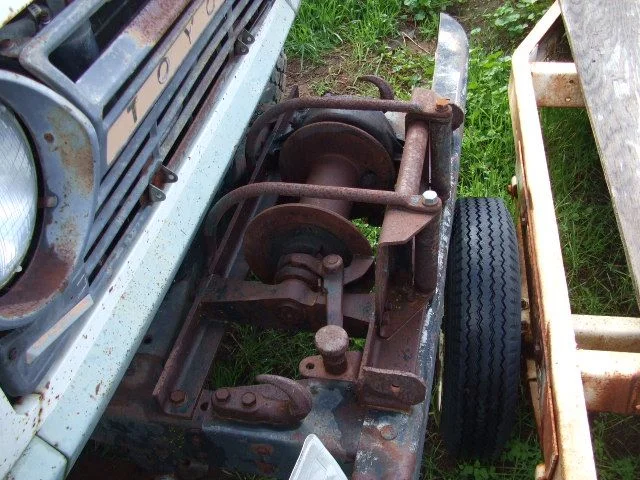

I was trying to find a picture for you ... but FJ55s that came with the factory PTO had extended frame supports to make enough room for the winch. If you had a 8274 I would tell you it was definitely worth the trouble to make it work, but with the older 5687 it's gonna be a personal judgment call.
Not the best picture, but you can see the extenders bolted to the frame horns if you look close ...
attachment.php
Tucker
Yeah, It looks like I need to open up that space a little. Just thinking and looking.
