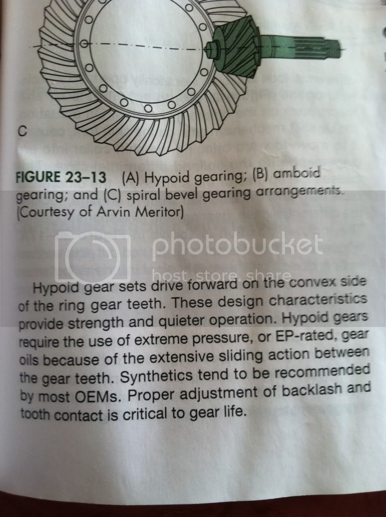

I was at Wally Mart the other day, and I took a second look at the Super Tech Gear Oil, and the only thing that came to my mind, was that it mentioned nothing about being a Hypoid type oil," as my Service and owners manual boldly indicates". to use for the diffs. It did howevere say it was a GL-5 compliant gear oil
What does the Hypoid stand for, would appreciate anyone reading this , to school me a little on that.....:meh: and is it really necessary on a vehicle that is not used a lot, and I change my fluids frequently
Thanks
CRUISER TIME
Hypoid is a gear type. The final drive gears used on our trucks are hypoid gears.
Must use GL5 or GL6 gear oil in the diffs.
Thanks for the info, much appreciated.
2 more Questions:
#1. What does the category GL-5 " Or any number mean after the GL-"
#2. The label stated GL-5,, ok to use on our Cruisers, even if the word Hypoid Is not stated ?
I noticed on the royal purple brand it said GL-5 and for vehicles requiring Hypoid specifically.
Thank you :cheers::beer::clap:
CRISER TIME
