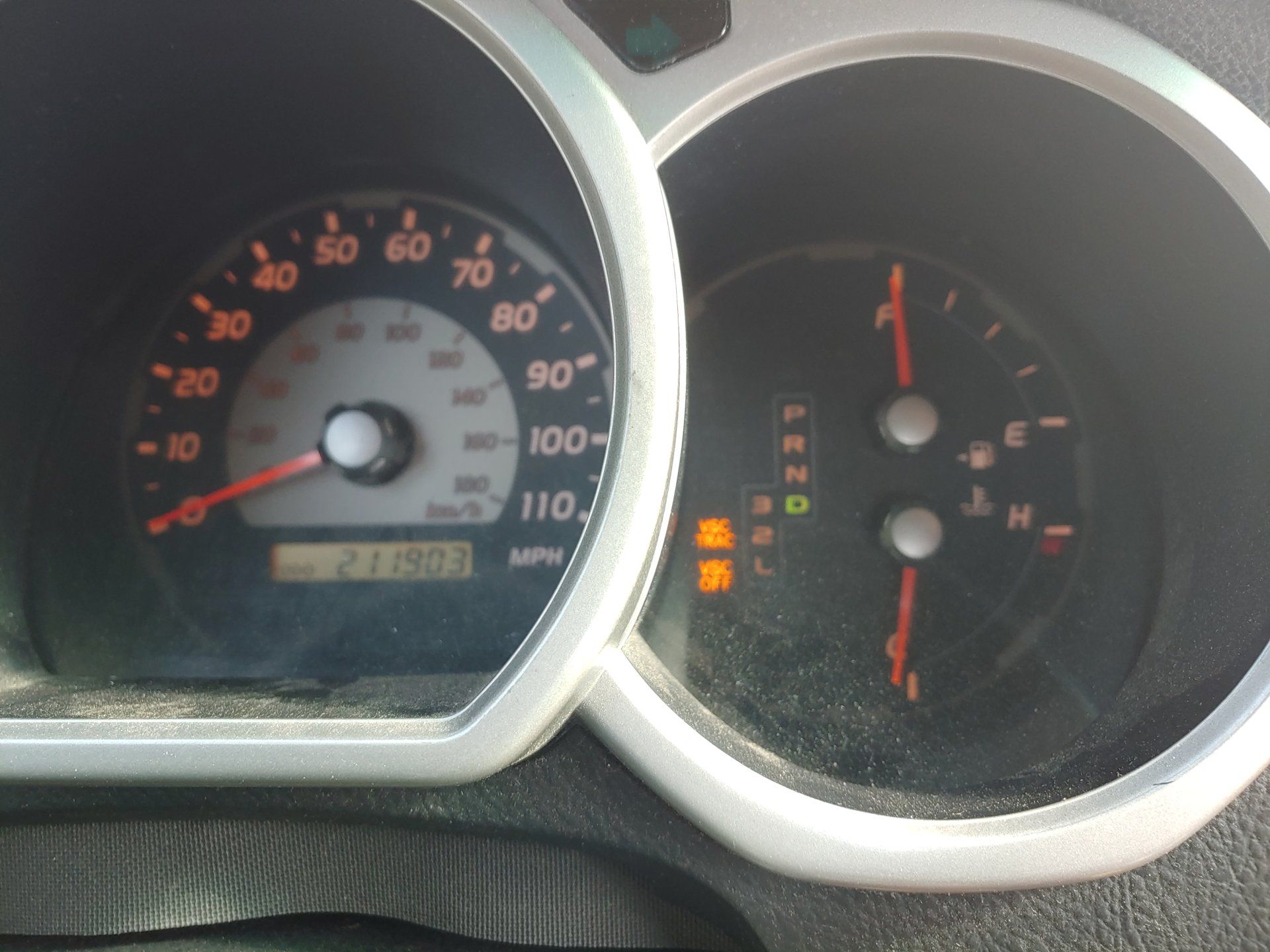

This spring my '03 4R sat for months in the garage, battery died. When I got it running these lights came on. They go out when it is restarted, but come on with first movement of the wheels. ABS sensor possibly? No mice in my garage, they would have chewed into the dog food and bird food bags if they were in there. Thoughts?
ABS/VSC/TRAC ECU needs a zero point. If you get a scanner that can read that system it will tell you exactly what is wrong (or use Techstream). If it isn't a sensor/harness based on that, you can also do a zero point calibration and it should take care of it.

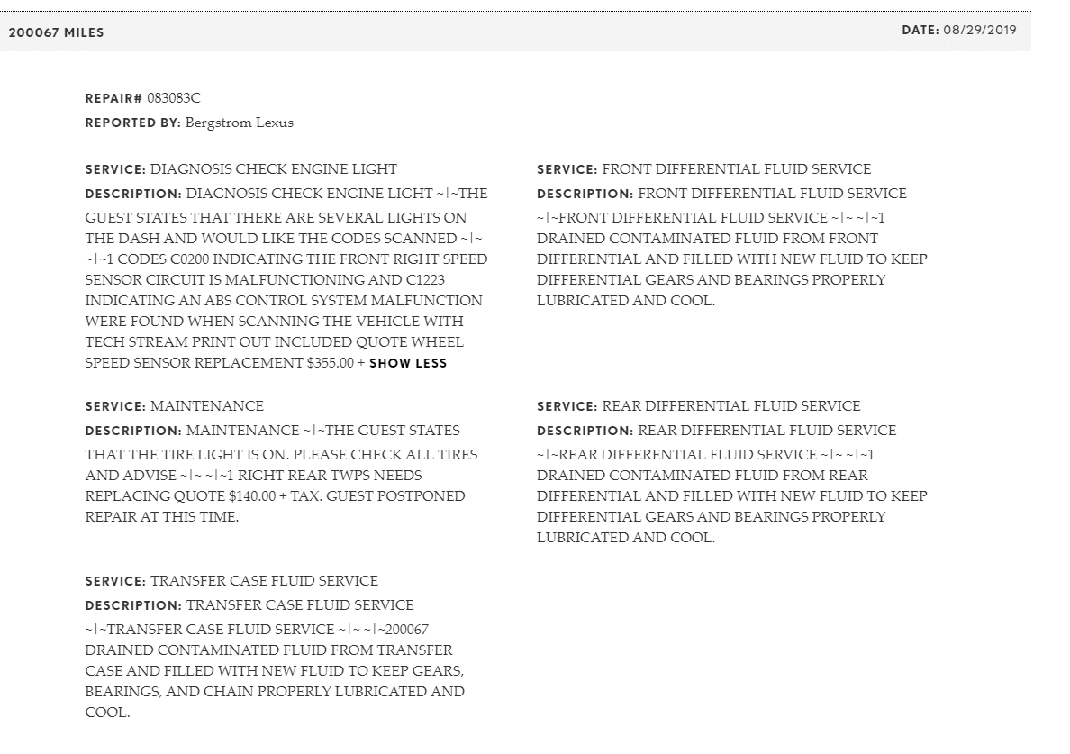

Whoever did the cv job mucked up the right front wheel speed sensor, as per that printout. Easy enough to break it when doing that job. Since she's nowhere near the shop that did the job, either she or you should pony up for the fix...
Thank you very much. She is actually in the same town with the guys who did the CV job - Ness Auto Center in Green Bay, WI. When she addressed the issue with them they kindly offered to fix it for another $600. And I don't know what kind of material(s) and parts went into the unit. AFAIK, the boots better be Toyotas or Rockfords as they are the only ones made of a thermoplast material (Dupont), the rest of aftermarket fall apart pretty quickly, especially with the temperature ranges in WI.
