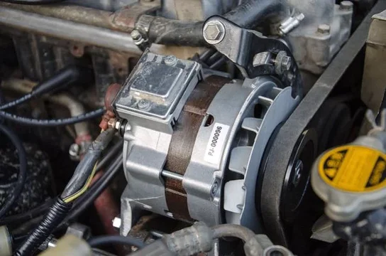

My voltage regulator is mounted on the alternator. Held on with two Phillips head screws. It's just a little thing. Visible and easily removable with the alternator installed.
Show us a picture of it :)
There were several different alternators over the years that the 60 series was made. I cant remember exactly what years had what VR setups, but im pretty sure the separate VR were used on the 62.
On my '86 its bolted to the top of the alternator and looks like a rectanglar plate with two screws holding on. If yours looks the same, then its not the kind with the separate VR.
My '85 looks just like Machinists.
So does mine. It's easy to replace, and cheap. When they do go out, it's sudden, so I carry a spare.
There were several different alternators over the years that the 60 series was made. I cant remember exactly what years had what VR setups, but im pretty sure the separate VR were used on the 62. On my '86 its bolted to the top of the alternator and looks like a rectanglar plate with two screws holding on. If yours looks the same, then its not the kind with the separate VR.
Is that a replacement alternator? Iirc, mine looks like that but instead of at the 10:00 position my VR is at the 2:00 position.
