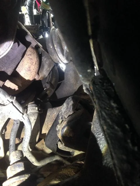

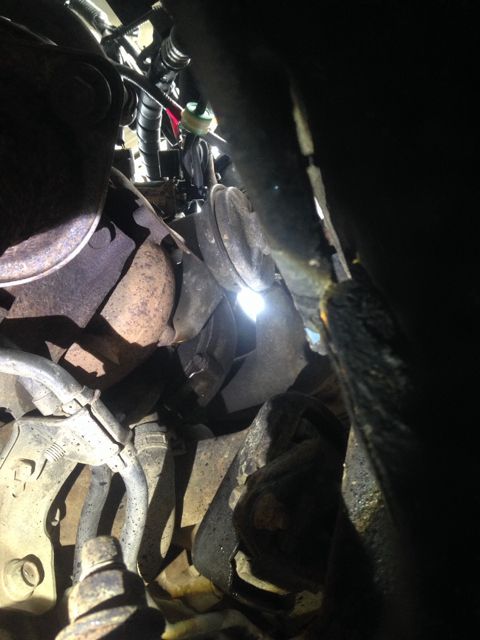

The turbo itself is not easy to photograph, since they is a lot of stuff in the way when mounted. In the pics from above (PS), on the right is the PCV on the compressor side. In the middle is the vacuum actuator box for the vane adjustment. The box is supplied with vacuum from the VSV to right and above the actuator.
TBC...
From below visibility is better, but not much more interesting... :-). The vacuum actuator is still quite visible though
