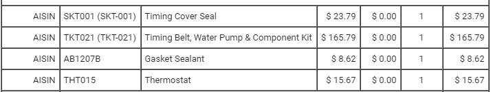

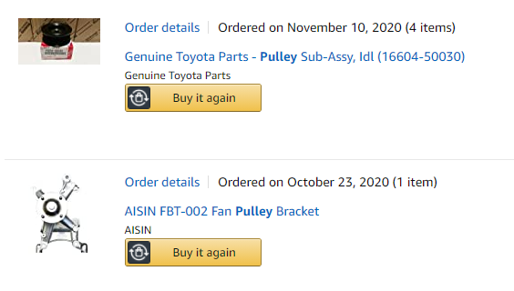

Did you ever figure out the squeal/chirp? I did my timing belt less than 1000 miles ago and did the idler pulley, tensioner, and a new fan bracket. I did not replace the idler or tensioner for the serpentine belt. But I did install a new serpentine belt. Mine chirps when the engine is cold though it's 70*F outside. It goes away after the truck warms up. It is RPM related so I am sure it's something on the belt drive. There are no pulleys wobbling.
ONe way to check for the fan bracket and other pulleys health is to take the serpentine belt off and turn them by hand. If they feel "grainy" or rotate completely free with absolutely no resistance then they are most likely bad!
The fan bracket is new. I ordered a new idler pulley and tensioner because I don't feel like listening to it any longer. If it stops raining I will install them today and report back.
I replaced both and the squeak is gone. Both the tensioner pulley and idler felt grainy, though the tensioner felt worse and didn't spin very well. I wish I would have done this during the timing belt install. I had to remove quite a bit to get to it.

Ok. Checked my notes. I bought a new serpentine belt at the same time I did the timing belt. It squeaked afterwards so I did the fan bracket. Still squeaked so I did the idler and tensioner and it went away. My guess is it was the tensioner. Probably didn't like being pried to remove/install the serpentine belt. Orders are in chronological order.
