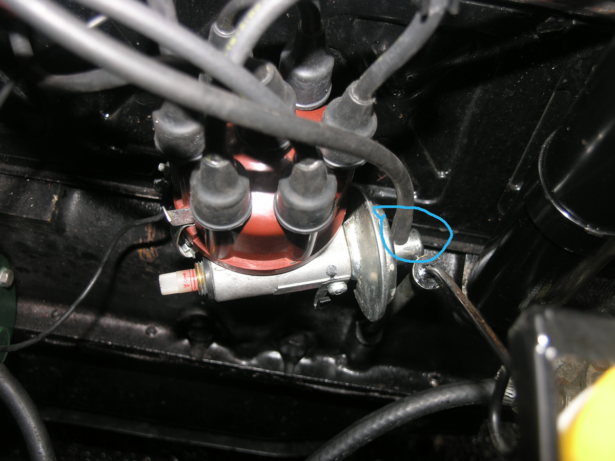

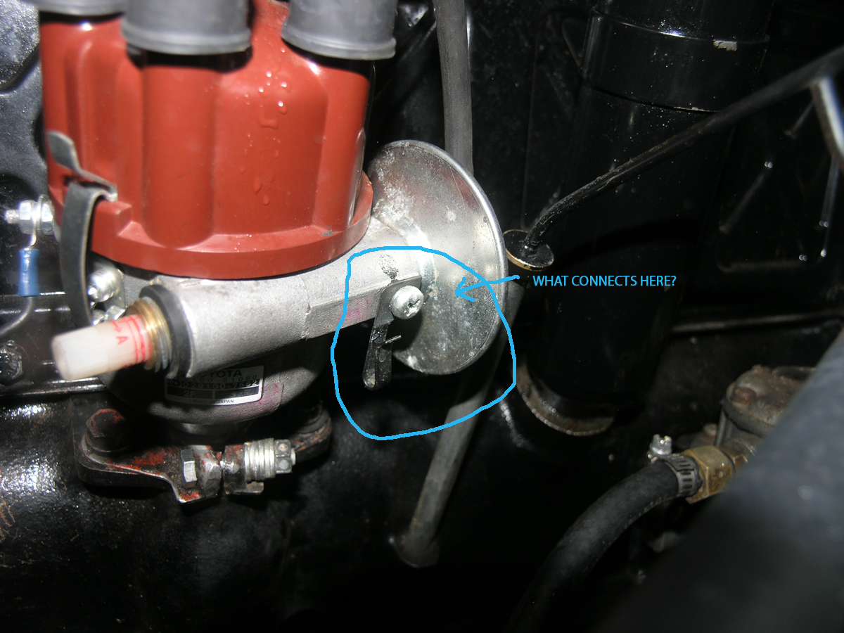

hey, does anyone know if there is supposed to be a wire connected here on the dist?
it is a 1964 fj40 f135 motor with the newer toyota dist that is compatible with the old style
sorry if this is a dumb question :D
also this is a vacuum advance distributer i believe no?
I have the vacuum line running to the carb at the port for vacuum in the base is that correct?
Seems to run the same with that line pinched or not pinched, does that seem right?
Let me grab some photos brb
so itested the vacuum advance by removing the vacuum line form the carb side, then sucking on that line while running, the idle went up, all good there.
Removed the vacuum line form the dizzy side and hooked it up to the carb side, , no vacuum at idle, ( normal ) and when i rev it i have vacuum, all good there....

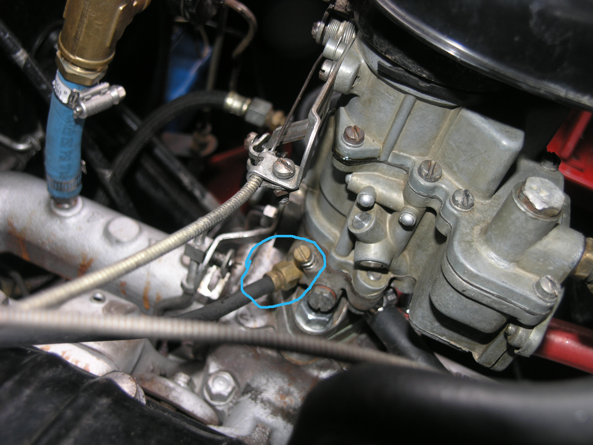

A little history, PO had made a PCV fitting in the based of the front of the throttle body/base, and was running no riser.
I put in a riser/ insulator from Mark ( thanks Mark ) and capped the old one by putting a rubber hose with the other end sealed..., but i megan thinking,,,... could that rubber hose cap cuase some weird disturbances in the carb to cause fuel to burn funny, like running air and fuel past a capped but empy space, of course it woudl wonk stuff right>?
So i crimped the hose closer to the old PCV tapped by the PO, seemed to be more POWER :)
So my plan is to get a nut or screw to seal up that old PCV the PO had tapped, removing any chance of a weird mixture air disturbance in the throttle body. Mark had told me to do this before but i rednecked the fix with my hose cap hehe.
