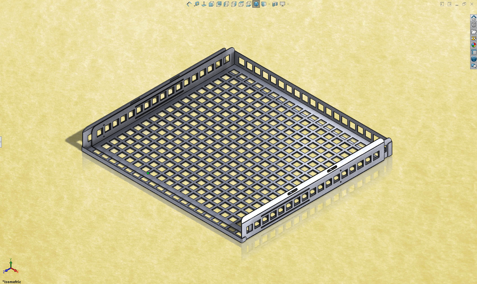

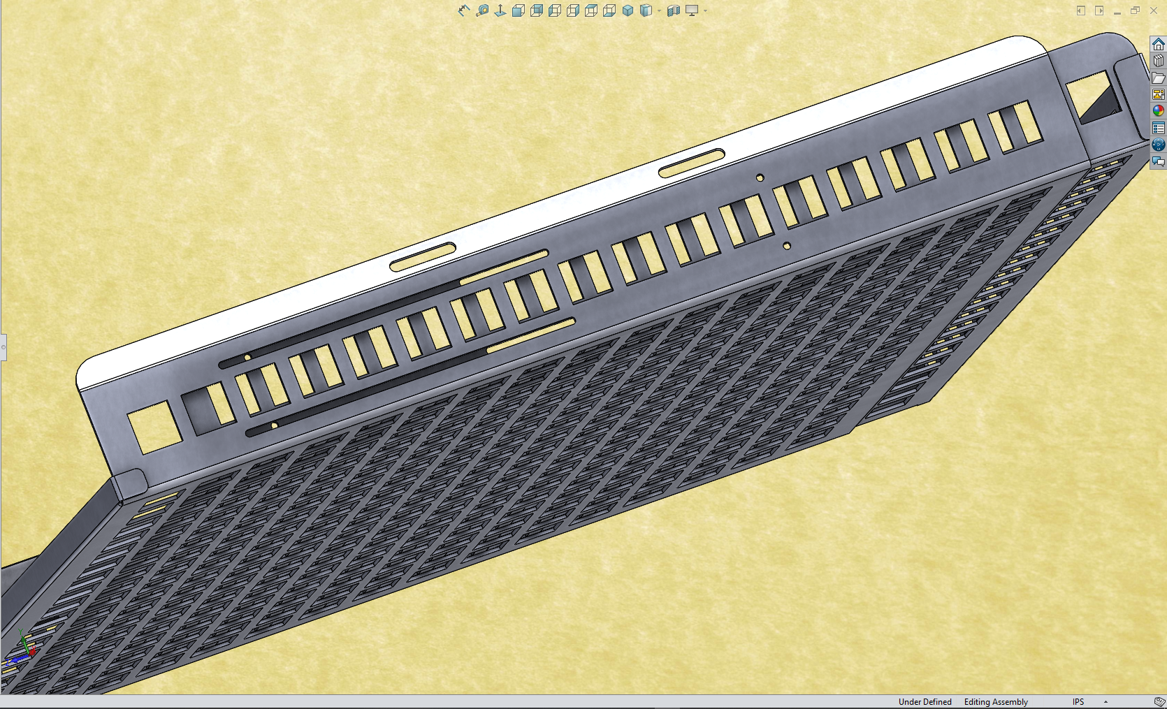

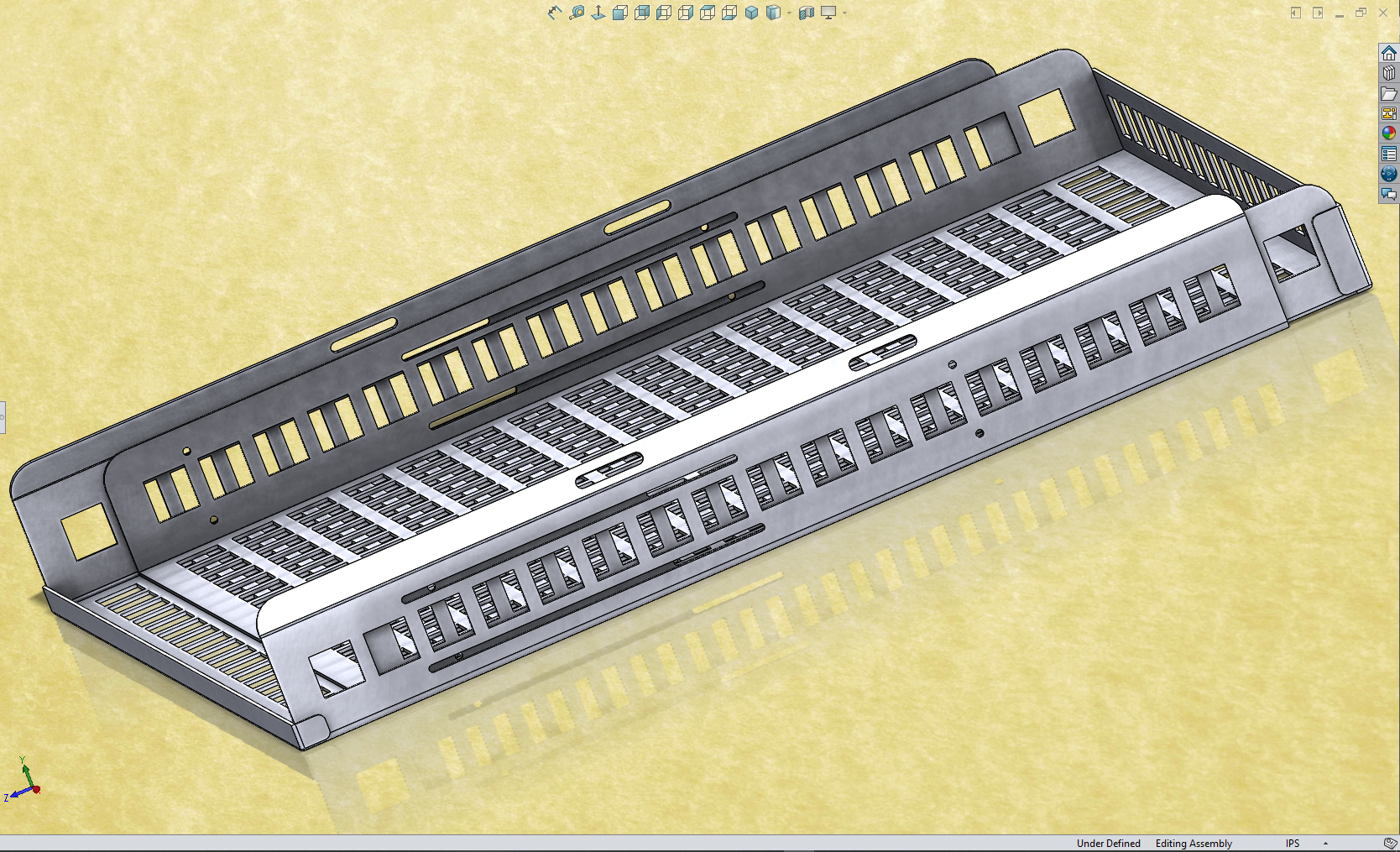

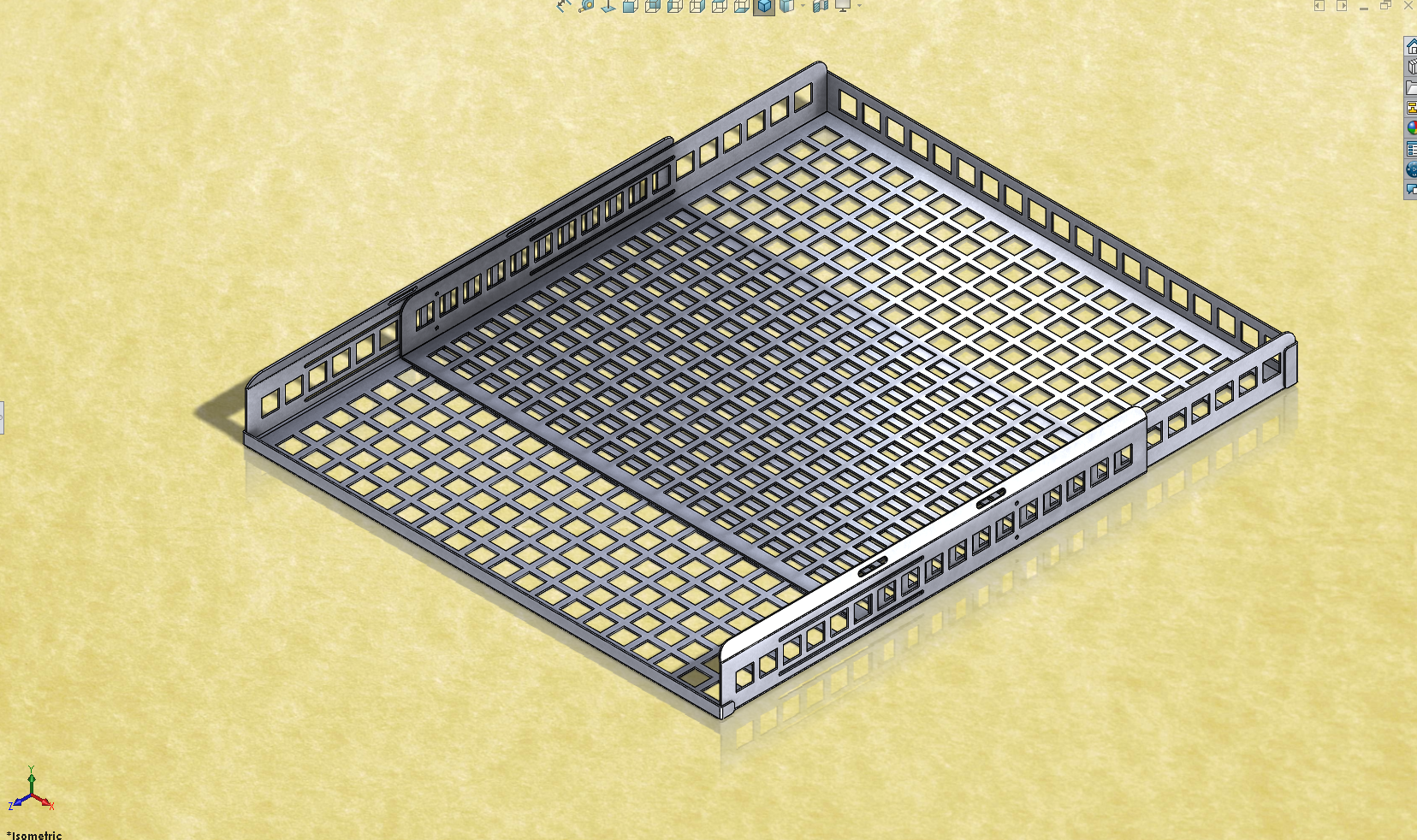

Regarding your up and coming rear shelf rack that'll sit between the rear quarter MOLLE panels, may I offer a suggestion? Can you have the shelf be adjustable in depth for so it can be custom for each owner?? The photos below is a design I just quickly threw together on SoildWorks to give an idea of what I'm talking about.
If you would like the SolidWorks files for reference, I send the to you, but all the dimensions were just ballpark from what I remember from when I measured some time ago, so even if you use my files you'll still need to fine tune your dim's.
Cool concept, but that would be a major time sucker on the laser $$$!

Yep, I know cutting all those squares would be huge and I don't think Victory would sell enough or could afford a die to punch them all out.
Unless you were to die cut sheets (4'x8'?) and then cut the sheets into the appropriate pattern for each application? Then again, you'll increase your welding costs since you'd be having to weld on all the hangers and bracketing needed instead of just bending them from one sheet.
