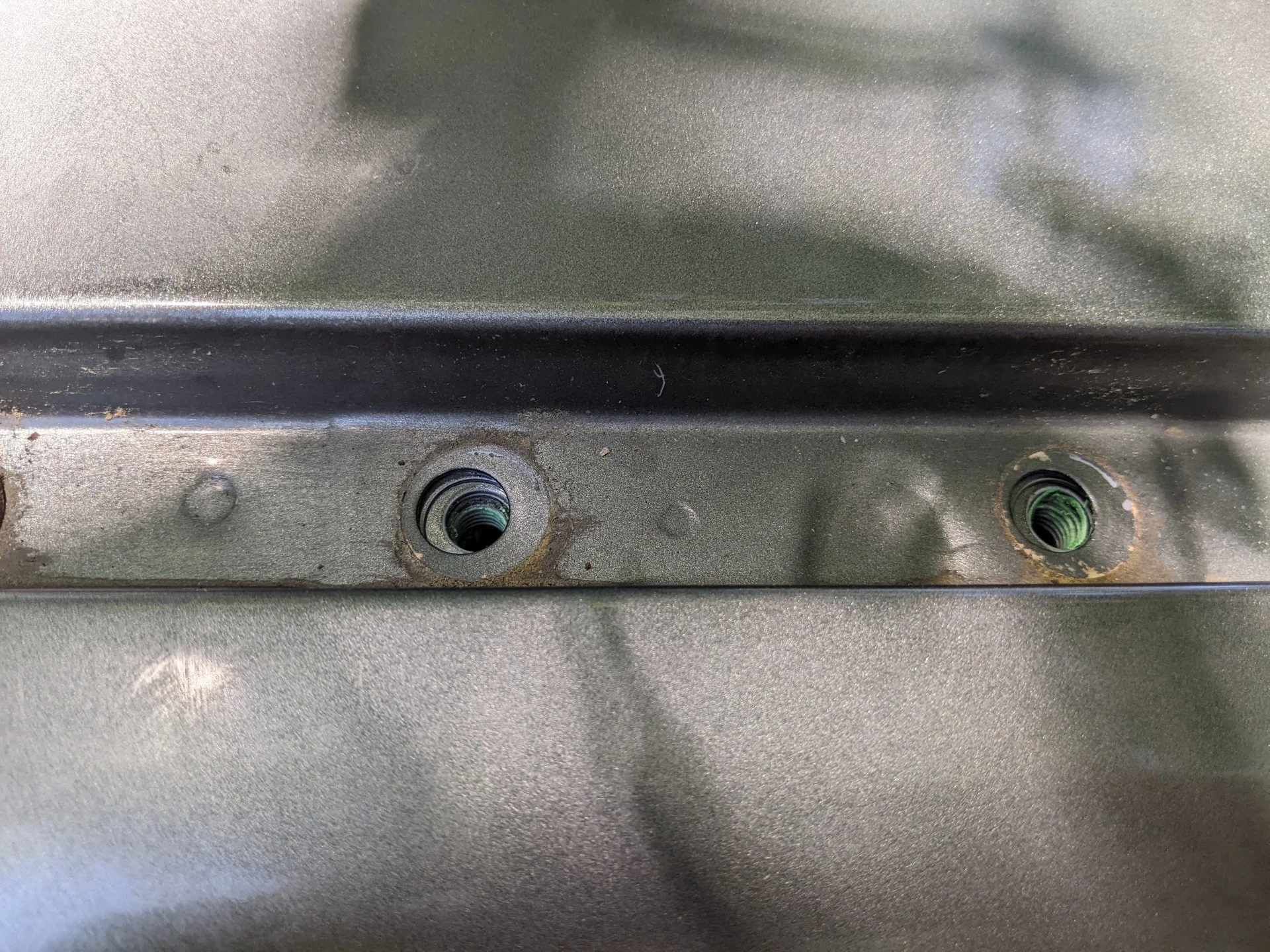

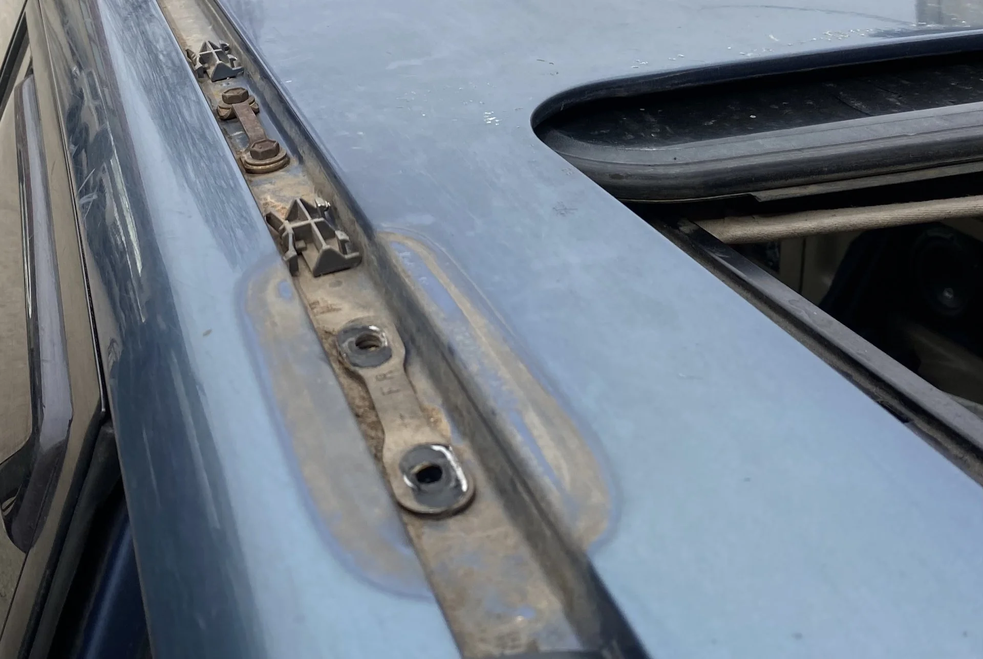

Should i leave these tabs or just bolt straight on? The lx470 2 out of the 3 mounting points are "blind" aka under the oem drip rail cover. The oem rack has these metal tabs on the mounting points. For the rail guess I will rig this up for now but end up buying a landcruiser drip rail cover as they use the "forward" mounts.

Keep the tabs. They act as washers/gaskets and help to stop water from getting inside.

As for the tabs, best to leave them out if possible. They are steel and not compressible so they don't act as any type of gasket. It also adds another leak point as you now have two seams (truck - tab - rack) versus one seam (truck - rack) for water to leak in from.

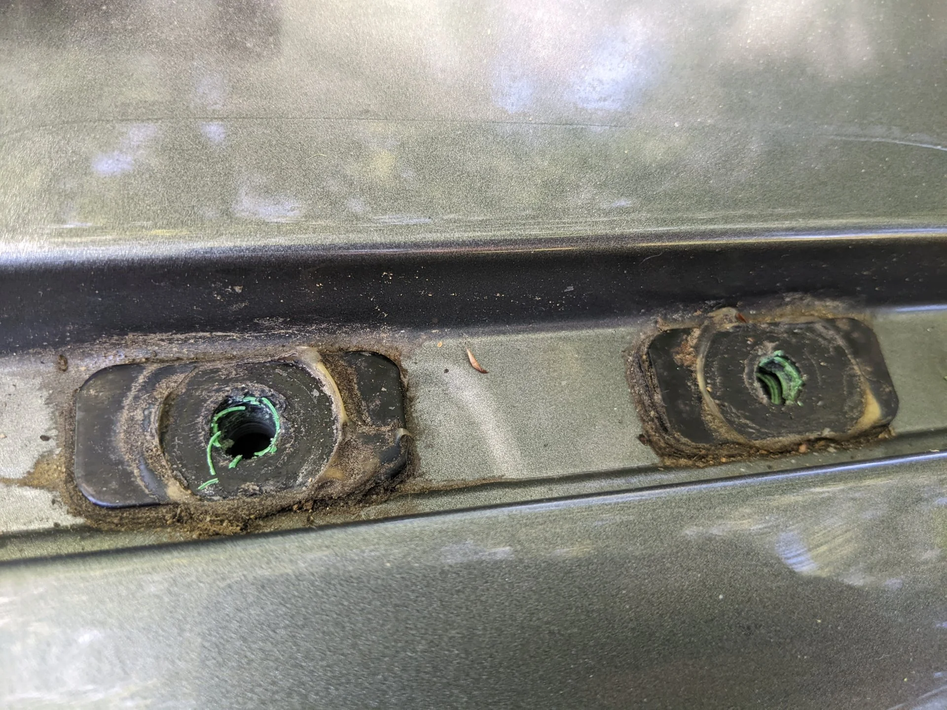

On my European HDJ100 they are a different shape - one single piece per pair of holes and have a black rubberised coating, similar in appearance to the ones in the first post. They definitely compress. It's a stack of 3 or 4 glued on top of each other.
I teared the coating on one while figuring what is the purpose of the entire thing.
But maybe the US ones are different.
Mine didn't have the dogbones, one tab per hole. I think I may have it mostly licked, ill update tomorrow.

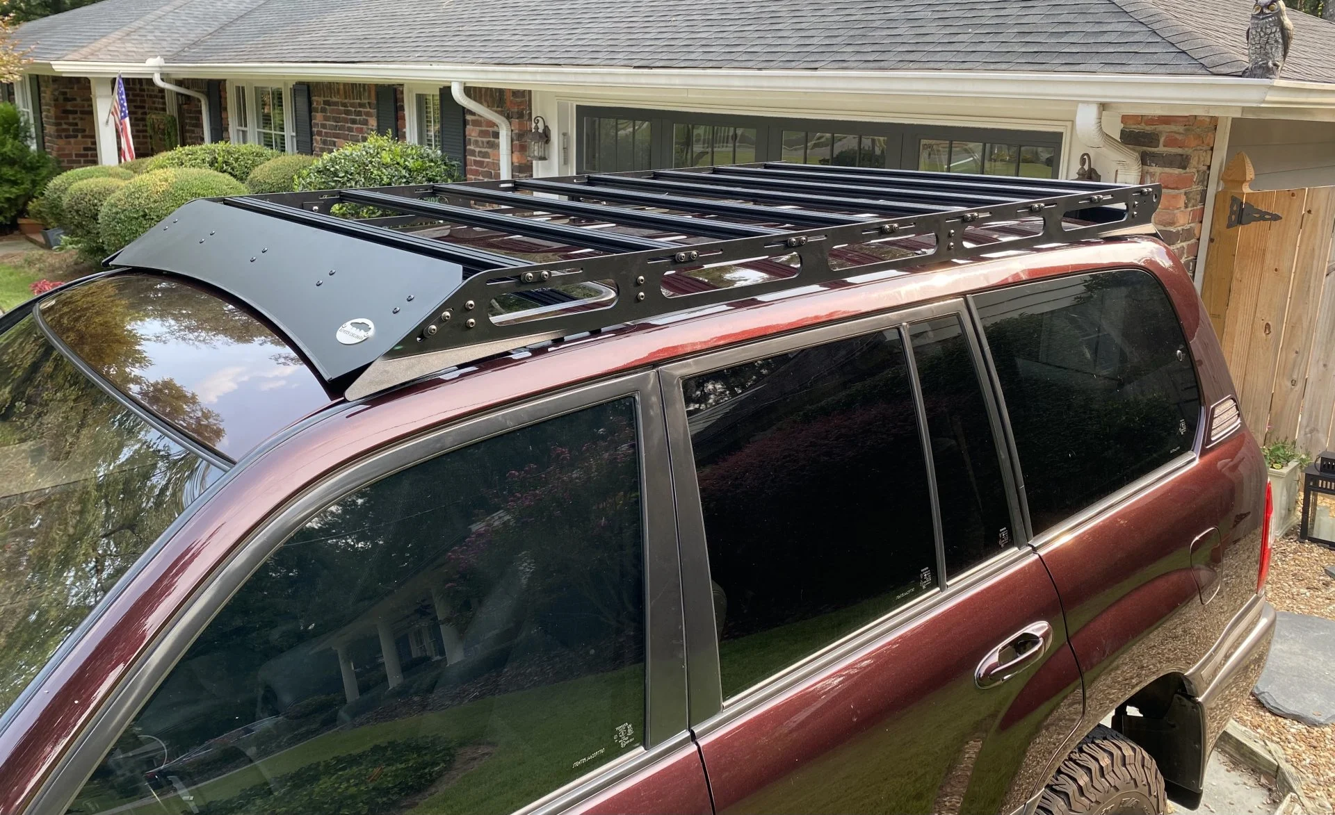

Update.....finally got it bolted down. Took lots of tweaking and loosened all the cross bars to barely on. I'll take pictures and post them when I have time Thursday at work.

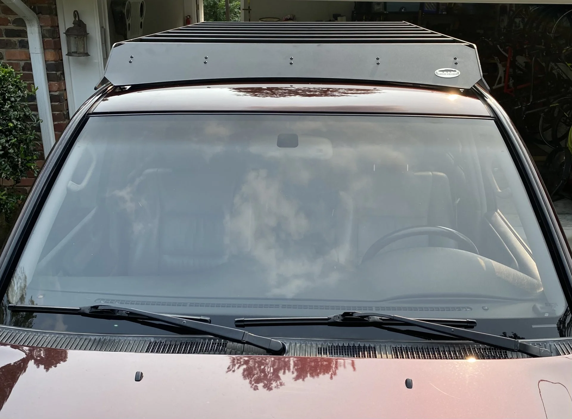

Want to know why the fitment sucked so bad?????? The V that is Lazer cut in the front fairing is on the DRIVER SIDE on mine. Every other example I've found no matter the make or model is on the passenger side. This really kept me scratching my head for HOURS. There are NO HD close up pics of this rack, I will fix that for others.
The rack had to be pushed and pulled to line up the holes to bolt it to the body. How I would do it differently? I'd install it like a prinsu rack and bolt the body mounts, then each side to that....crossbars next, then fairings.
The rear fairing is a fraction of an inch off the body in the back. If I were Victory I'd start the adjustment on the body mounts at the highest setting, then go up, same with rear fairing. There isn't much room for "lowering " which makes it not adjustable as the highest setting is the lowest setting if that makes sense.
Overall, I'd give the quality 9/10 (maybe my fairing is a Friday unit), hardware 10/10 (love the stainless), adjustability 3/10(the crossbar adjustability is nice), durability will come with time, looks 8/10, instructions 1/10, video 0/10 (a gx is not a lx or lc)

Something like that would definitely help seal it up some. Now that I think about it, I recall seeing some of those when I removed mine. Or maybe I've looked at too many rack install pictures before, during, and after mine that they are all mixed up in my head. Either way, rubberized dogbones would help seal up the holes while the metal tabs would not, making us both correct. :cheers:
