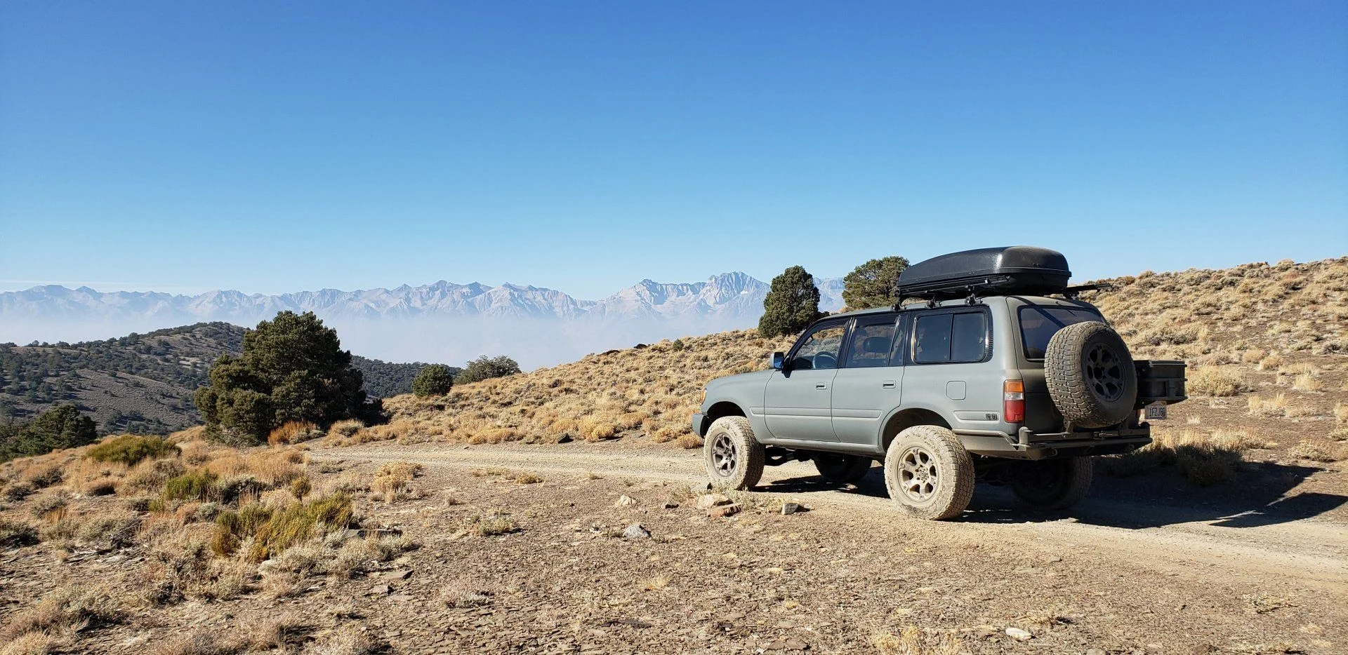

Any insight would be welcome. I've included a picture in the guise of supporting details, but clearly just vanity.
