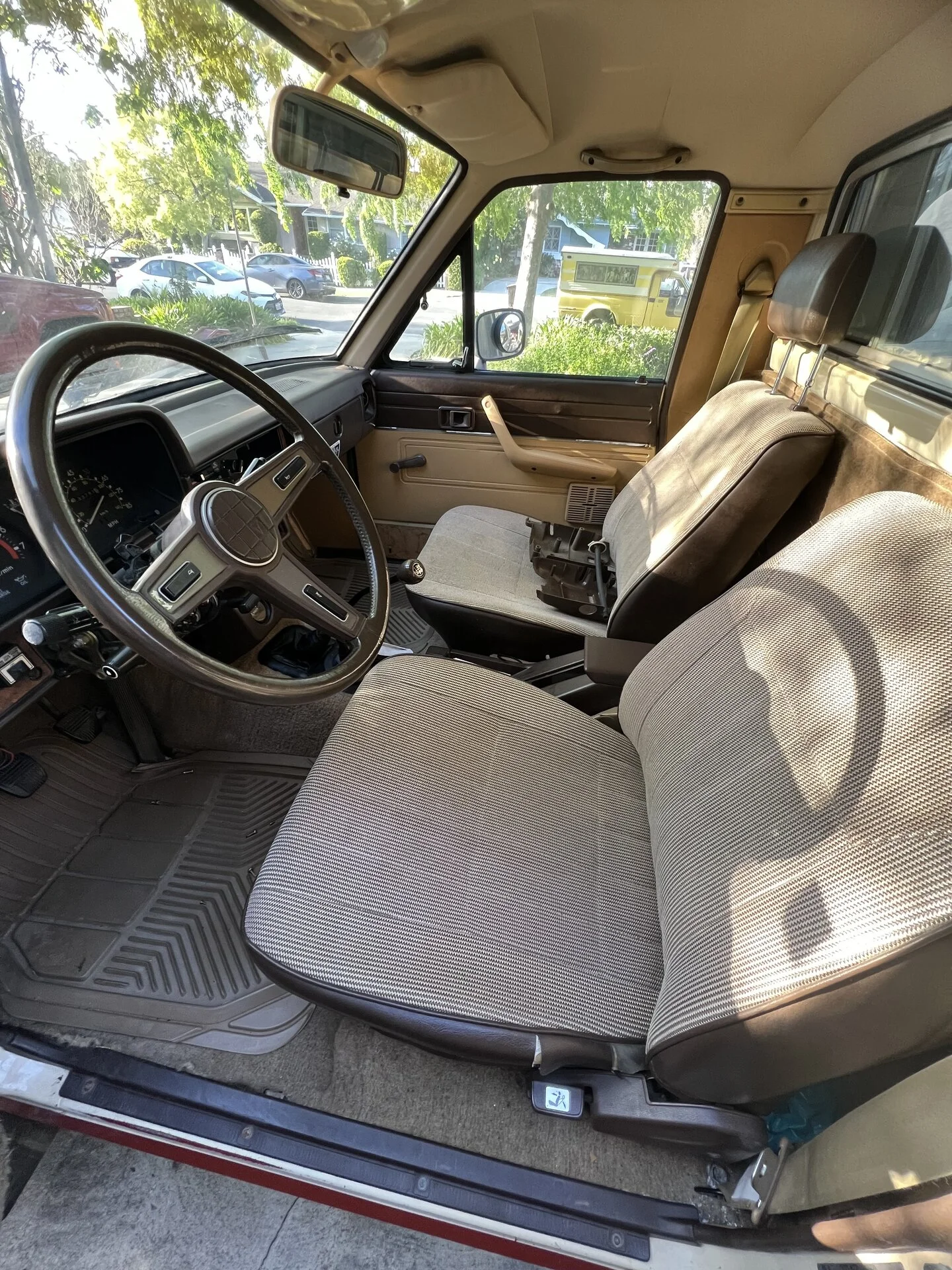

I just picked up this gem.
It will be used for small camping trips, and driving around town.
The Good:
it is a 1983 4x4 SR5 long bed . It even has factory AC
I will be the 3rd owner. I bought it from a friend who intended to build it but has too many projects at the moment.
It has 148k original miles. The interior is mint.
