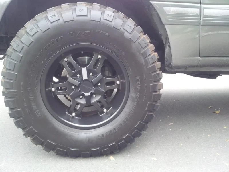

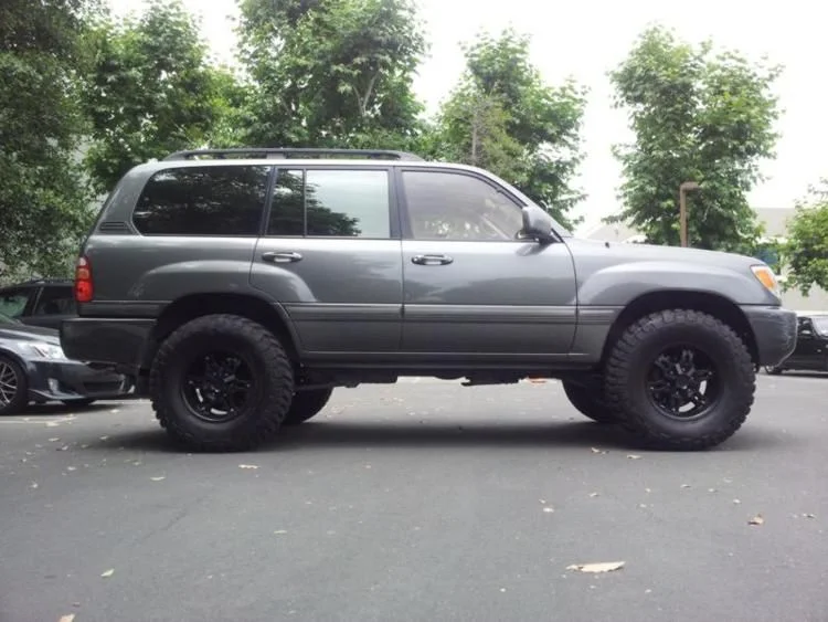

I'm getting quite a bit of rub, not at lock to lock, but in compression on the fender, and so far just in the front.

Or perhaps making my own fender roller using a skateboard wheel for the roller. But I'm not sure I can flare the fender out far enough to cover my tires per the pics of my rig.
Ok. I was waiting for my entire rig to be finished before posting any pics of it, but here are my new wheels and tires to give an idea of my clearance issues.
Read two posts above for the components I have on now.
This is just a sneak peak mind you...

Those tires look huge. I've seen 35s on a 100 but that looks like an Artic truck.... I've wheeled with 100s too and never seen a person have rubbing at the top of the fender. Maybe on some high speed whoops but that's about it. It looks like you will need to take of quite a bit of that pinch weld area behind the tire also...what about the rear? What size bump stops are you using to keep those tires out of the tops of the wheel wells? Those tires look really big!
There was one guy on here that trimmed his fender. I believe he was in OZ...
You have several things factoring into your rubbing issues (wheel width, new wheel offset, oem front bumper, etc.). I know you like those wheels, but man they push those way out! With my stock rims, 295 tires, and 1 1/4" spacers I never came close to being that far out.
The easiest solution would be the 1" body lift and then trimming the fender.
