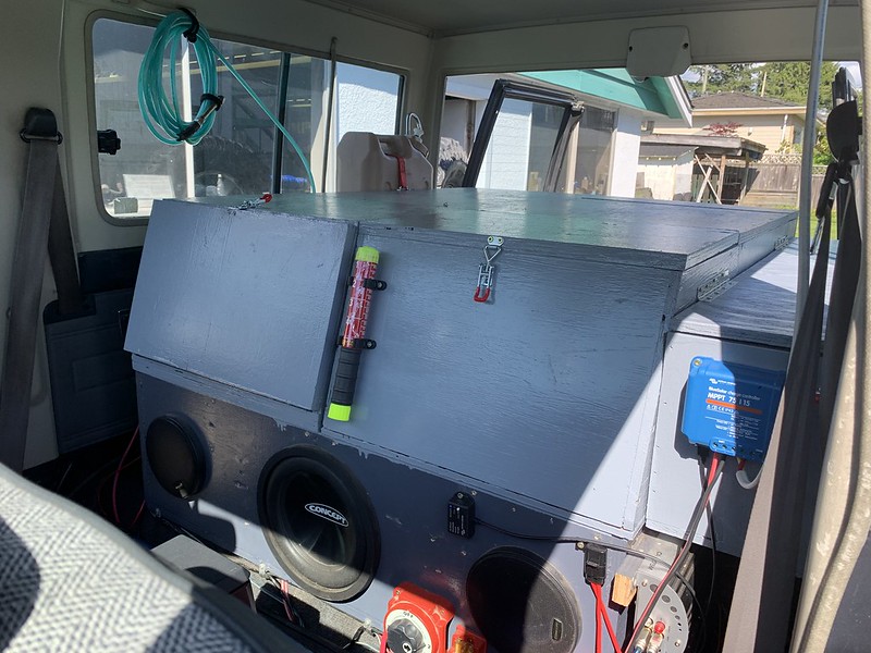

Saw these in another thread for a group buy here on 'mud, and they look pretty good. I was cleaning up my garage over the weekend and realized all my extinguishers (5 of them) are horribly dated.
Think we could drum up similar interest here?
I have one of those in each truck, and could use one more in each.
Form factor is great
And as a bonus they just fit in the clips that hold the emergency flare in your HDJ81. Wish they were a little cheaper though.
