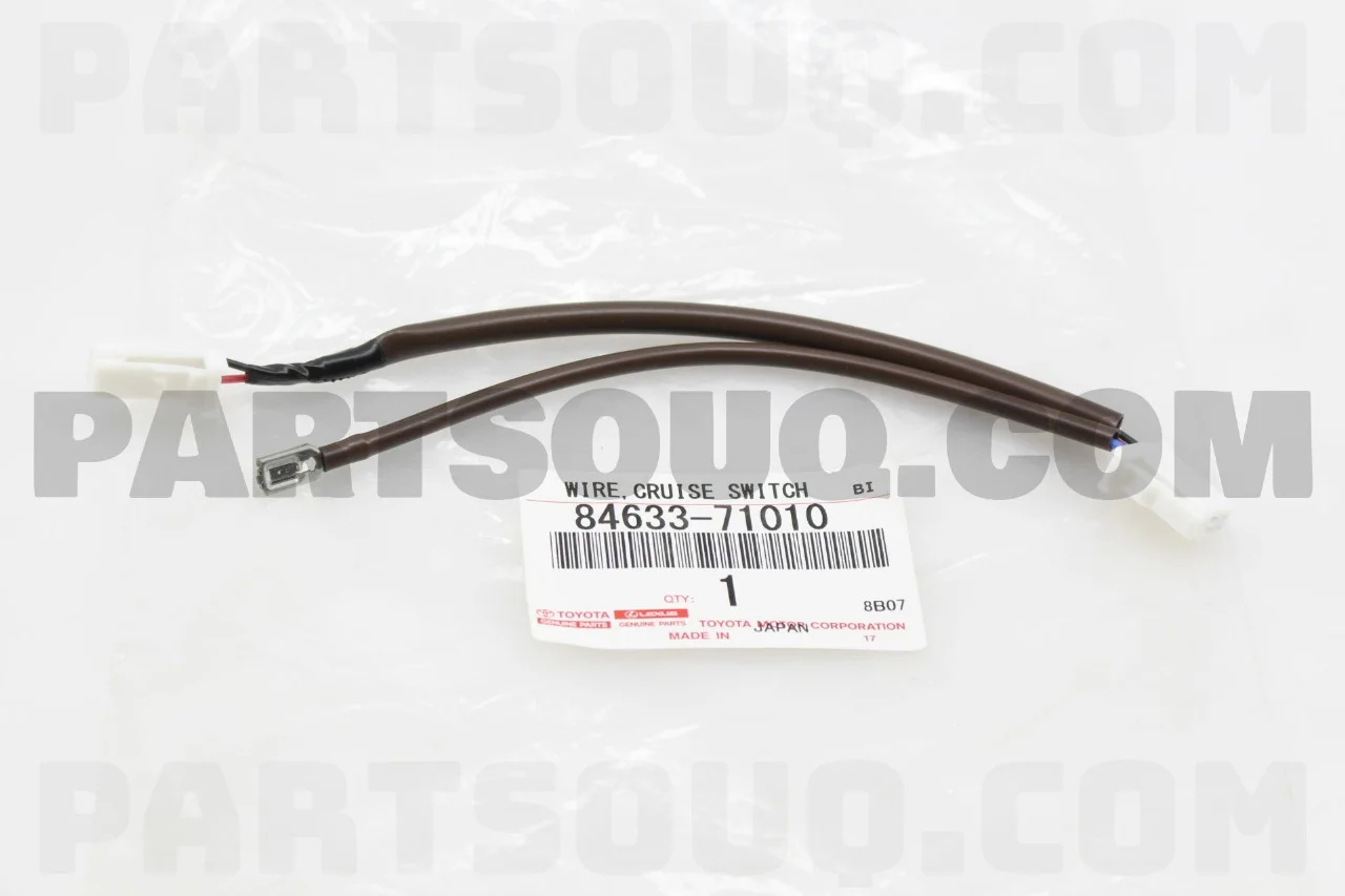

I'm trying to get the factory cruise control to work on my GCC spec Troopy.
So far, I've added the blue wire to the ECU pin 40. I've changed the clock spring to accept the cruise control wire. But the cruise control is not working.
I'm questioning whether the ECU has the drivers for Cruise? The parts catalogues are showing different part numbers for different regions. Could be for emissions and other spec related reasons.
Has anyone tried to make it work? as a retrofit?
I've attached the EWD for the Australian VDJ7x for reference.
