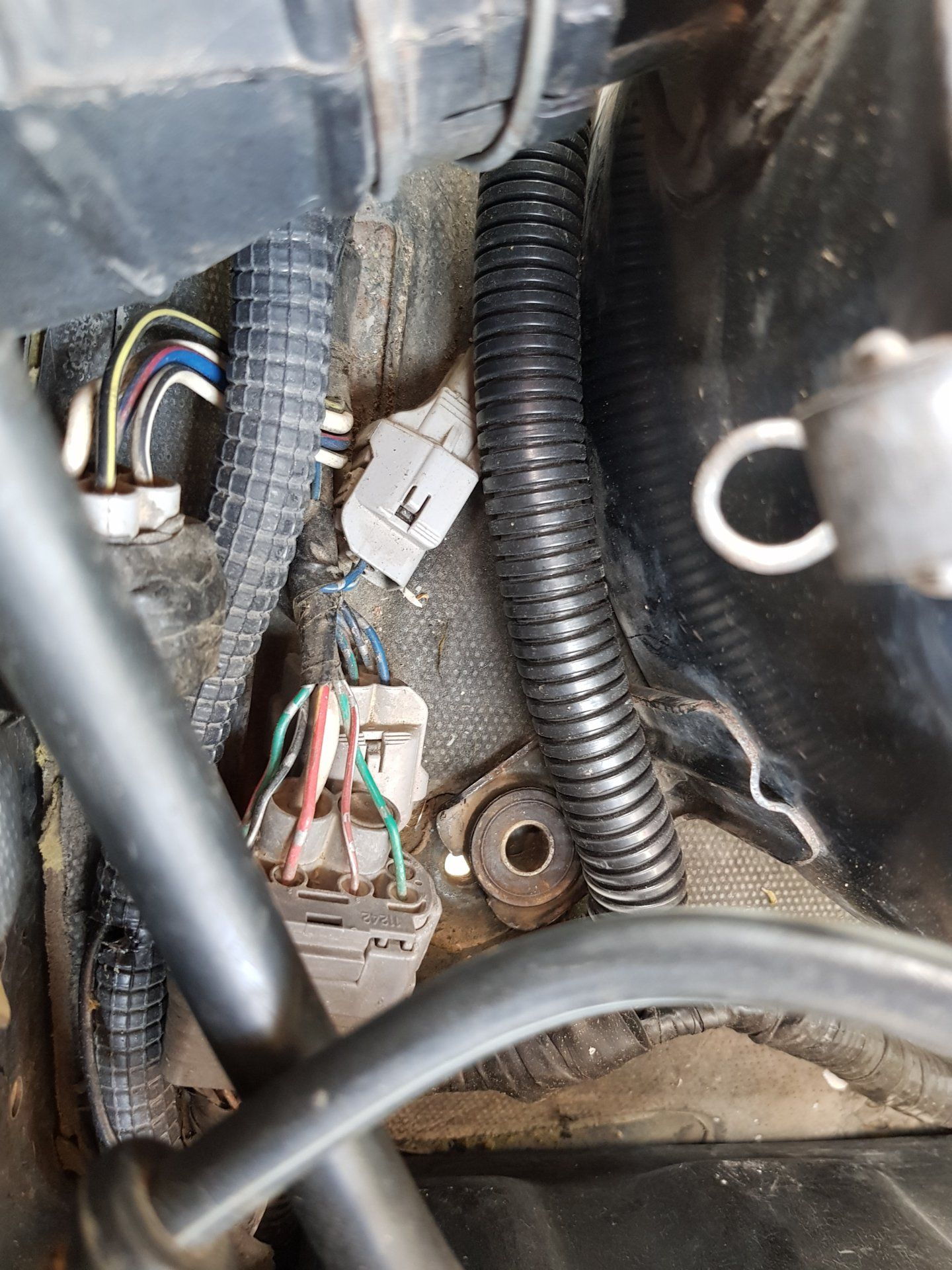

Hey mate could you get a picture for me where the wires from the power assist plug into the loom? Mine are damaged and would like to re connect

I can, but it'll be a while as my truck is not available at the moment :)
I took a quick pic today whilst running some tests before inspection next week.
The cable runs from steering box, under air cleaner, it is the small plug at the top of the picture and connects to the loom right at the junction inner fender/air cleaner/battery box.
