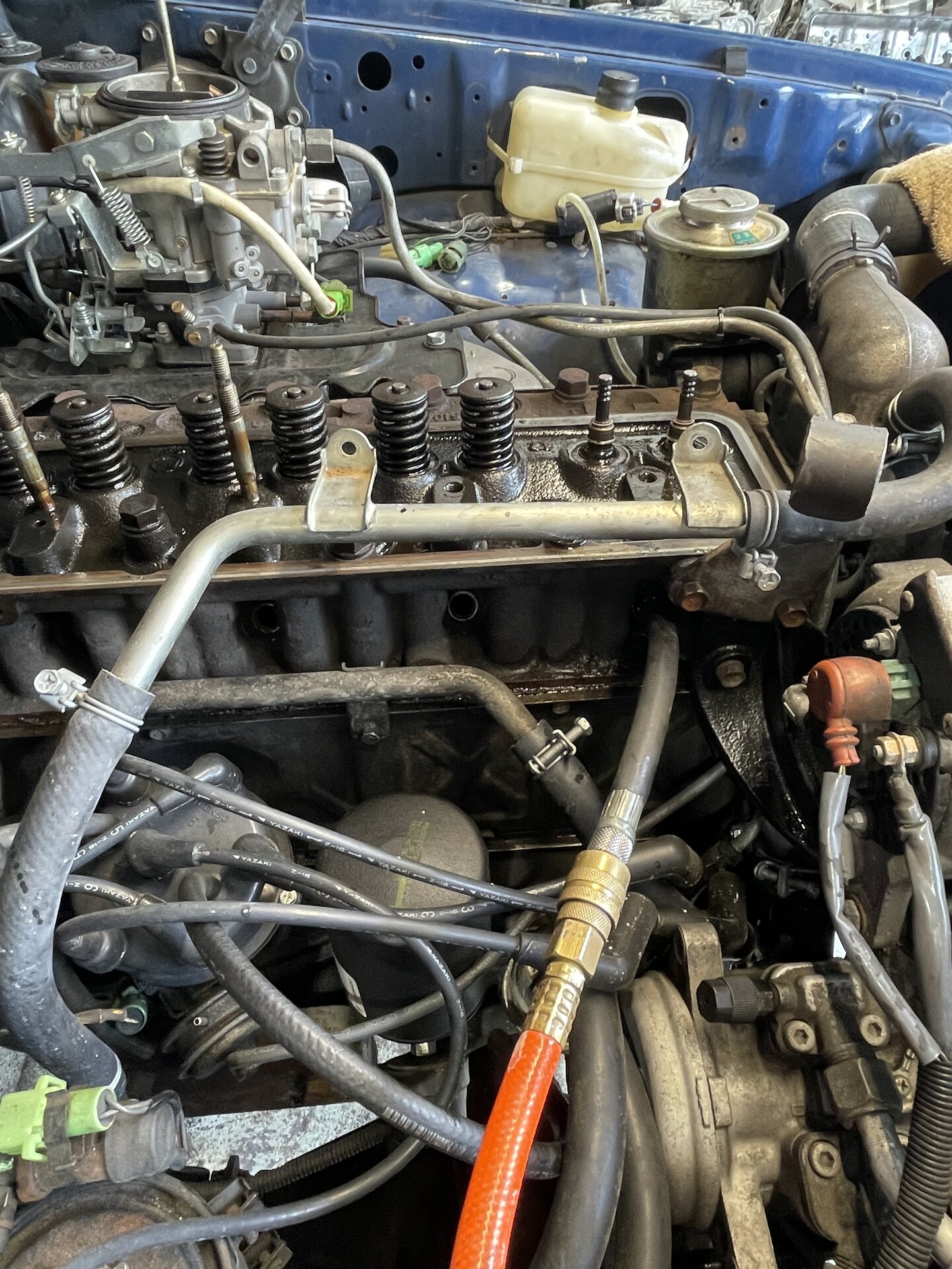

When doing valve springs on a head that’s installed on a block (assuming your cylinder head is still installed on the truck) - hook up a compression tester adapter to your air compressor and put full air pressure in the cylinder. That will hold the valve up while you compress the spring.

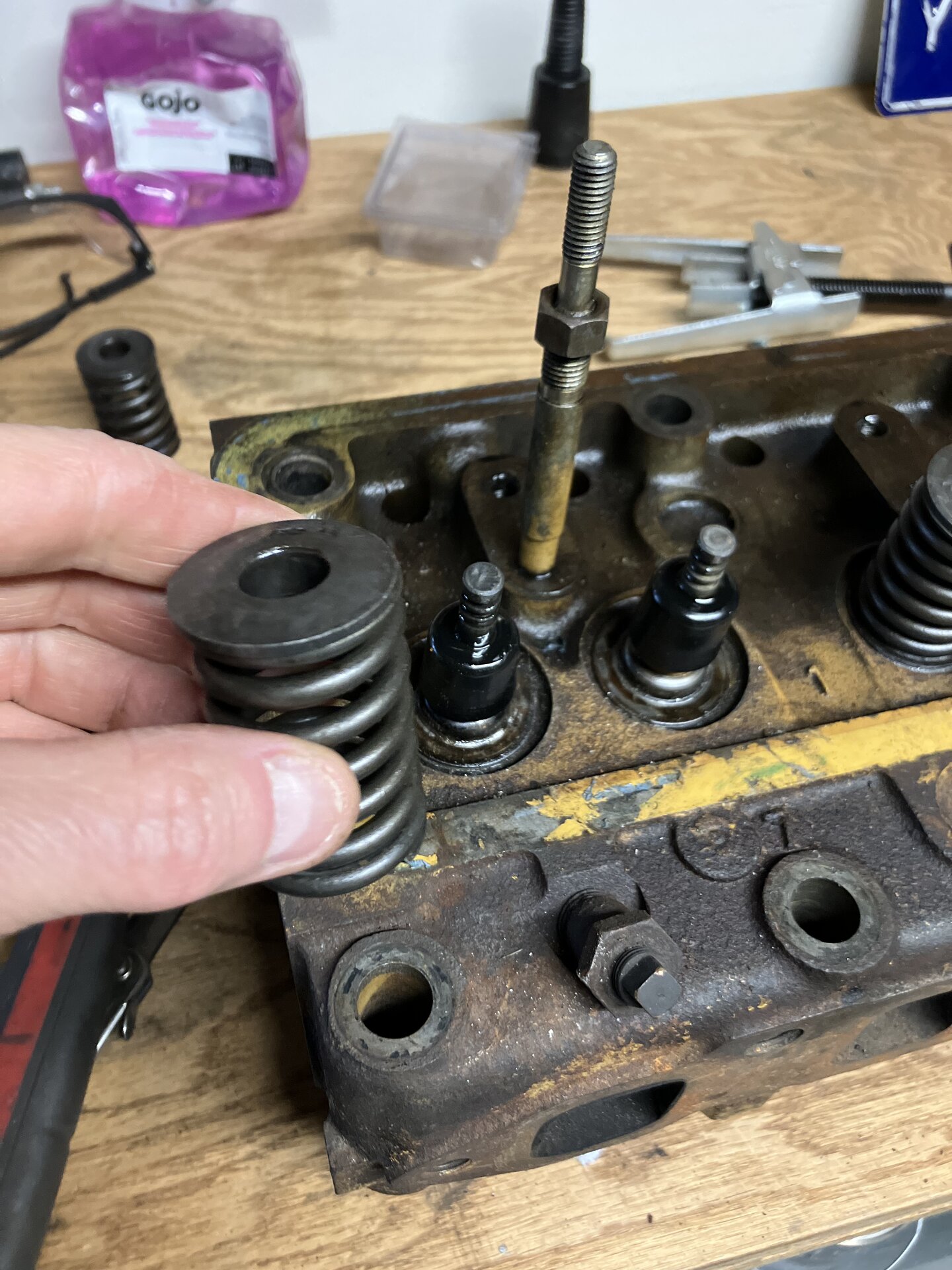

Got the donor springs out of the 2F head
Going to swap in the #4 cylinder tomorrow. My #4 cylinder had very low (20) compression while all others were consistent and normal. The #4 spring is so worn out it spins freely when messing with it. Not at all like the other 11 in the rest of the head (on my 60)

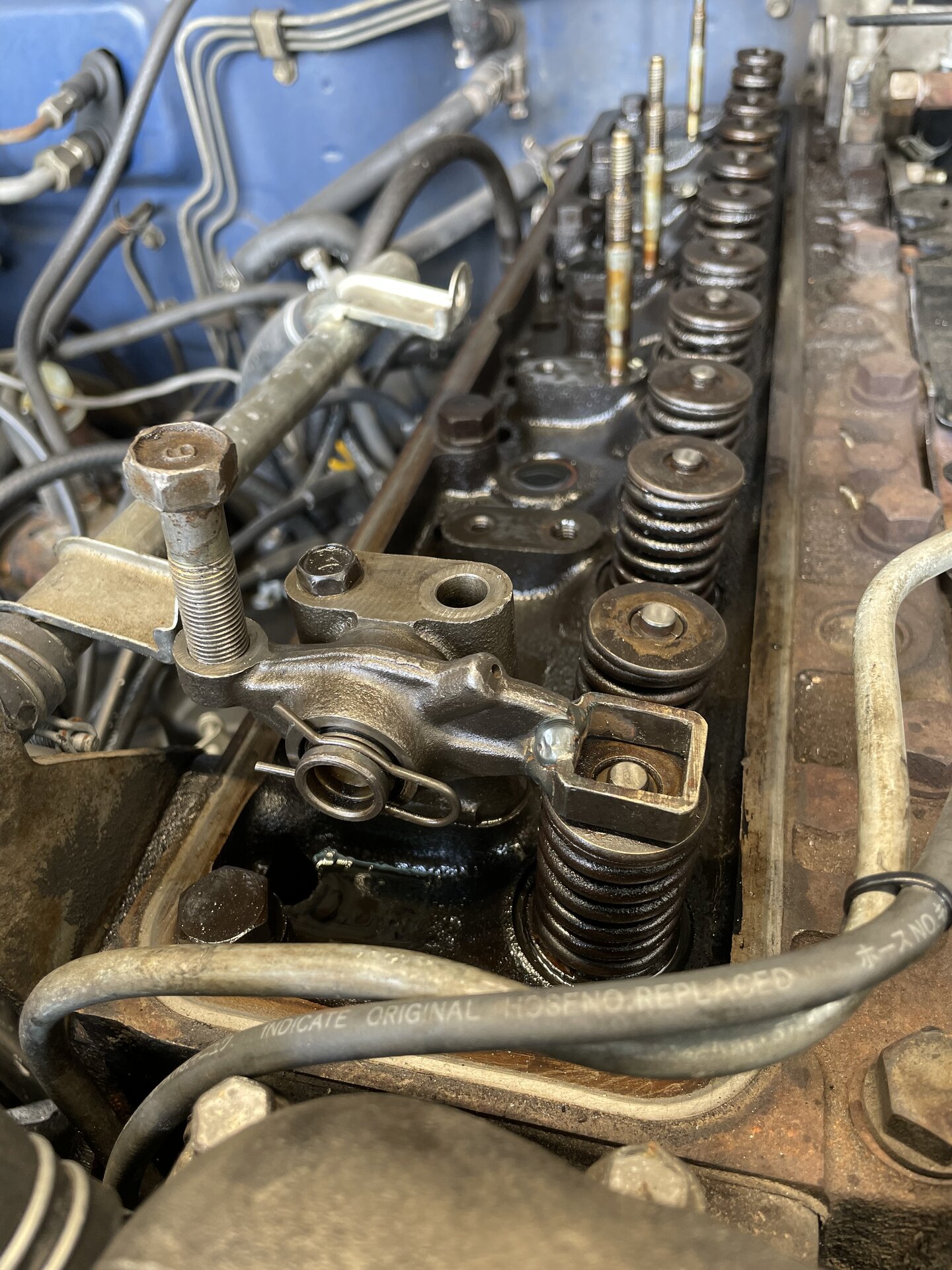

I had a 60 come through my shop for valve stem seals last month (the first time I've done them with engine still in the truck) and I did end up making the tool, will post up some pics of the process here.
Shop air in the cylinder using a compression tester adapter to keep the valves from dropping.
Extra rocker arm, pedestal and cut-down shaft. I cut the end of the rocker arm off and welded some 1” square tube to the end. 1.25” round would be perfect, but that was all I had. Then use whatever various 20-36” bars on the end as a lever. I didn’t weld a handle to the rocker as I wasn’t sure how it was going to work at cyl 5/6 towards the firewall.
Next time I think i am going to cut .25”-.40” off the bottom of the rocker stand since the spring gets kind of crooked when fully compressed
Total job time was about 3 hrs including making the tool.

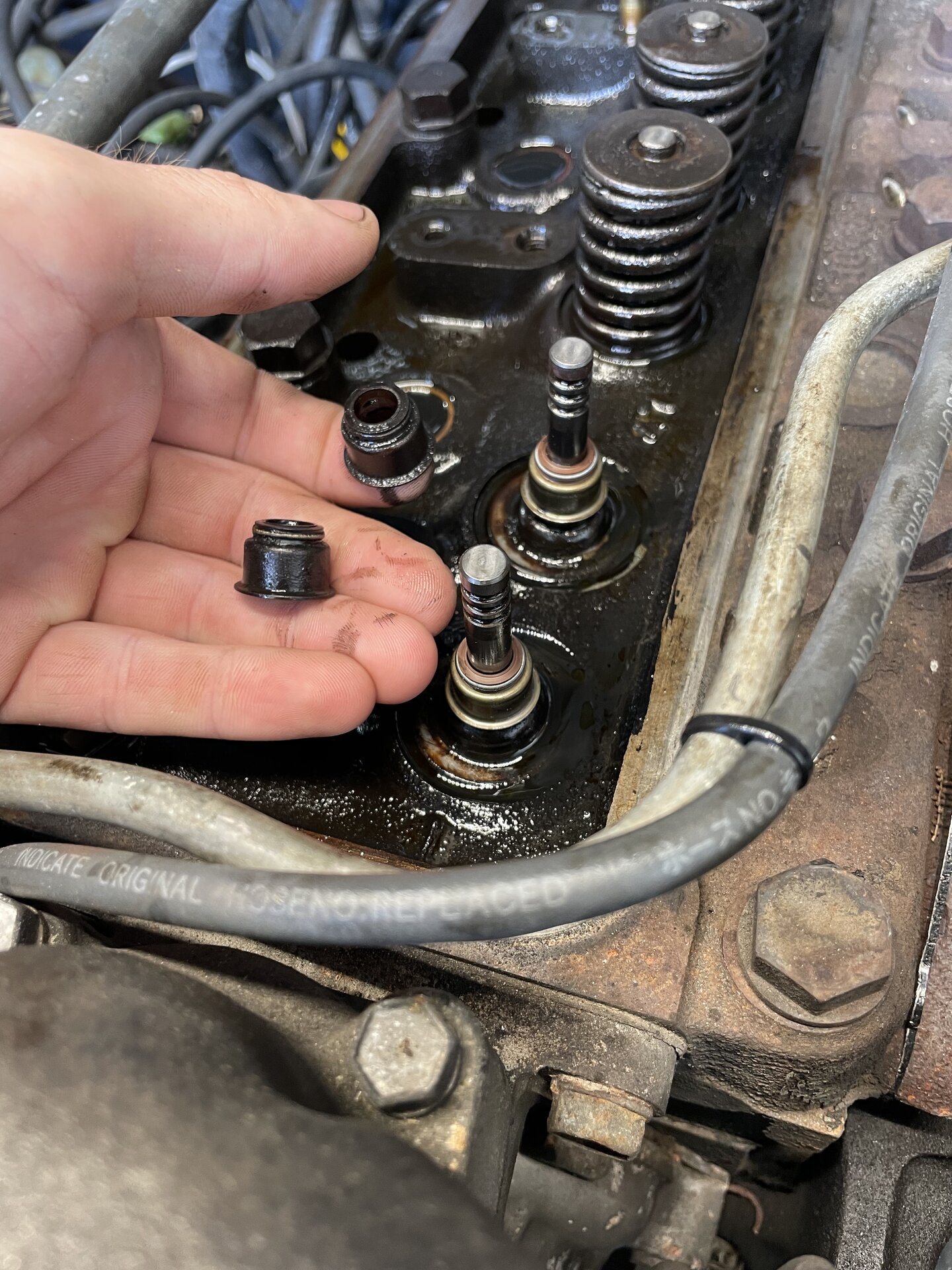

Hey, Matt. A bit of an aged thread, but I'm getting ready to do the valve stem seals on my 60 and I'm curious how you fit the new seals onto the guides. Do they slide on easily or press on? How did you set the depth so the rubber lip doesn't distort? The FSM shows a dimension and tolerance, which makes me think I need to take care how far I push them on. Thanks!
They tap on pretty easily with a 12-point socket (I think 13mm) and a small hammer.
OK, thanks. I assume lightly tap until the bottom of the rubber ring just seats against the top of the valve guide? I may be overthinking this but I don't want to damage the rubber seal by pushing the seal collar down too far.
I did mine about 2 years ago. Just tap the socket on the seal until you feel it's solid. You'll know it once it fully seats on the guide.
