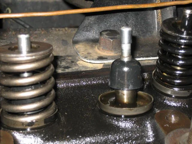

Changed the F135 valve stem seals from O-ring to umbrella type. I had a little smoke after a long idle or on a warm start.....................smoke is gone. :)
Used Fel-Pro SS72616 umbrella seals, these are for Ford 170, 200, 250 six cylinders. The inner valve spring on the Cruiser was to small for the umbrella, I was going to pitch the inner spring, but didn't want to risk valve float at high rpm's...............:D

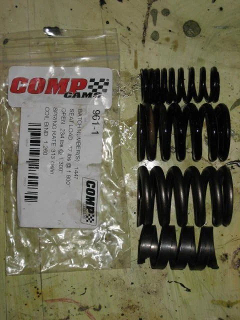

So I ordered up some new valve springs, I used Comp Cams 961, and pulled the dampener. Here's the stock spring next to new spring.

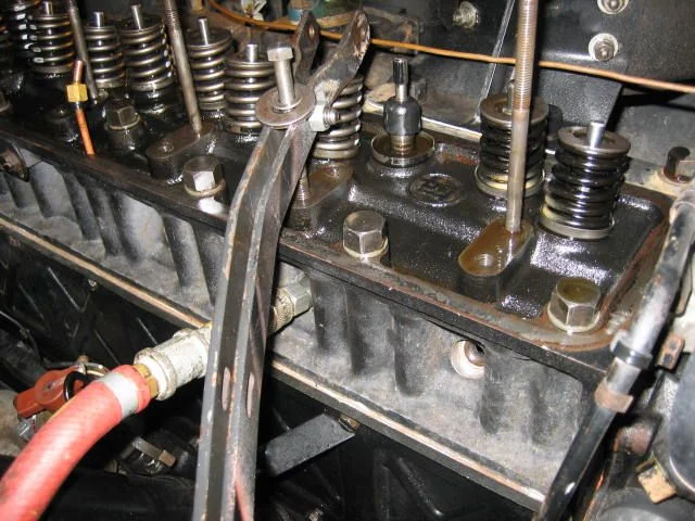

And the homemade valve spring compressor. Make sure the cylinder is at TDC, put it in 4th gear and set the parking brake, put air to the cylinder. My tool takes about four hands to use, but it's better than pulling the head. :crybaby:

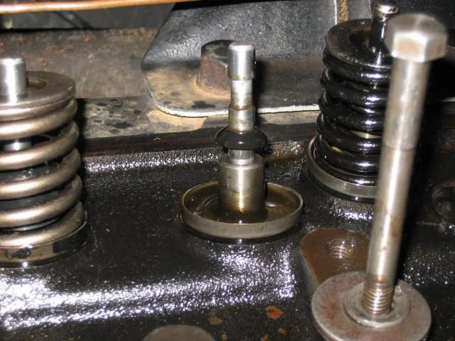

The O-ring is a misleading name. Neither of these are positive seals, they count on shedding the oil away from the valve stem. You can see the O-ring is more like a canopy where the oil runs off but can still splash right on the top of the guide. The Umbrella is more like a tent it gives more protection since it covers the top of the guide.

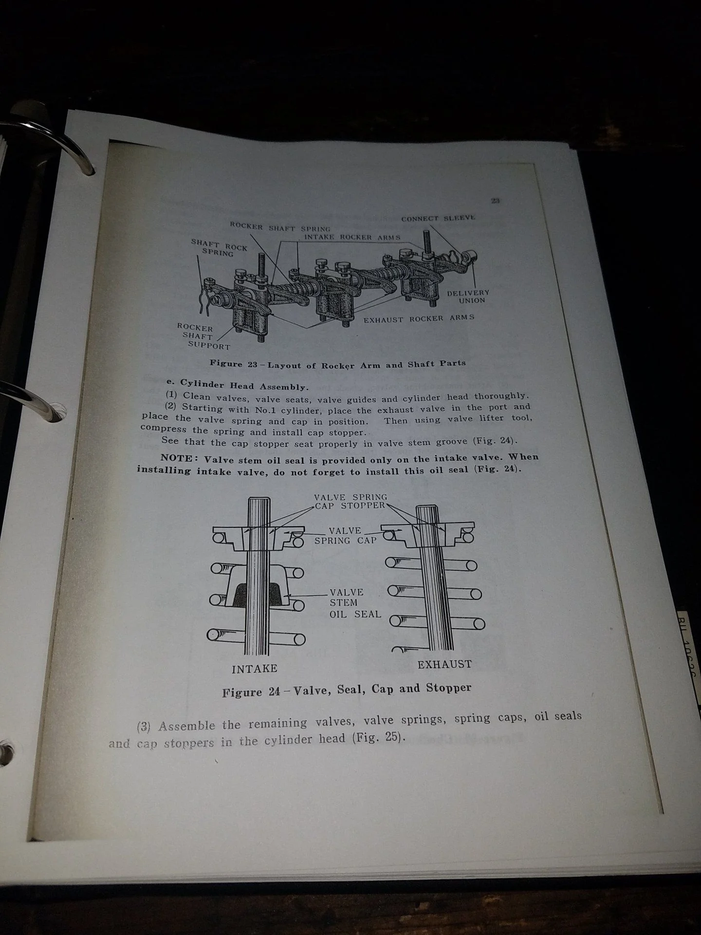

And since you might get a laugh out of it, the page from the early FJ25 manual:
No way I get a laugh out of any manual, esp. one of the early ones! That is awesome Jim, thanks for sharing. BTW, since you’ve at least had your engine partially apart (maybe completely) you are an engine expert!
So what motor are they referring to in that manual? If it’s an F135, there’s a disagreement between that an the F-engine repair manual on construct (e.g. one vs. two springs, o-ring vs. umbrella seal). If it’s an F120 or something else, I’m even more ignorant about them - and I’m pretty ignorant on the 135’s, 😂.

Regarding the manual, the would have been for an F120. I do not put much faith in any early Toyota drawings, they are more often more art than technical drawings.

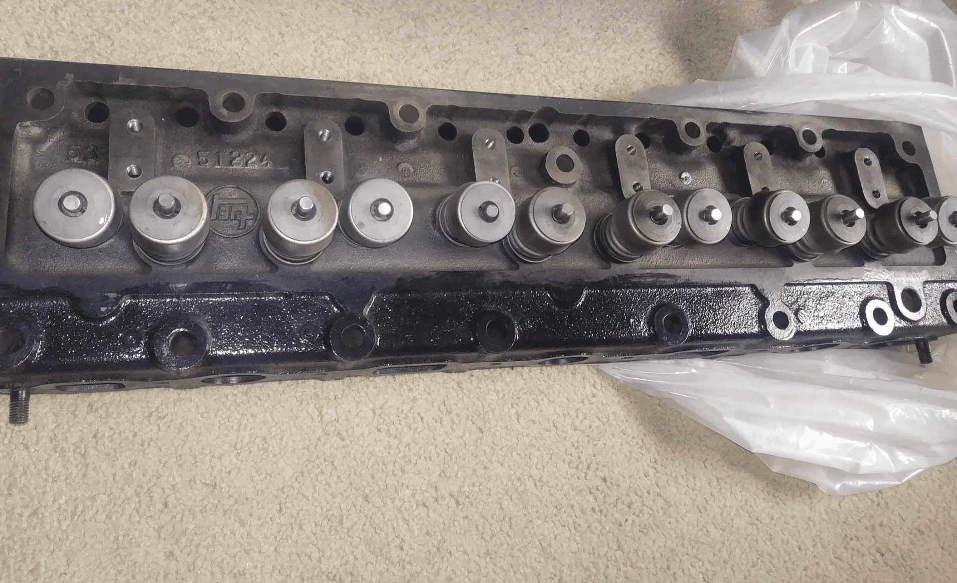

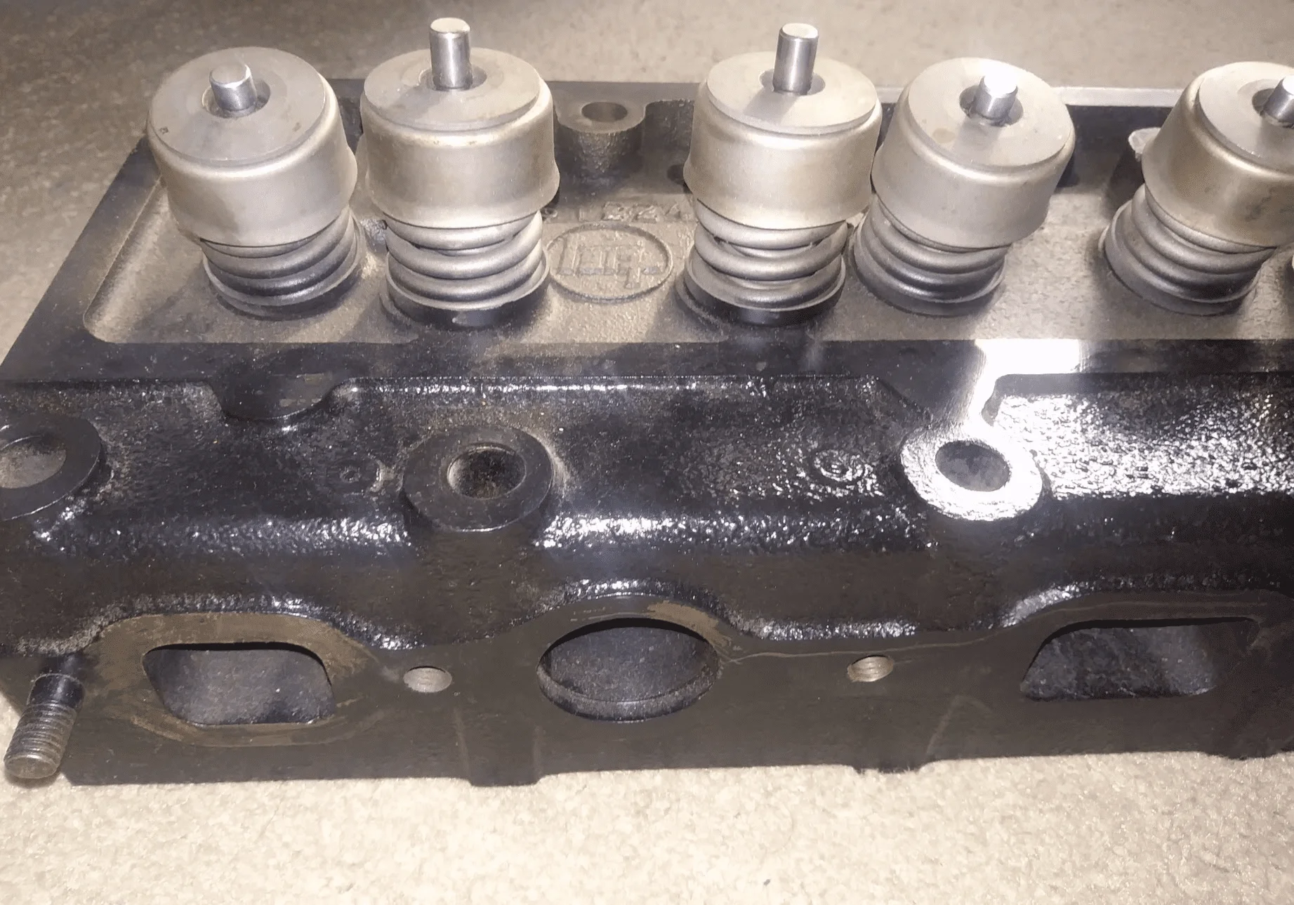

The FJ25 manual‘s depiction of the valve setup in Fig. 24 looks exactly like the valve setup in my 40201 stamped head (block is stamped 040207, so very likely a match, pics here Picture of valve) for all components: single spring, valve stem oil seal, valve spring cap and stopper with no other seal or groove for one. If yours is a late 64 stamped head then it looks like the dual spring, oil shield and o-ring oil seal transitioned in sometime in ‘64. But I don’t see any oil shields on yours, and the oil seal o-ring is below, not in a groove above the spring cap, so maybe there’s even another transition between mid-64 and late ‘65 like @Citrus Cruiser ‘s :
The FJ25 manual‘s depiction of the valve setup in Fig. 24 looks exactly like the valve setup in my 40201 stamped head (block is stamped 040207, so very likely a match) for all components: single spring, valve stem oil seal, valve spring cap and stopper with no other seal or groove for one. If yours is a late 64 stamped head then it looks like the dual spring, oil shield and o-ring oil seal transitioned in sometime in ‘64. But I don’t see any oil shields on yours, and the oil seal o-ring is below, not in a groove above the spring cap, so maybe there’s even another transition between mid-64 and late ‘65 like @Citrus Cruiser ‘s :
