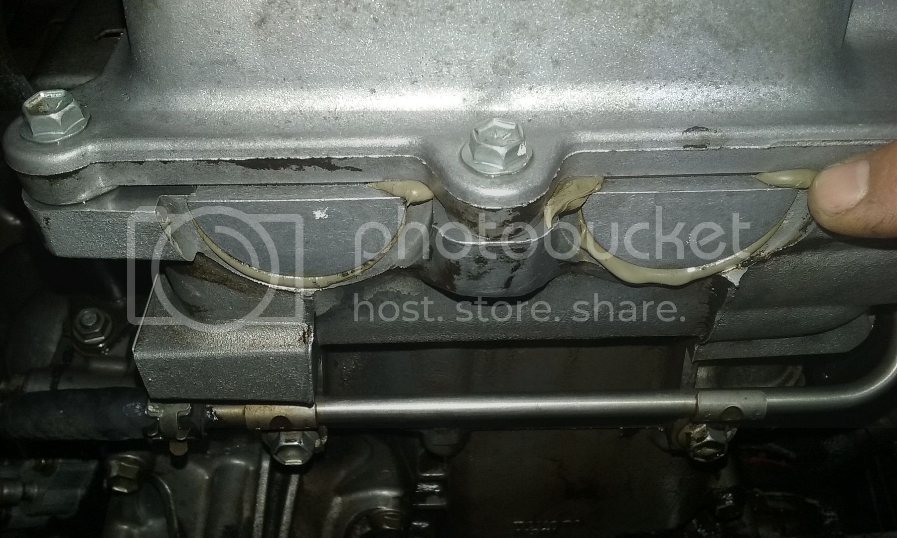

Getting ready to do the Valve cover gasket tomorrow. 97 FZJ80, 1FZ-FE
Just looking at the gasket I do not see the two rounded keyed areas on the front of the engine that on my cruiser look like FIPG as in the picture below.
It seems that this is one of the areas where I am seeping a little oil.. So is this just Toyota FIPG, I am headed to the dealer in the morning to pickup my oil pump gasket as well so should I pickup a tube of FIPG ? :hmm: It seems pretty obious but it does not hurt to ask. :idea:
The two half rounds are separate from the valve cover seal. They are aluminum and will require sealant. Toyota foot is never a requirement as permatex will work fine. To remove these, place a brass or aluminum drift to one end of the top surface the. Tap firmly on the drift until the half round rotates up and out.
If they are not leaking (appears they are not) don't mess with them. Just replace valve cover gasket.
I would use a new razor blade to clean off FIPG where Valve cover seal will sit.

Thanks guys... They do look clean because I de-greased everything prior to trying to do the valve cover gasket today and my master plan of doing the crank seal and oil pump + Dizzy O-ring...

I believe that gray is the factory sealant. I only say this because both of my motors had it before I opened them up. And i'm pretty sure the same thing can be found around the oil pans, but its been awhile since i've been that deep. Either way they come out easy and can just be resealed with some black permatex.
@Manuelsv you can also use a bit of permatex to tack the VC gasket in place before the install. They can drop down, especially in the back while you are trying to seat the cover. This can lead to a bad seal and you will be leaking again in short order. I think the biggest problem with these leaking is the VC bolts don't torque down very tight. I have done 3 in the last two years and all but the very last one is leaking again. Every time I notice it leaking its because several of the bolts loosened up. This last one I actually ran a very thin bead of permatex all the way around the bottom of the seal where it will meet with the head. Hopefully that will keep it sealed longer.
