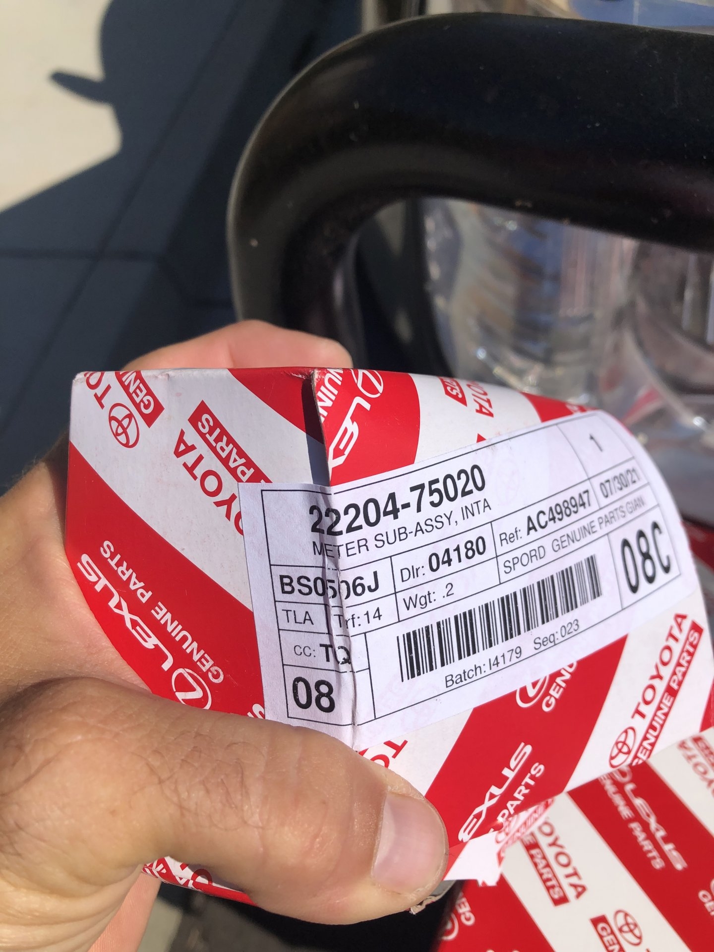

New MAF sensor in. No change.

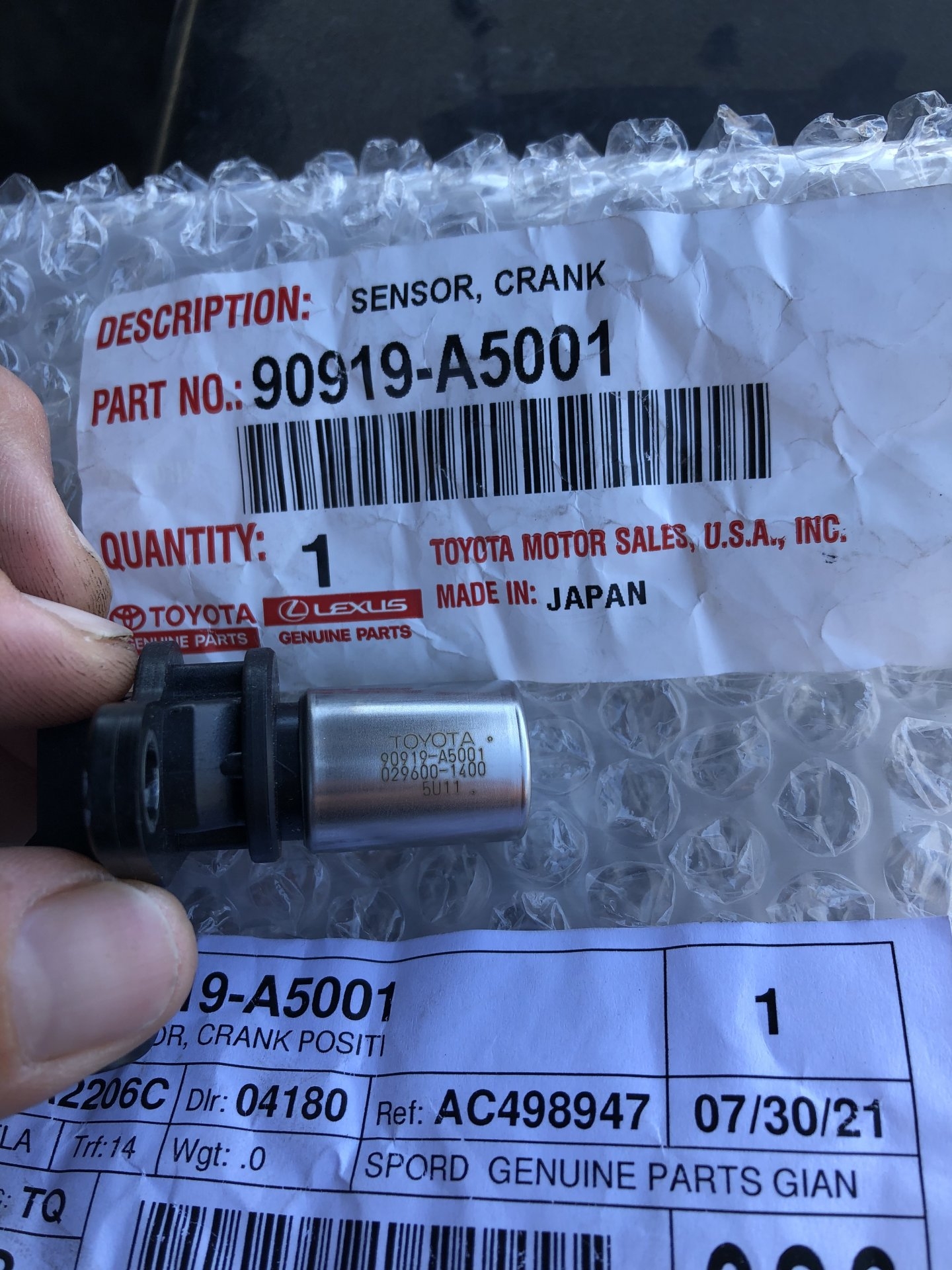

I believe this is the crank sensor, but the plug orientation is wrong. Can someone confirm 1) that is in fact the crank sensor location? and 2) is that the correct new sensor PN?

Nic...here is where the crank position sensor is.
Right PN, wrong location. Its at the front of the engine, DS of the oil pump cover.
By my research of parts diagrams it is a transmission location sensor.
