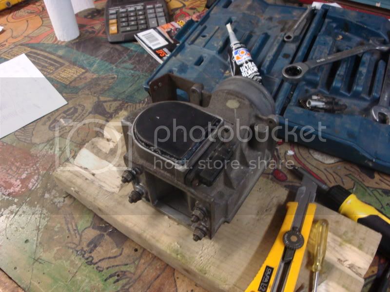

Well, I got everything disconnected for the 2nd time today.
Got the VAF out and ended up losing one of the spacers that sit on the studs behind the air box flange. Managed to fab up a new one out of a small bolt but still spent 25 minutes searching the drive way...... Otherwise everything went smooth.
Before bagging up the intake/VAF plug/air box for the night I started it up and it ran......for about 3 seconds then promptly shut off. This was a good thing since the threads Ive read say that is what should happen w the VAF disconnected.

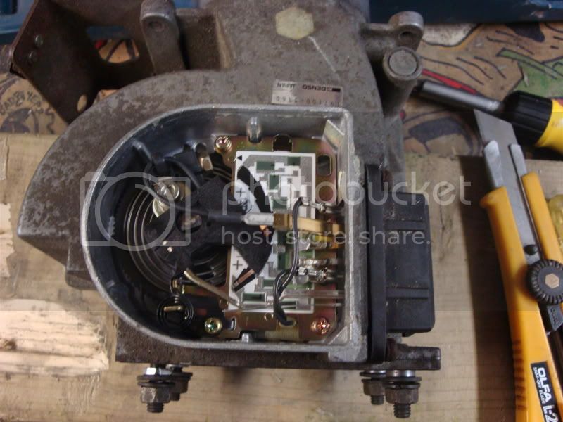

I got the plastic cover off by first cutting the silicone w a utility knife then scraping/prying it out w a small flat screw driver. Not a hard job at all.
Inside I found that by unscrewing the plug screws partially I could pinpoint the loose connections. These are the 3 flat pins in the pictures. One is obscured by the bottom black wire terminal. The pins have some kind of thin flat strips coming off of them and one of mine (middle) seems to be a little twisted. Ill have to carefully twist it back into shape so it doesnt make contact w any of the other connections.
Plastic cover
Cover off
All the **** inside

Well, I messed it up at about 11am and got her goin at 10:15pm. Peetie came over and managed to solder the 3 points back to the circuit board thing. He was like a ninja man.
He did delete the thin little strips that apparently did nothing in order to access the pins..... Otherwise its just like it was before. Hooked everything back up and the van came to life. No hesitation, no prolonged cranking, just fired right up.
