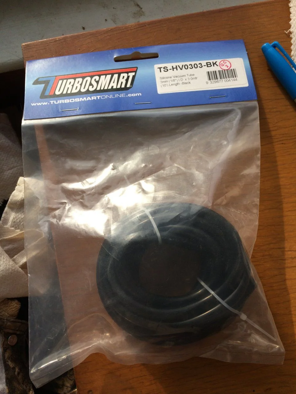

Hilarious. How many mudders does it take to make one sentence understood. @nigrainger the hose I HAVE available is one package of BLACK 3mm 10 feet worth. It's still in the package and I'll send it to you for the cost of shipping. I chose to go w/ blue for my truck.
It's from summit and is just sitting around collecting dust. Lmk. If no it's cool, just putting it out there.

If your looking to go w/ black line I do have a new pkg of 10' 3mm.

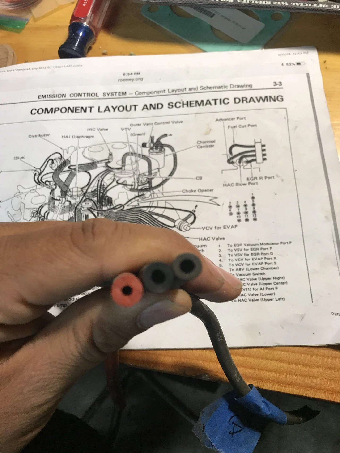

Question... Which one of these hoses should I use or none?
I got the orange one from McMaster car, it’s 3mm ID. I got the new black one in the middle from Napa and it’s 4mm ID. The old hose which I’m replacing is in on the right and appears to be the exact same as The Napa. Go with the 4mm from Napa?
3.5 is OEM right?
Thanks.
