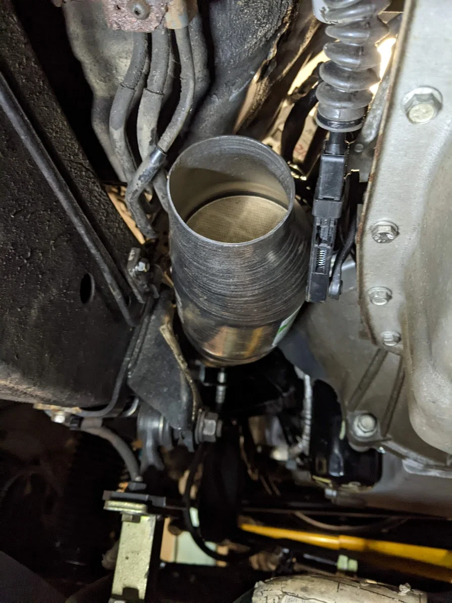

I am in the middle of it now. Here is the passenger side cat. First picture is with the driveshaft raised to check for clearance issues.
Driver's side cat.
I will probably have to shield the gas lines, brake lines, and the transmission shifter.
I am using MagnaFlow Universal Spun Catalytic Converters ( 54906 ), which have an offset. They can be rotated for best fitment. I am not sure they will be enough cat to get the job done but it is a start.
