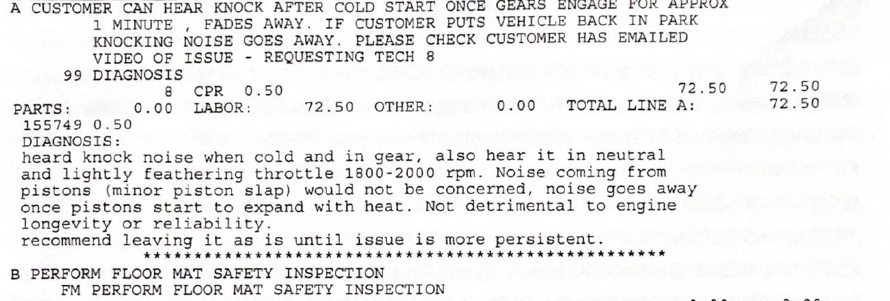

Well, sort of.
2001LC is right, that's a piston slap, which happens on some 2UZ engines. I went to a local Toyota Dealership, where we have our local Land Cruiser specialist. His response below.
I changed the oil couple times to flush the engine, used BG EPR cleaner on last change and tried 0W-40 Mobil 1 instead of 5W-30. And then cleaned MAF, throttle body, greased drive shafts and pumped up tires a bit. After these measures knock not as pronounced, but still there.
