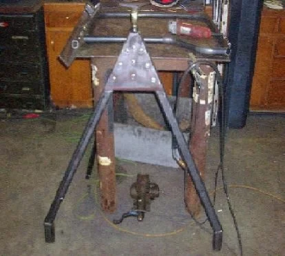

this is the swing arm i am using on my fj55
attachment.php
