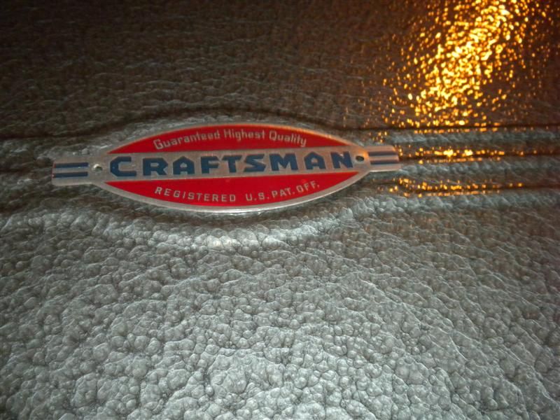

Using hammerite rust cap results and pic.

I used spray bombs on the drawers and rolled the main box.
