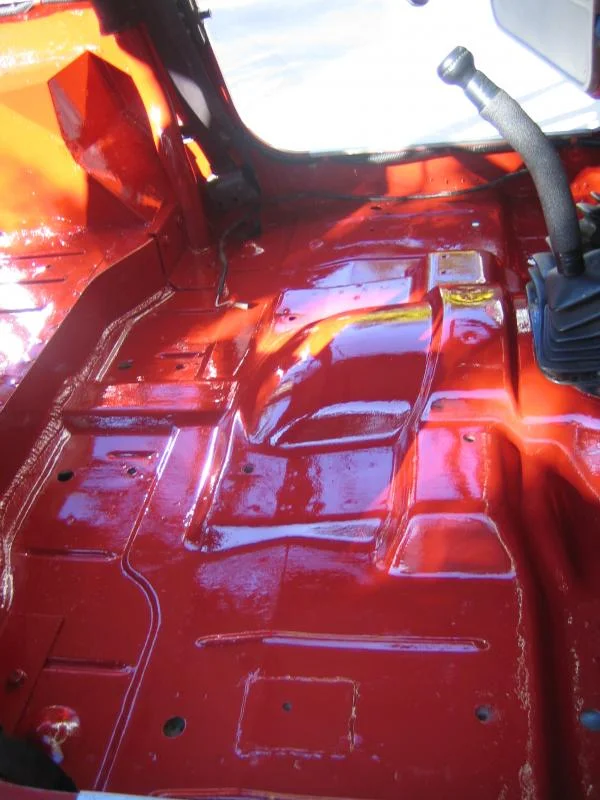

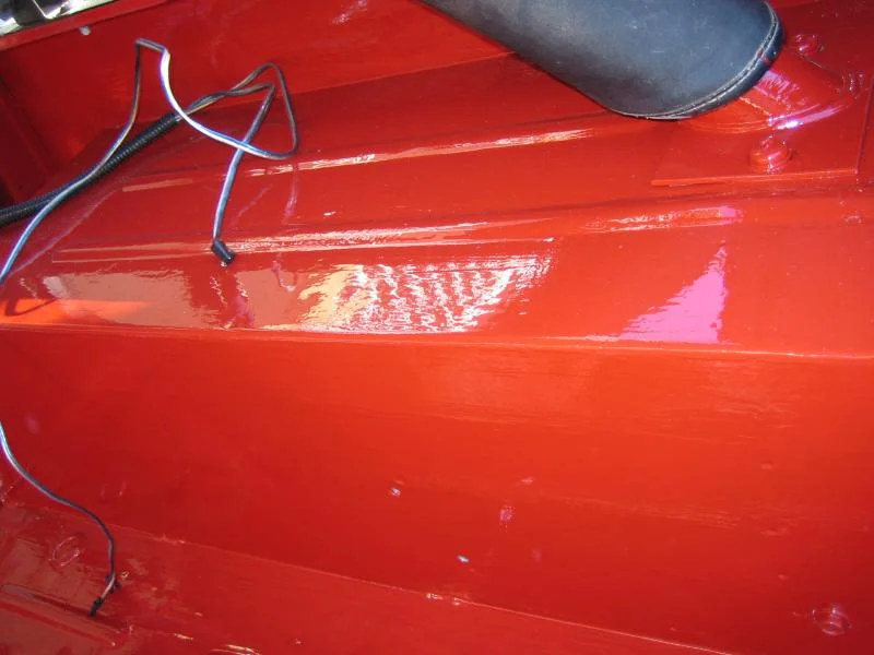

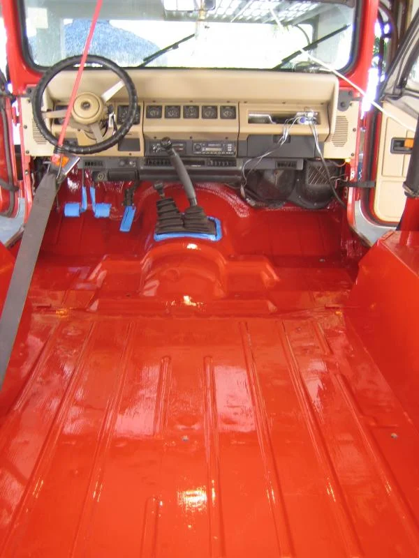

I just finished using rust cap hammerite coating the entire floor of my jeep, (practice and expermenting before using it on the FJ40)
I liked the result, shinny, slick, hard, but not real glassy smooth.
Some of you might want to consider this insead of the black rubber liner crap that is hard to clean. If you are not picky about small brush stokes. But super easy to keep clean. 3 pictures of the result and product, of which I have no affilation with. Thanks.

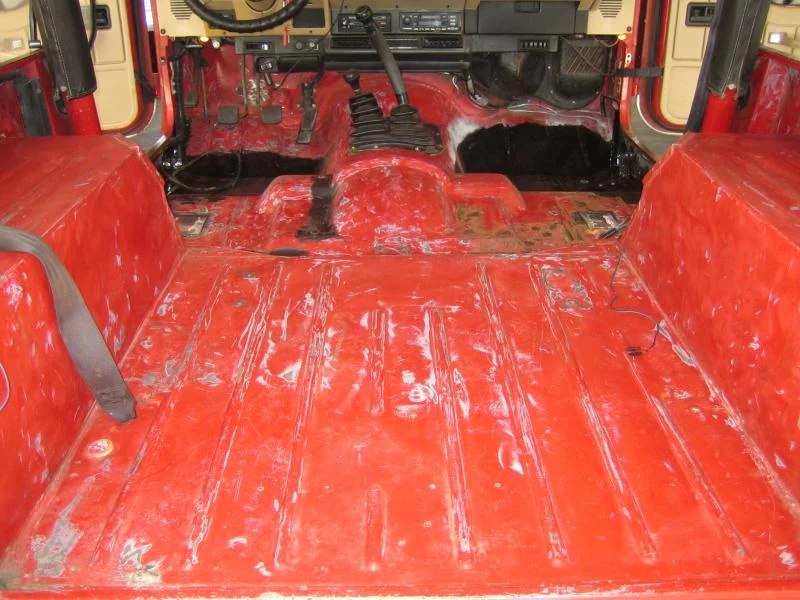

surface prep
Here is a picture of the surface prep the black on the front floorboards is por 15. Had to replace some metal, so I coated it with por 15 until I could give the entire interior a coat of the rust cap hammerite,second picture is finsihed productIMG_2365.webp
