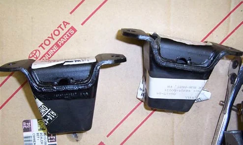

There is a metal bump stop in the rear. Do all have metal bumpstop in the rear?

Your rear axle bump stops (mounted to the frame) should have a metal base and a rubber bumper that contacts the axle housing on full compression.
The 93's and early 94's got the same style bump stops above the front axle. All other years have nothing up front (other than the snubbers inside the front coil springs.)

THe rears have a metal block, no rubber.
I didn't even see holes where the rubber would mount to it.

Here is a pic of the bumpstops off a FJ62. Yours should basically look like these.
Bad things can happen if your rubber is missing! I'm sorry to hear that you were practicing unsafe axle movement.

The front bump stops will look like the pics posted by Photoman. The rears are shorter and the metal plate on the bottom (top?) is completely flat.
