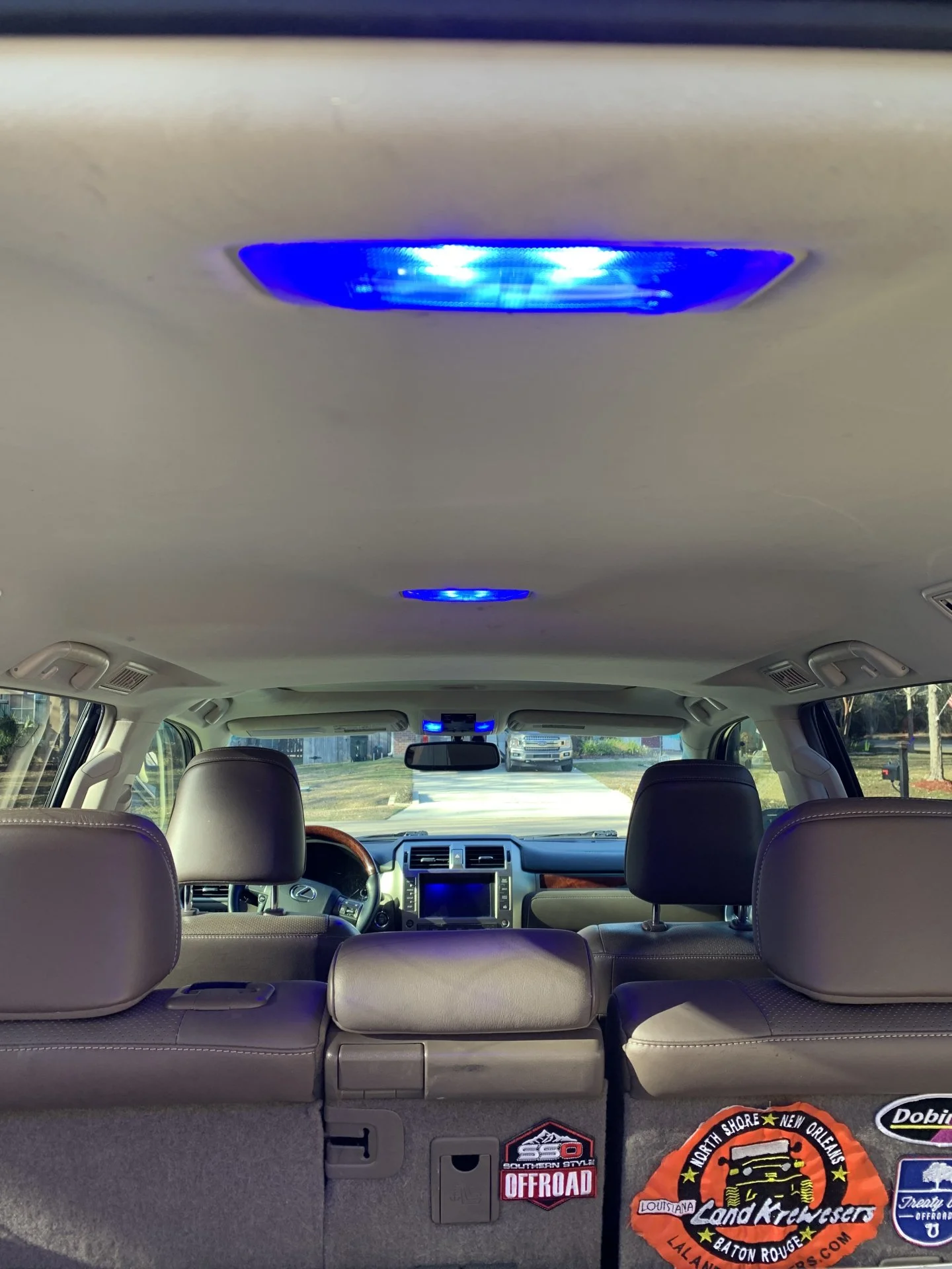

First off, congrats! For the interior bulbs I just bought T-10 bulbs and the fit all the overhead domes and the running board lights. I forgot about the ones in the door panels but they should be the same as well. You likely wouldn't like my choice of color however, because I went BLUE! Some friends were giving me a hard time about it yesterday asking if I thought I was at a club and ready to go dancing. :rofl:

Nah. I bought a s*** ton of them on Amazon because they were available. But just to show you……. Can you here the techno music? Is dub step still a thing? 😂😂
