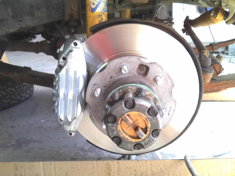

Here we go:
I finished the 4Runner conversion yesterday (calipers and 15/16" M/C on old BB).
After disassembling the hub i noticed a shot oil seal and a missing claw washer what forced me to get new parts yesterday morning :bang:
After bleeding the system three times (calipers, drums and LSPV - M/C one time at first, no leaks) the pedal still feels terrible.
There is no brake response for about 50% of the brake pedal travel and less braking power than before :frown:
You can pump it up to better feeling, but just for a very short time.
I think there is still air in the system and i have to bleed it by a pro to get the full braking performance.
Anyway, thanks for your help :) :clap:
Often after lots of pumping and bleeding of the brakes the air in the system brakes down into tiny Champagne type bubbles spread through out the system. Give it a chance to sit and let the air settle back into larger bubbles and then try bleeding it again. I've seen lots of people give multiple pumps on the pedal before cracking the bleeder which just adds to the problem
Thanks for this tip :)
Problem solved :bounce::bounce2::bounce::bounce2:
I cleaned and re-adjusted the rear drums and bleeded the whole system again.
I used an old bicycle inner tube on the brake master cylinder reservoir and put some pressure on it instead of pumping the pedal.
Now the brakes feel nice and safe again and it stops pretty good so far. :grinpimp:
