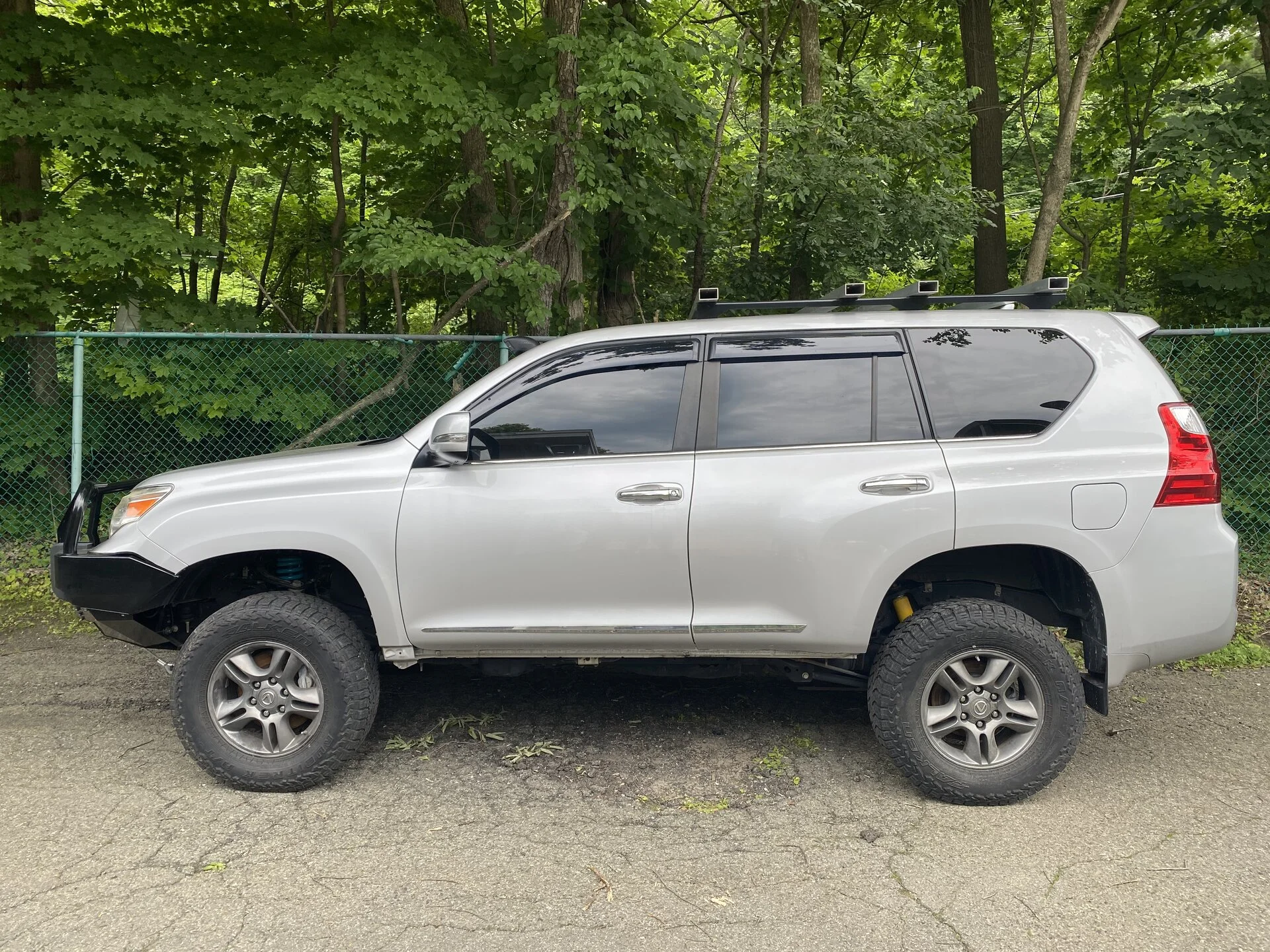

I have Dobinson rear springs in right now: C59-677V, supposedly for 3” of lift with (not sure how much exactly) weight in the back, I also think they are “long travel”.
When I put them in, without any extra weight, they pushed the rear end up to 4” of lift.
I havnt measured the lift height in a while, I should check to see if they have settled. The ride is pretty harsh, especially since I havnt built a rear bumper yet, and since taking out the third row seats the rear end is even lighter, hoping more weight improves the ride quality.
Also as a PSA, don’t know if you are swapping the coils yourself but they were a pain to get in, could be I went too big and stiff but I battled for a while trying to compress them enough to fit in, they were a solid 6” bigger than the last Dobinson coils I had in there.

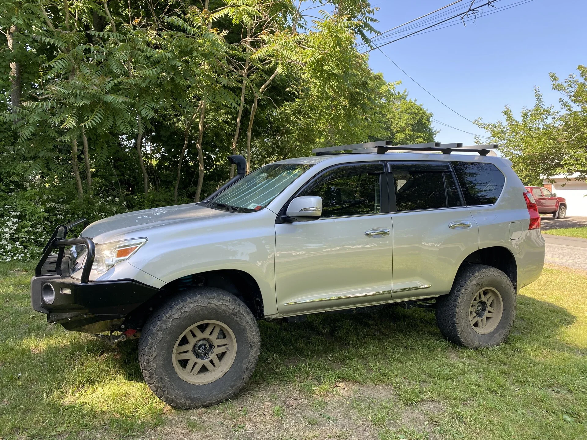

Thanks, I'll look into those. My rear shocks are King 2.5 (KRS-25001-125A-EXT) hopfully that won't be an issue with "Dobinsons C59-677V can be used with KDSS, as long as you don’t run long travel shocks, as the sway bar will contact the panhard rod at full extension, leading to problems." . Instead of experimenting, I like the adjustability of the Eibach coils, but Dobinson looks like the way to go if I can stay around the range of 2" of lift. Here's a pic of my squatted ride height as we speak.

Do you have any pics of the rear ride height with those coils?
