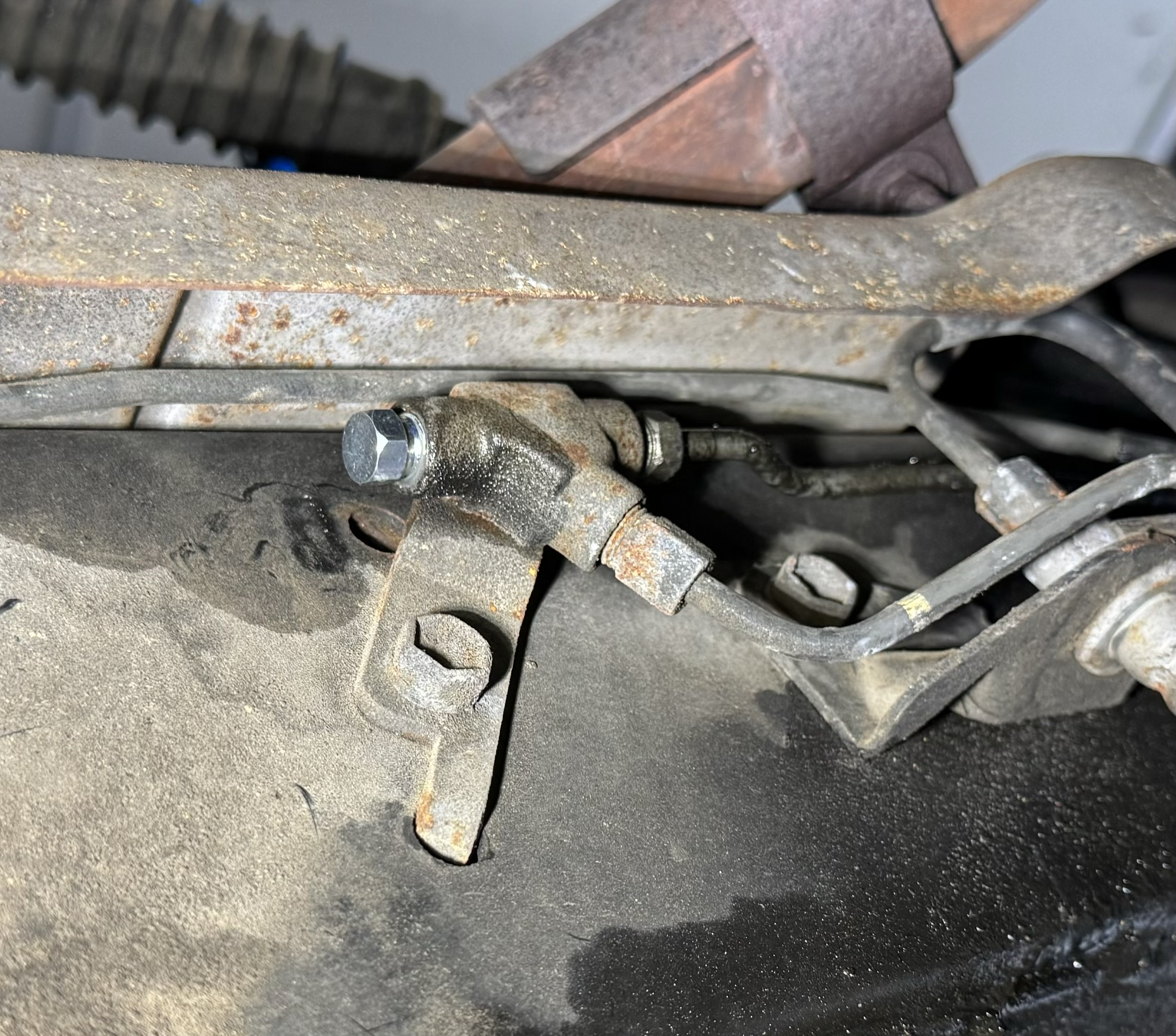

Great writeup! Thanks for all the info. I’m doing my LSPV delete now.

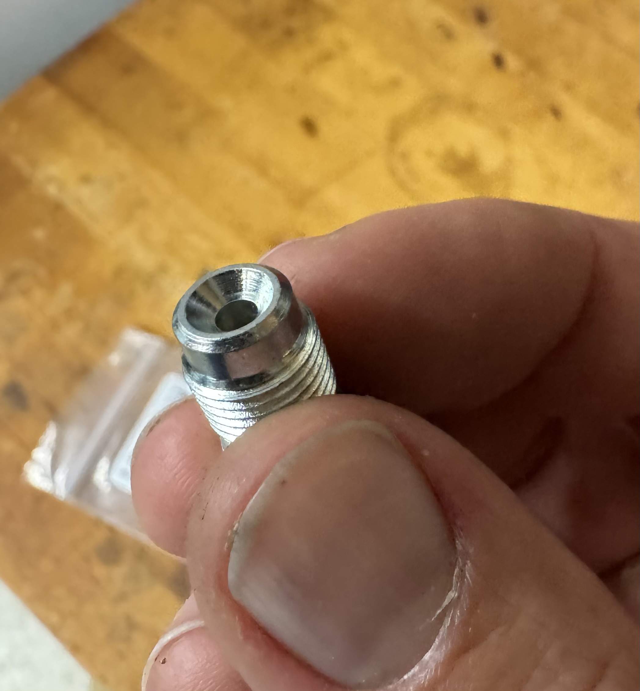

Just a heads up, technically you should use a brake line plug, not just the Dorman M10x1.0 hex plug. The Dorman hex will probably work fine, but is sealing on the threads. The brake plug has the proper flare seat for the double/inverted flare seal.
PN Belmetric BLP10X1.0DF brake line plug.
Brake Plug M10X1.0 Double / Bubble Flare High Pressure Suitable - https://belmetric.com/brake-plug-m10x1-0-double-bubble-flare-high-pressure-suitable/?sku=BLP10X1.0DF
