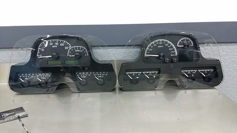

Over the weekend, I upgraded my Dakota Digital VHX dash to their new HDX series. Here is a shot of the two side by side-
They are very similar. The biggest difference is the large TFT screen on the new unit (right). The speedometer and tach layout are also slightly different. The hubs of the needles on the HDX are a spun aluminum anodized in black, which are extremely sharp looking in real life. The casing of the HDX is also aluminum, whereas the old unit is ABS plastic. Rather than two external remote mounted switches for programming and changing screens, the new unit has 2 capacitive-touch buttons built into the center of the display.

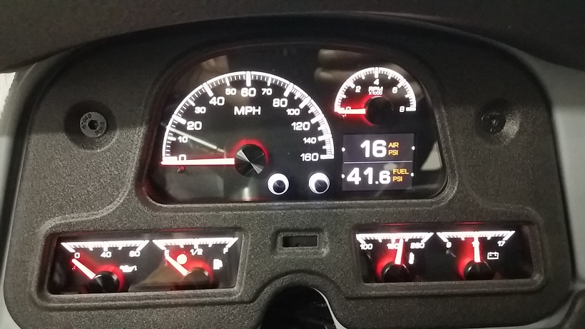

Here is an installed picture. Sorry, it's low quality and low light. I'll have some better ones within a day or two!

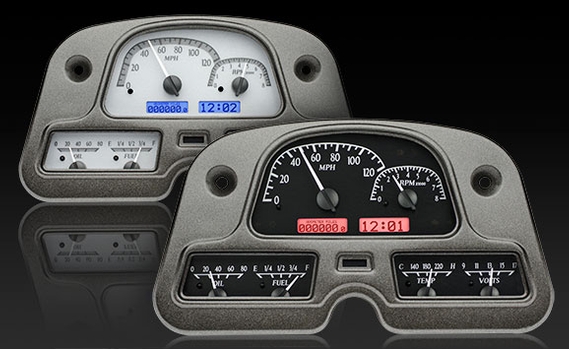

VHX

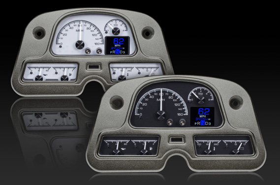

HDX
