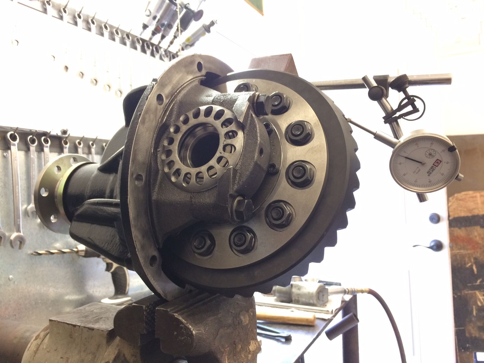

Front diff and locker is done.

I also worked on the front housing today. I am a little rusty on the mig, been well over a year since I have done much welding. Nice and beefy in the MC gusset kit, I will likely be using these again on other trucks. I just need to weld the diff skid on tomorrow and the front axle is ready for paint and final assembly.

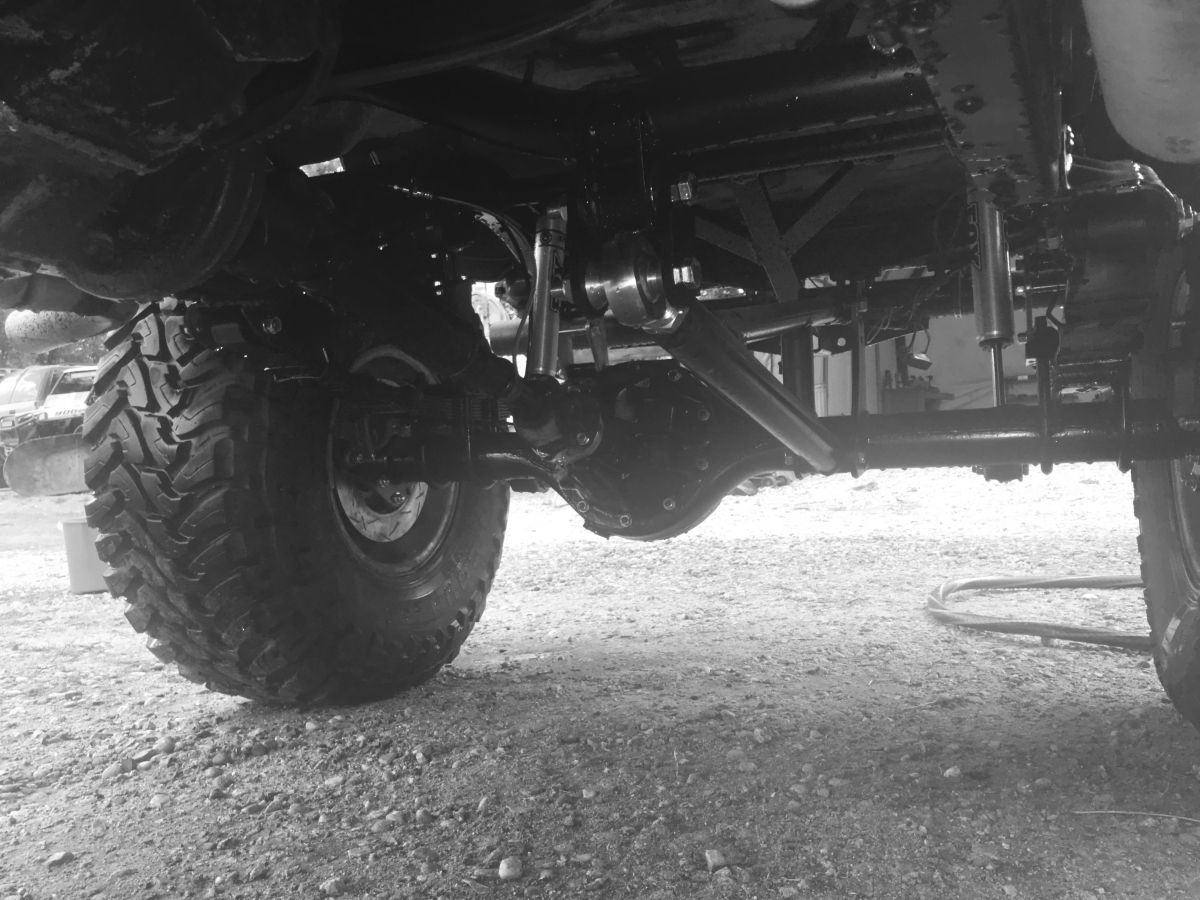

Rear axle is nearing completion.
Tie rod and drag link are built and the pitman arm reamed for FJ80 tres. All I got to do now is build mounts for the damper.

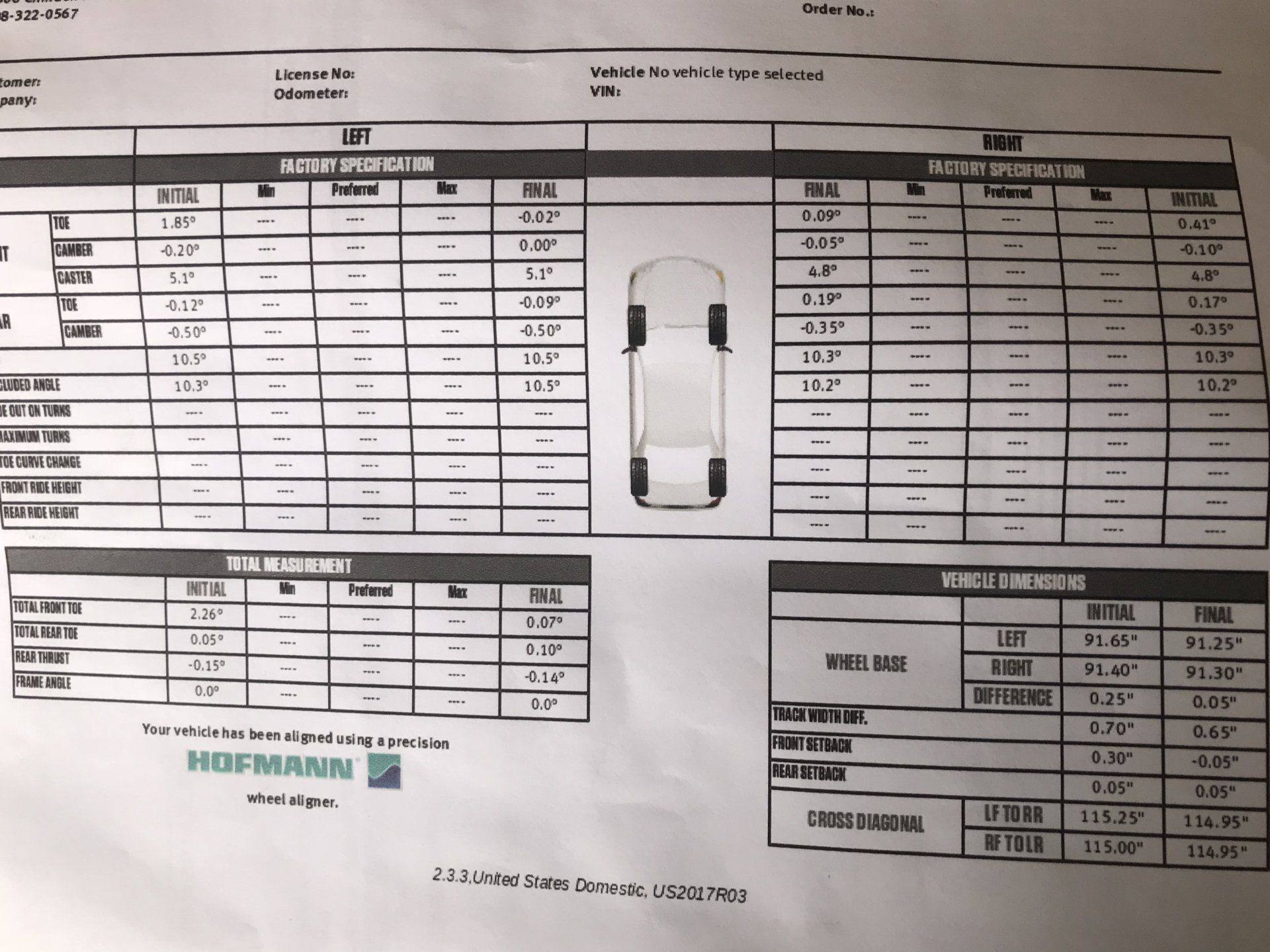

The Cruiser has been on its wheels for three or four weeks now though. Today I got it aligned. I am very happy with where caster has landed.
When I finally got the truck on a level concrete surface and was able to take some measurements the truck was a .5* of rake the wrong way. So still a bit higher in the front. I have got some OME rear leaves showing up today or tomorrow to fix this issue. Also, the FJ60 front brakes don’t like the supplied MAF disc conversion kit non-adjustable proportioning valve. It is like 60-40, rear to front right now. I am installing a Wilwood proportioning valve on the rear to dial it in. Other than this, it’s done.
The 40 drives nearly perfect. No bump steer, no wander, one finger on the wheel straight down the road. Zero vibes, stops very well too. Fan and shroud keep the 400 under 200 easily. Suspension works well, flexes good and not bad body roll on the road. Everything clears no probs. Locker works perfect.
