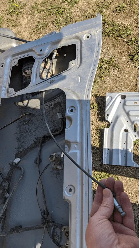

I used a 4" angle grinder with a cut off wheel. It cut like butter. Then used a flap wheel on the grinder to clean up the edges.
Make sure you know the cables are out of the way when you tuck them into the tailgate cavity. I ended up slicing through the passenger side cable. Whoops. Luckily it was easy to replace.
4” metal blade with my sawzall was pretty easy.
did you guys remove your tailgate in order to remove the steel spring rod?
Mine was rusty so I just cut the legs off in the gap between the tailgate and body and unbolted the rest of it. Came out in 3 pieces.

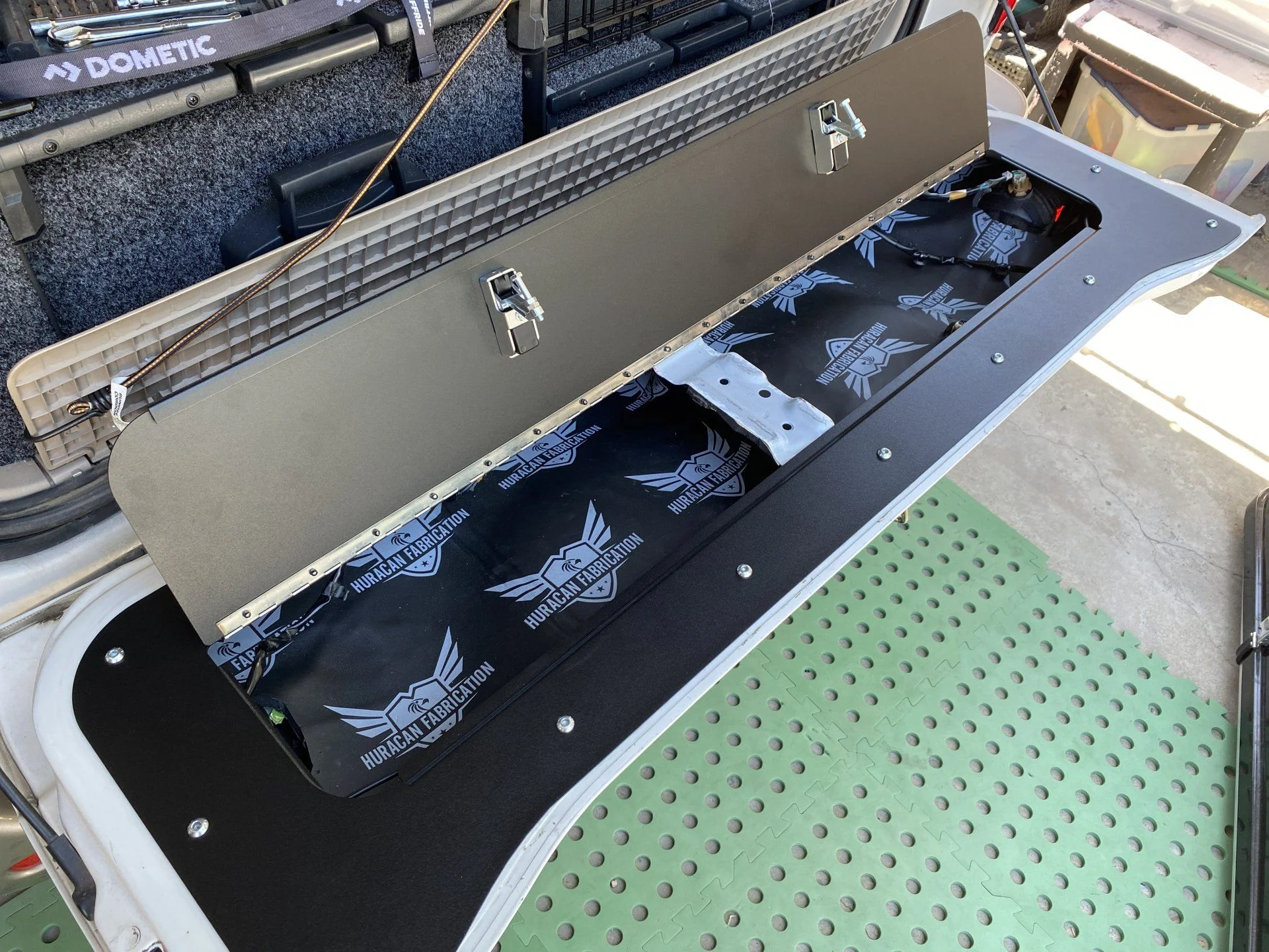

Just got mine installed. A little disappointed by the plastic tailgate gap thingy hitting the latches when you close the tailgate.
Did your kit not come with 3 adhesive backed discs? They go on the underside of the plastic tailgate thingy to keep it spaced out. It is silly we have to deal with that. The latch could have been moved up a 1/4 inch and it would be a non issue.

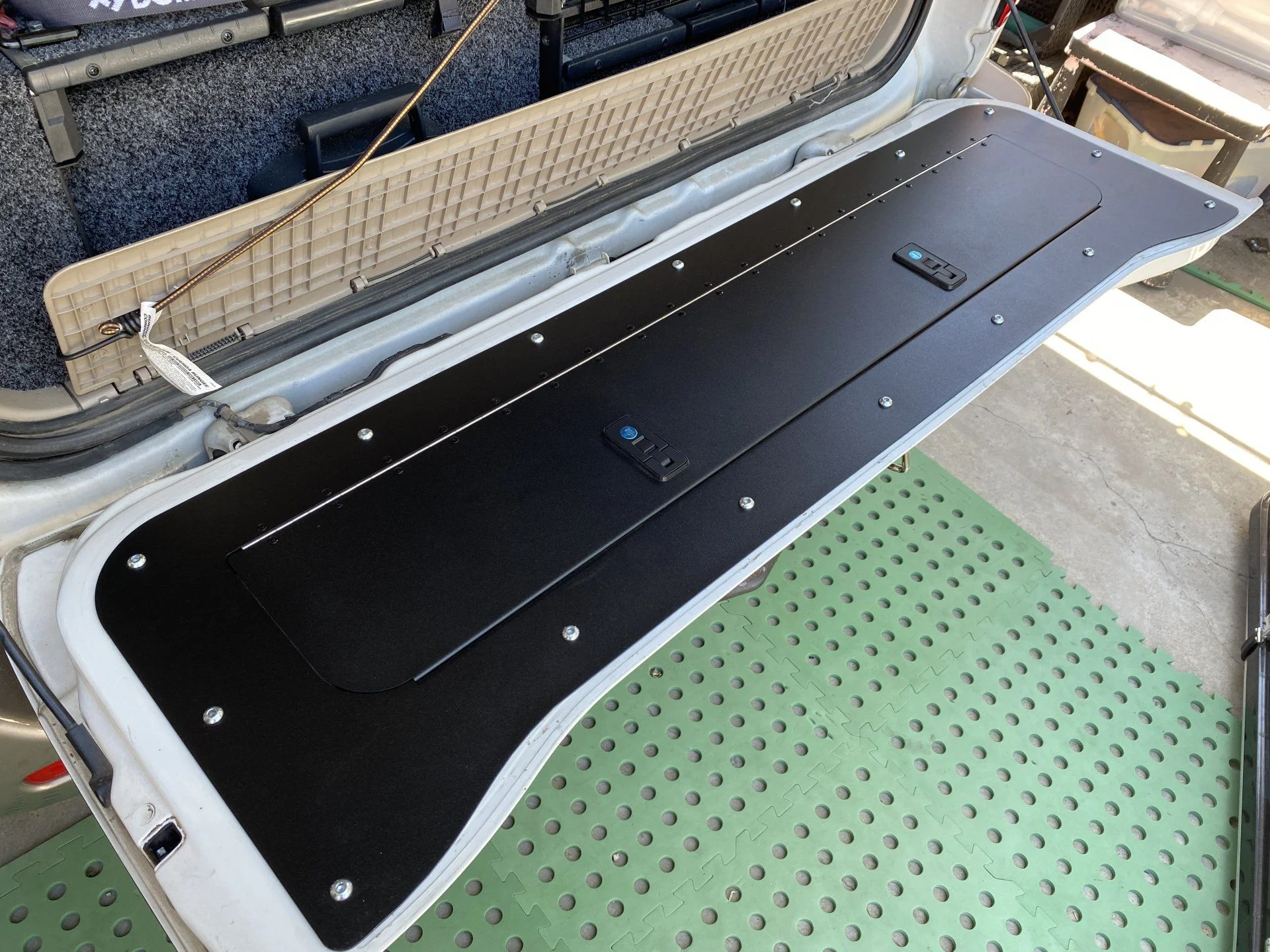

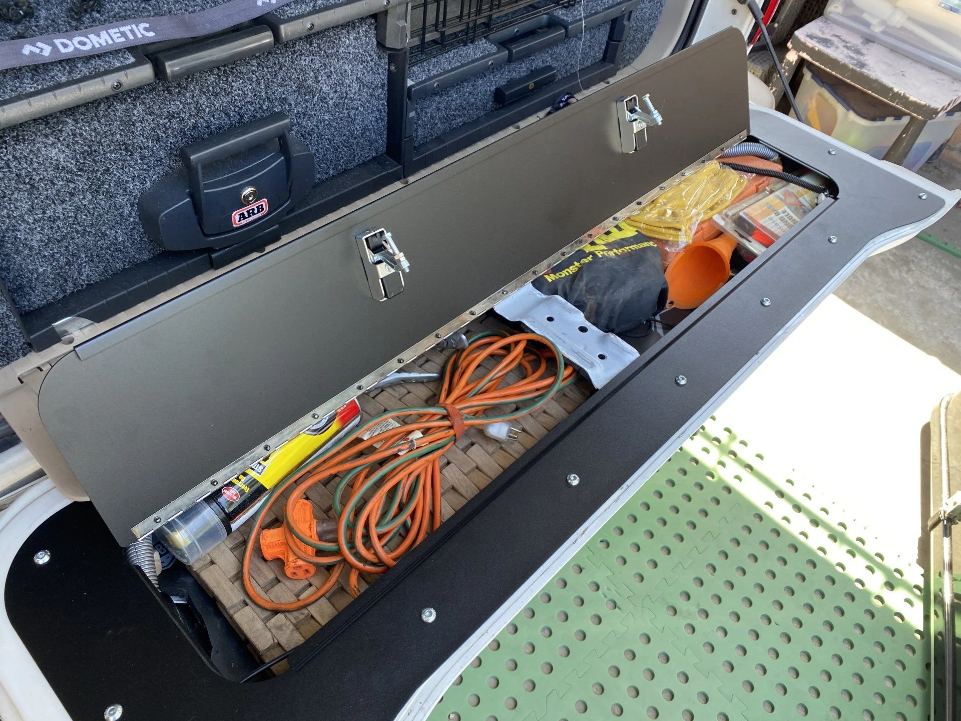

End product looks nice and it’s definitely useful space created. However it’s a bit pricey for what you get and the amount of work you have to put it not to mention the long wait for delivery.
