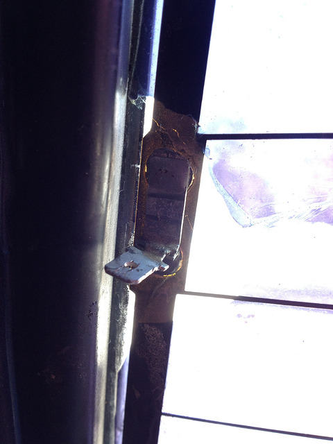

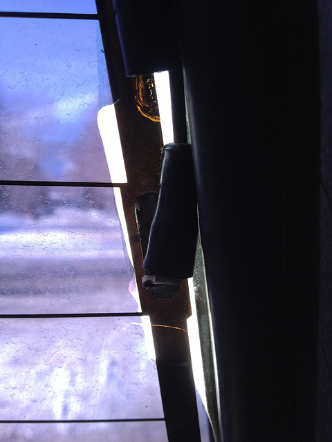

Thanks for the info guys... So I got out today and tested the connections again. Will everything off I do get continuity from both ends, on the second dial setting (200v~) I got a consistent reading of 25.3. Since it was actually bright enough out (I normally have mondays off) I was able to inspect the glass and found what could be my issues..
This one you can obviously see the slice that goes across the entire line, Believe this is part of the issue.
Untitled by renofizz, on Flickr
This one is a bit harder to tell but it seems like the conductive material did not really go around the contacts and was thinking that it may not be making full contact.
I got another batch of the contact cement and did those areas so we will see how that work out.
Well no dice, my fix does not seem to have worked so either the contact cement compound is not enough to truly bridge those gaps or I have a break elsewhere that is not allowing the lines to work. This is a bummer as it was working last year prior to the negative side popping off the window.
I have been doing some reading on people trying to repair this and really the concensus is that if it is only the connector popping off the glass then it is a fairly straight forward fix, if not then it is much easier (and less frustrating) to just replace the glass as a whole.
That is what this Permatex stuff I ordered is supposed to be like. None of the places in town had it in stock so the nearest O'Reilly ordered it for me. They will have today so I can hopefully give it a shot this weekend.
