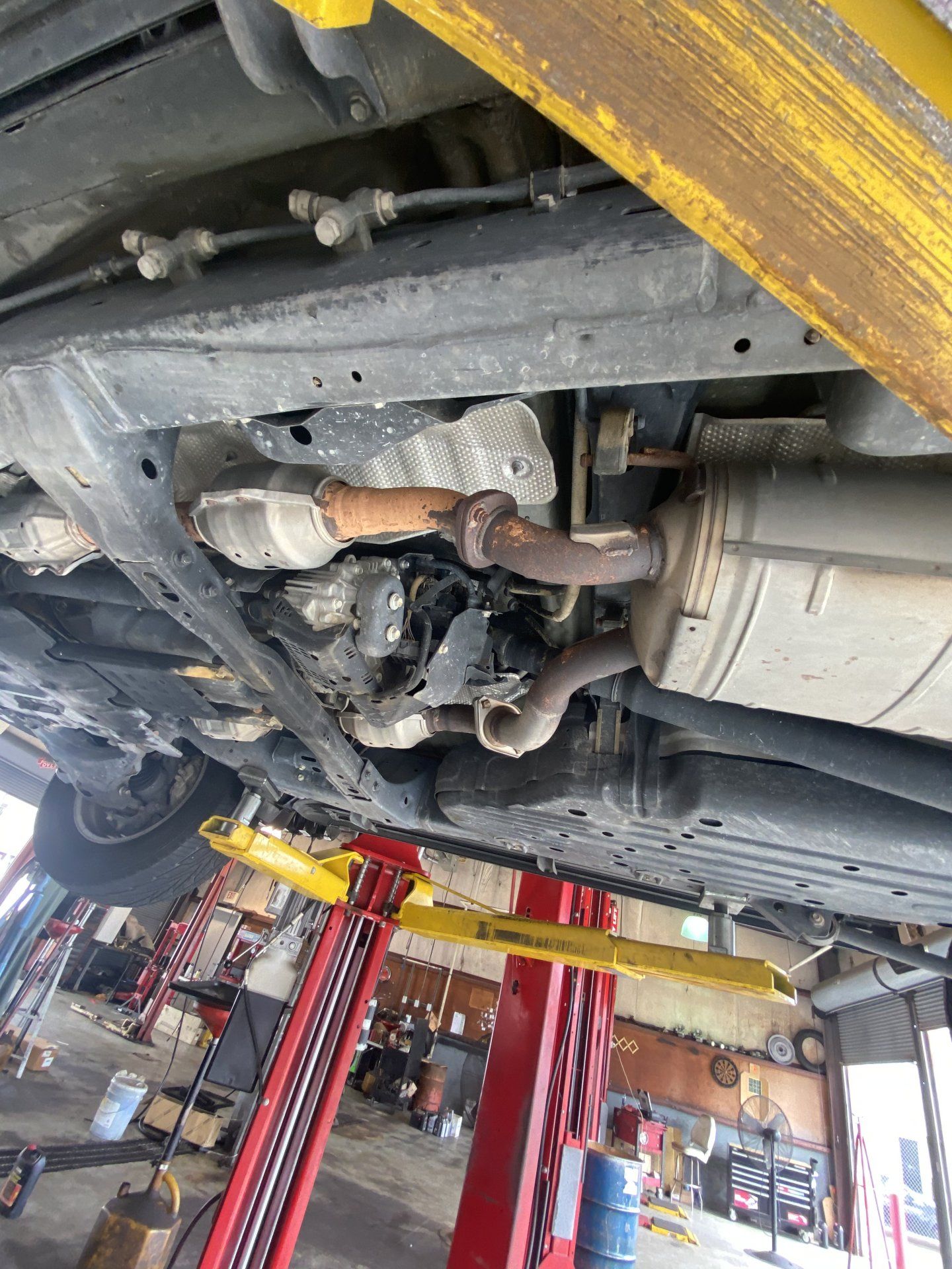

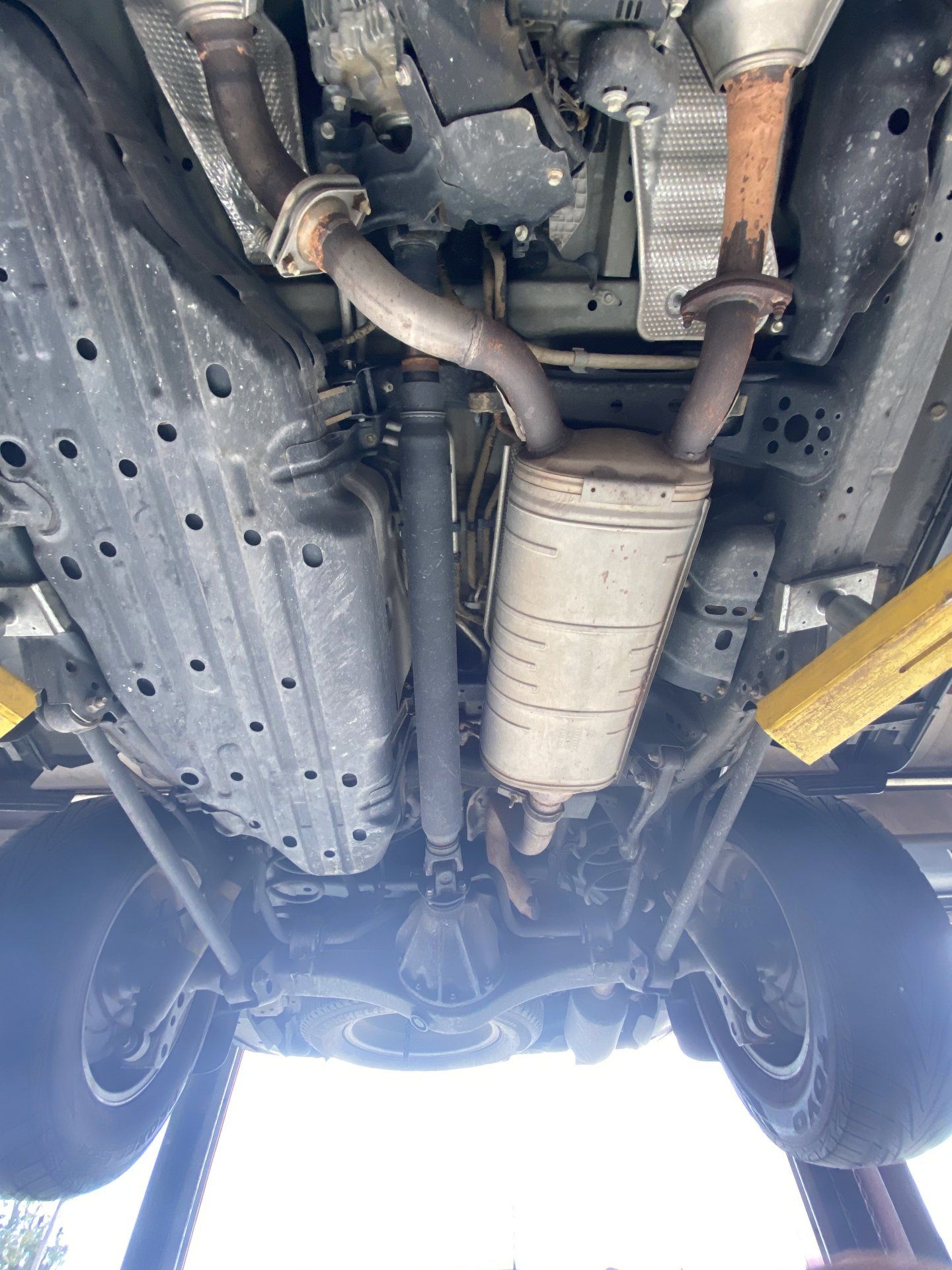

What is the reddish substance/residue on what I gather is the exhaust system of this vehicle? The rest of the undercarriage looks free of corrosion?
I don’t know. Was looking at buying it and asked for pictures of the undercarriage. Looks rust-free on the frame; I just don’t know what this is. It looks like corrosion. It just doesn’t seem to make sense though. I’d have thought it’d be everywhere of it was rust.
I would view it rust based on temps encountered in exhaust setting as well as the base material. A stainless exhaust system from manifold to termination would add cost to an already pricey vehicle.

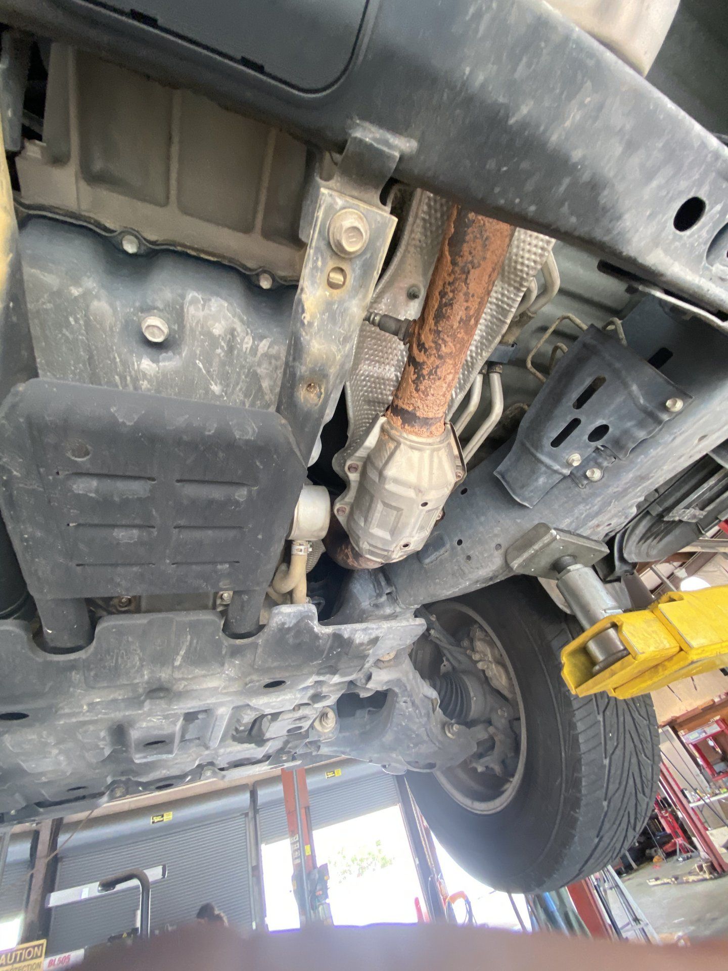

Looks like baked on dirt/clay. If you zoom in on the 3rd photo it looks to be on the cat shield too. I would not be concerned .
Land cruisers in the US come standard with fully stainless exhaust systems.
Cooked mud.
Looks exactly like the bottom of my 80 after baking on the NC/SC red mud
I concur. Baked on mud.
Others here would probably agree I’m a stickler for corrosion on vehicles and to me this one looks great.
When I got it home I might try to take that mud off with a stiff wire brush but honestly that’s a matter of OCD satisfaction over it actually needing to happen.
This undercarriage is damn clean my friend.
