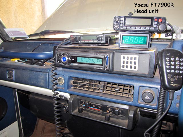

The last (hopefully last) unit I bought for my oz patrol that sees a lot of rough roads/tracks/vibration/dust has ONLY a radio FM/AM and USB/SD/Ipod inputs. No cassette or CD. My whole plan was to ditch the mechanical junk. These days a 16g USB stick and/or an Ipod will hold more music than a whole raft of CD's and take little to no room. No vibration issues or dust issues. Problem solved!
I then have a separate 5W UHF (oz CB) rig for comms with mates that are 'primitive' and then I have a 2m/UHF Ham radio for the more 'sophisticated' mates :) The Ham rig picks up weatherband, though that's somewhat useless in Oz :)
