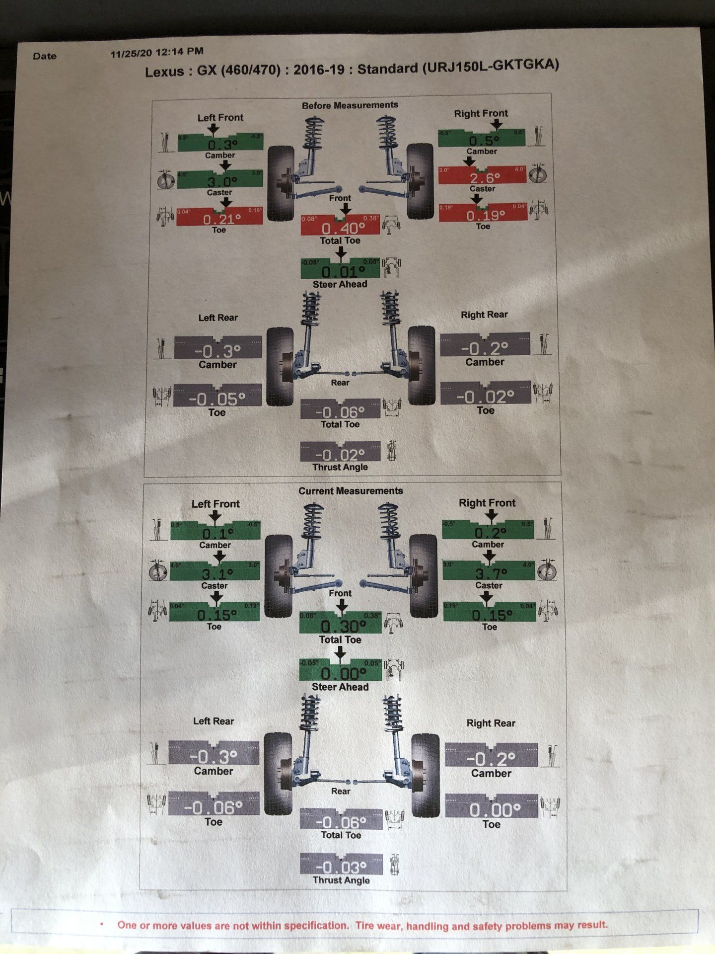

here’s my alignment with the Dobinsons UCA’s. Not adjustable, but less parts to go wrong or make noise.

We went +2 degrees on the UCA ball joint, the rest gets set from the LCA cams. (Not sure what the Dobinsons or other non-adjustable kits use but I'm assuming +1 degrees?) DS ended up at ~3.8 deg and PS was about 4.2 or 4.3. It's actually a bit higher than spec, though that was set with the front end jacked up about 1/2" in order to simulate the effect of the vehicle setup when I have my trailer attached (which is >50% of my mileage) since I can't entirely re-create that setup at his shop. I'm not sure what caster would read when unloaded, but it should be close. The alignment shop I used does nothing but lifted and heavy truck and race car alignments.
No problem. I tend to ramble so entirely possible I wasn't clear :)
That sounds good, really nice caster numbers.
The Dobinsons UCA's are set with 3 degrees of added caster. I think most fixed UCA's do the same, so that they cover 2-3" of lift height properly. It tends to be 1 degree of caster lost with each inch lifted from what I've seen, so adding 2-3* works well.
