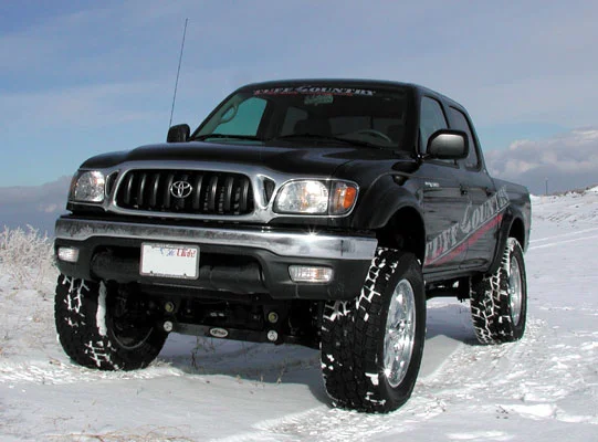

Yeah thought i might have to drop the diff!
Ive seen toyota and nissan with bolt on kits to drop the diff. giving a 4 inch lift.
Has anybody seen this on a prado?????
I think you've seen these lift kits, (not what I meant)
Ok now i know what your on about! So maybe 3 inch lift with that diff drop is the way to go?
and that pic with the toyota lift is what i was hoping to chase up for my prado!
Has it ever been done for prado Tepui????
I have not seen these kits on Prados before, but the Prado front suspension is almost identical to the Tacoma, I would imagine it has been done, but it is not common (these lifts are popular on "street queens", or vehicles that are mostly lifted for looks, not performance).
I would recommend a suspension upgrade (Old Man Emu, king Suspension, Sonoran Steel, etc) instead of a bracket lift.
